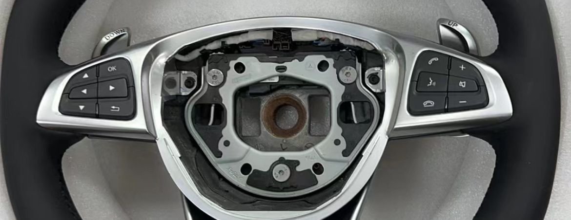

For this swap it is important that you purchase a wheel with these style buttons otherwise the swap wont work.

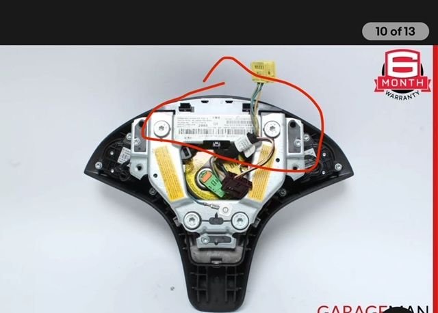

1: remove the center airbag plate and set aside
2: remove the trim with the buttons and set aside
3: remove black box and disconnect all wires going to the top
4: remove your oem airbag (your steering wheel control module is located on the airbag) you will need to remove the backing plate to access the board

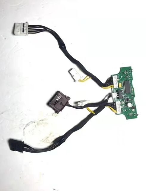

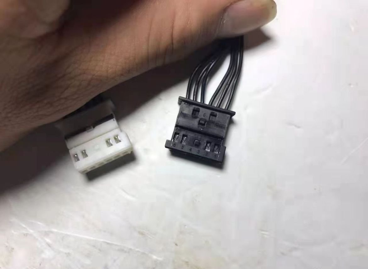

5: take a look at the wires going to your oem buttons, there will be a connector with 6 wires on both sides. the w205 wheel also has a connector but it is different (however it too has a plug with 6 connection locations)
you will need to transfer the connections from your oem button harness to the new steering wheel connections.
depin the w205 buttons leaving just the plug. one by one depin your oem harness following each connection 1-6 and install in the w205 plug. do this for both sides
your setup should look like the image above ^

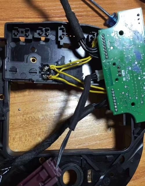

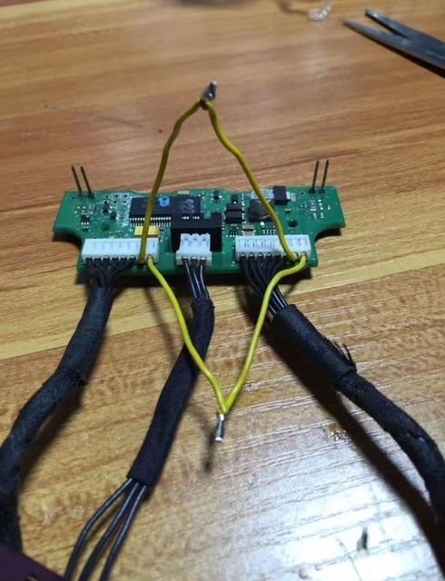

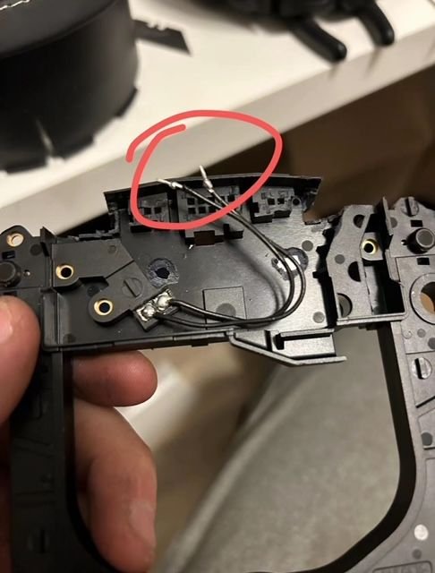

6: once this is complete depin the yellow connectors and solder them together as pictured

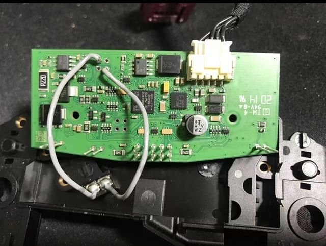

7:next take your w205 and solder your yellow wires to the points in the picture below
8: install your w204 chip and your freshly made harness and install in the w205 black housing (some modification maybe required, many people like to break away the sides, thats up to you)
9: install the w205 back cover
10: plug in your buttons, paddles and reinstall all other components and put the wheel in your car. connect the new airbag and youre all done

1: important that you have this style wheel buttons or this swap wont work

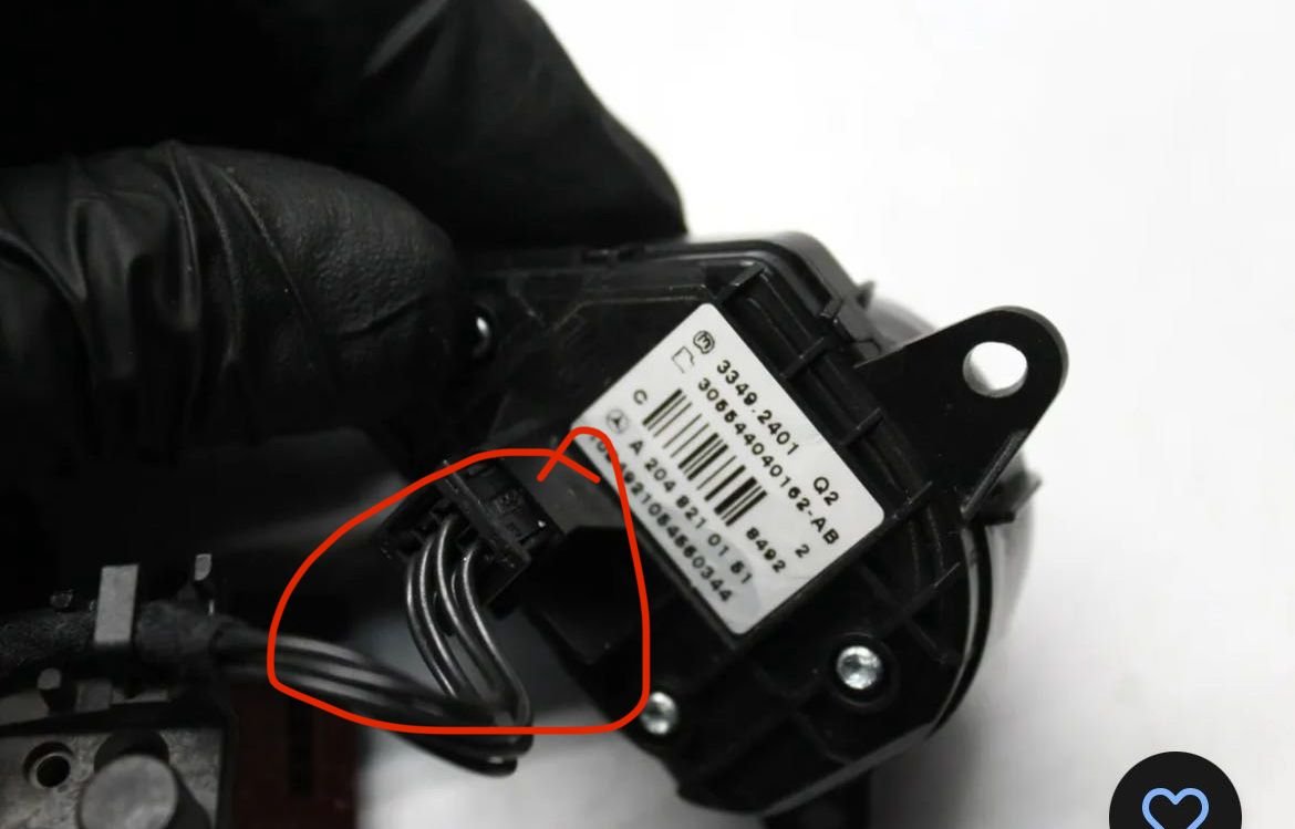

4: solder 2 wires to the points shown in the picture below (on the black box from the w205 wheel)
note: i soldered on pin connections on these wires to make the install easier but this isnt necessary
5: take your oem w204 chip. in the top left corner you will may have a set of 4 prongs, not all do, if its not there there will be 4 extra holes. you will need to insert/solder your new connections into these areas. please follow picture below for placement
note: if you have the prongs you can do one of 2 things.
1. use pliers and lightly grab and twist the prong to remove from the board and solder to your new wire (both wires)
2. solder your new wire directly to the prong already in the chip
this will take care of your horn.
