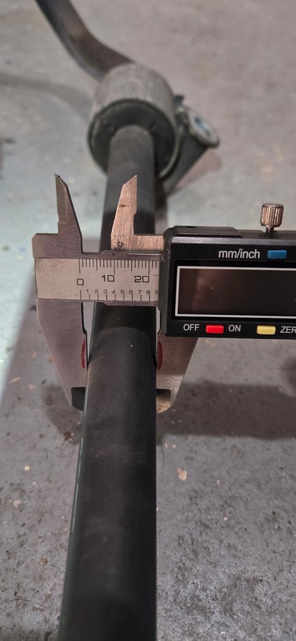

OE Swaybar Upgrade
The optional 22mm rear swaybar for W212, W213, and W218 will bolt right up to a W204.
This is the optional, thicker rear bar for sport suspension packages on W212/213 E-Class, and W218 CLS63S.
It is 2mm larger in diameter than the (20mm) W204 bar, which should amount to a 46% increase in stiffness, all else being equal. Mine measured closer to 23mm, but I'm using a cheap caliper.
I installed this bar on my '09 C63 sedan today. It fits perfectly and made a noticeable improvement on my short test drive.
There is also an optional 31mm tubular front sway bar which should work, but I'm leaving my front bar stock, as I'm looking to reduce understeer. I haven't really driven the car yet, so I'll report back if it feels like it would benefit from the stiffer front bar in addition to this one.
Part Number: 2123261765

Do you have the info on the front bar?

Part number for the front bar: 218-323-04-65-64
It's a 31mm tubular bar. Should be quite a bit stiffer. They're ~$150 used on ebay.

Is that front part number correct? Seems two digits too long.
2183230465 comes up with an E63 front sway bar.

Can you change the rear sway bar without having to drop the diff?

Yep, the longer part number is for the larger bar. The part number you posted is for the regular bar.
The rear axle carrier (diff, subframe, and everything attached to it) needs to come down 4-5 inches to get the bars in and out, but it doesn't have to be completely removed.
I did it with a floor jack. Not a difficult job at all. The subframe bolts are TTY and should be replaced, so order some new ones.
