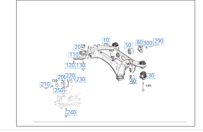

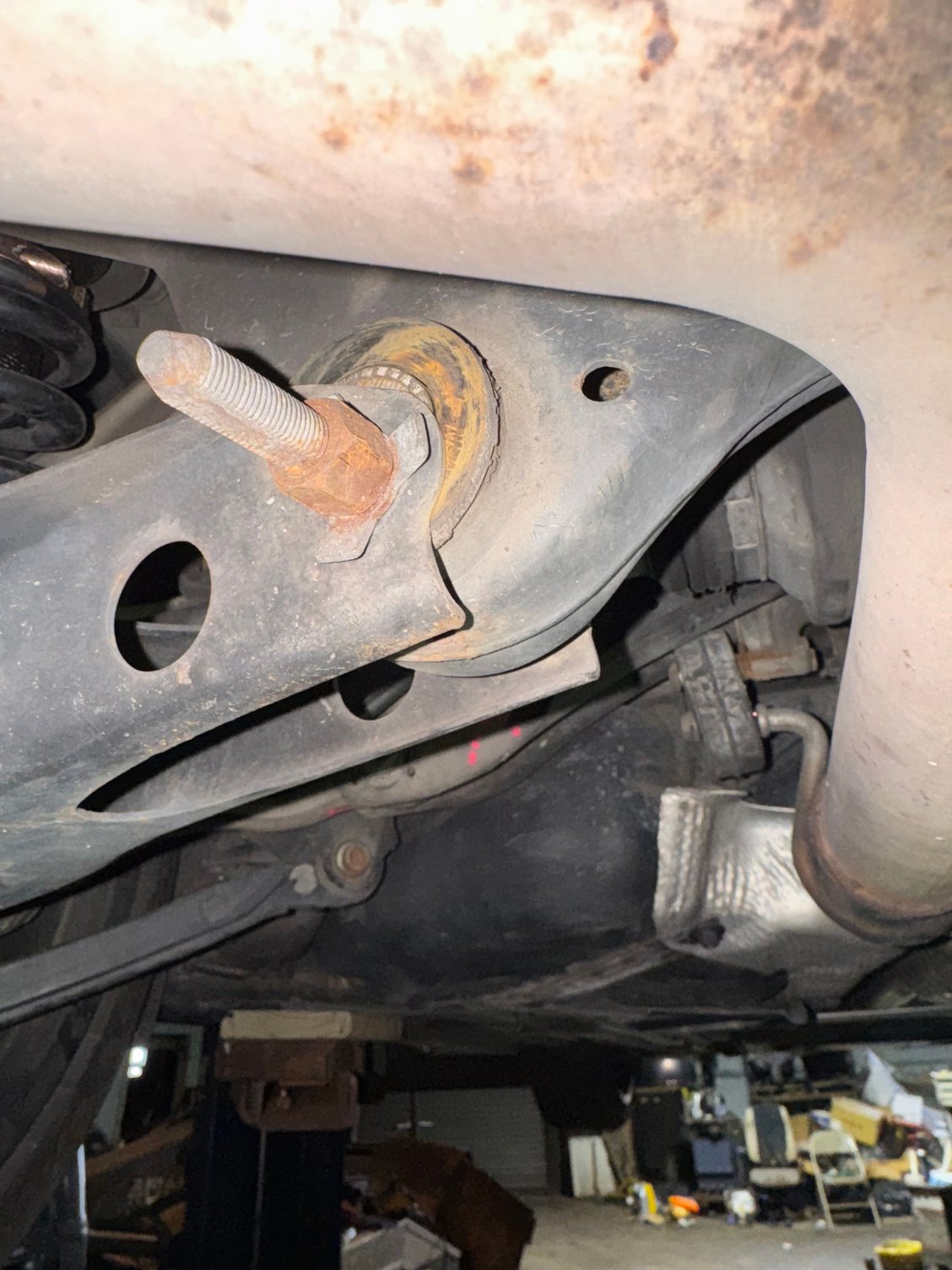

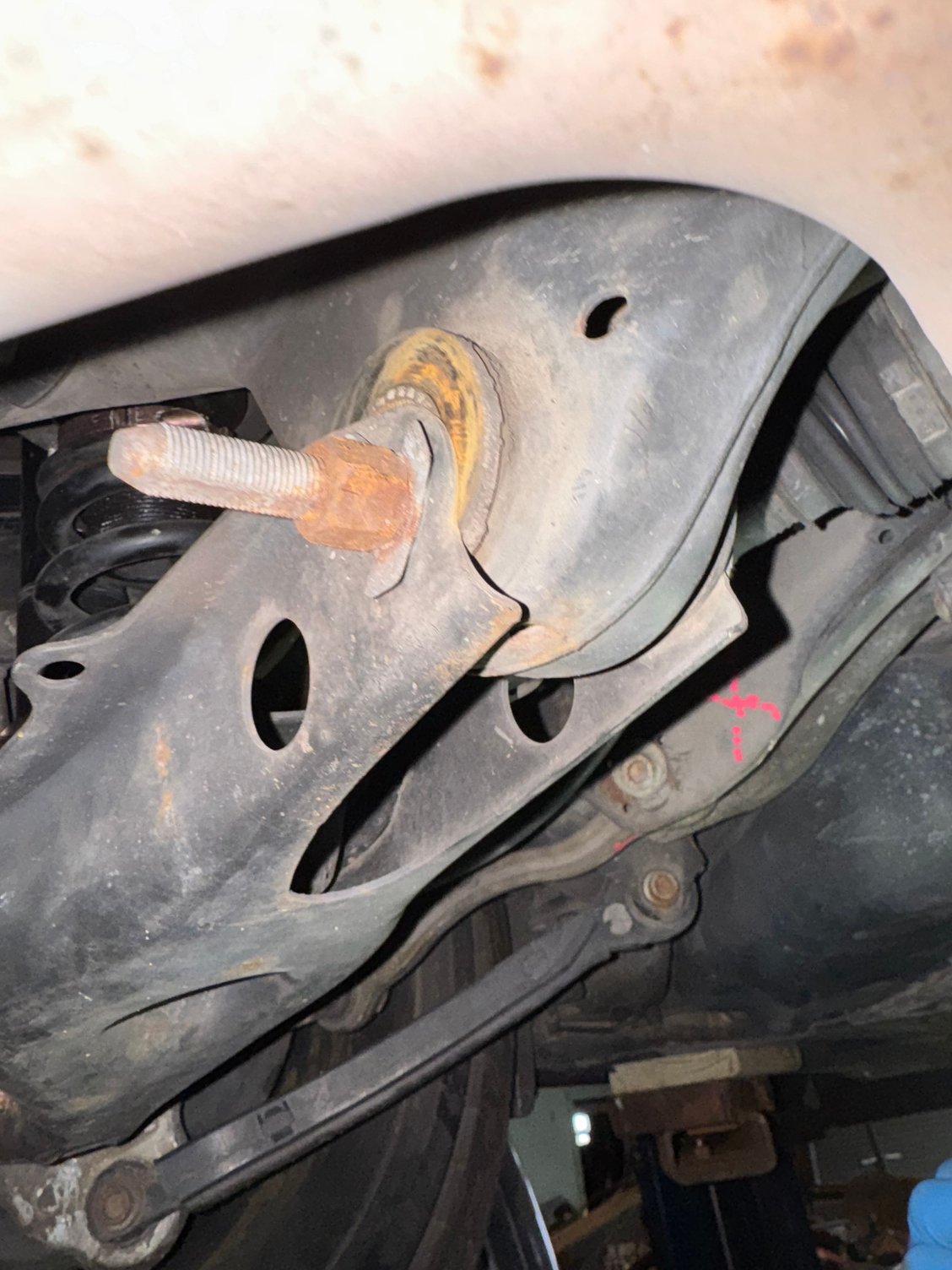

Hi , recently I’ve been hearing a lot of clunking coming from the rear of the car . At first I thought it would be my Coilovers later finding out that my bushing is completely busted . Would anyone please help me and provide me with the part number , thank you !

That is a KMAC camber adjustment bushing which is likely why it failed as the stock ones pretty much never fail even 18 years and 200k miles later.

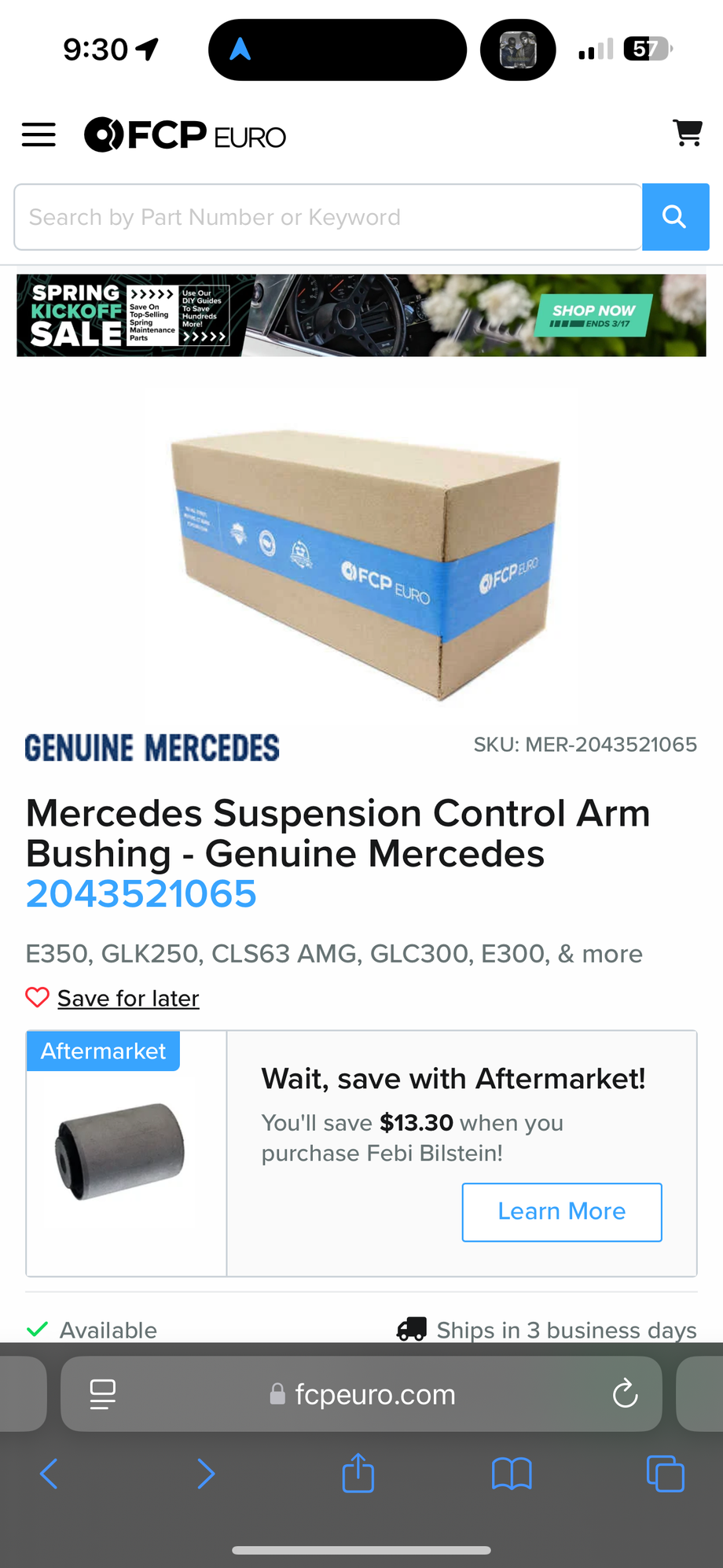

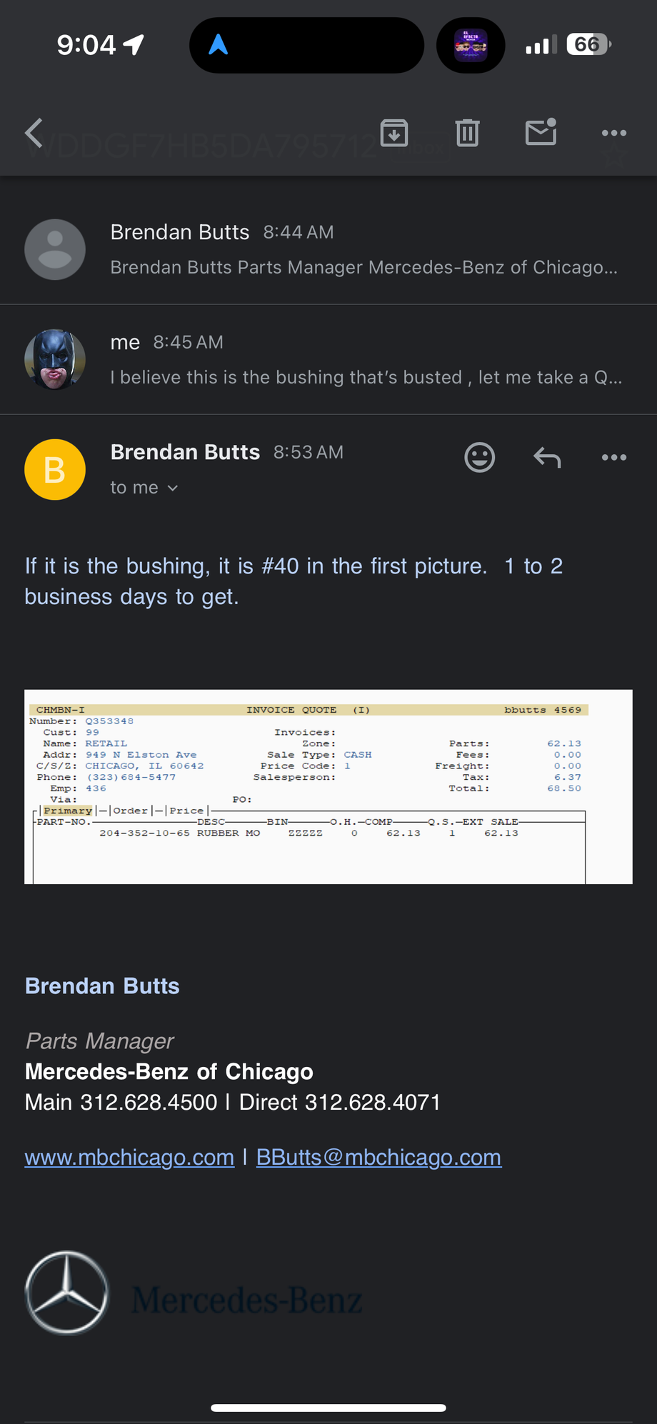

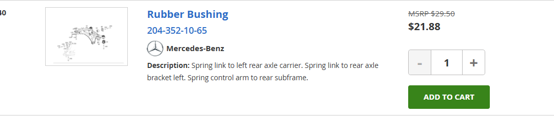

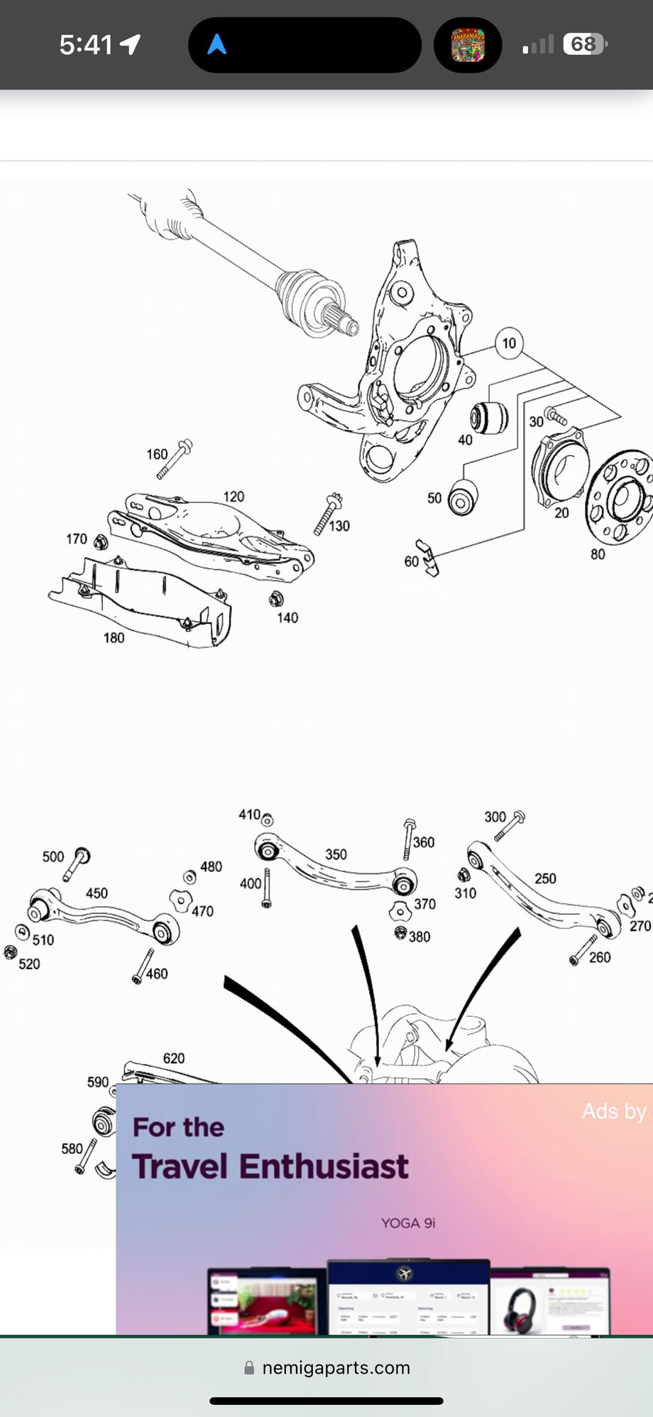

Part 040
I ended up ordering 040 after calling my local Mercedes Dealership and they told me it’s this one

based on the picture it's the wrong part. it's the opposite side of the lower control arm. It's part 40 on the rear subframe. looks like somehow you ended up with the correct pn though 204-352-10-65 . It's wild that dealer is charging 100% markup over list price. lol.

Like @roadtalontsi said, that is a K-MAC bushing. Here's the link to it: https://k-mac-camber-kits.com/produc...incl-amg-w204/
Alternatively, I have a complete set of K-MAC rear bushings (same as the ones I linked) and would sell it to you if you're interested. Just lmk and we can work out a deal.

Background - Ex factory there is no Camber adjustment to allow to spread load more evenly to resolve costly, premature excess edge tire wear.
K-MAC bushes therefore allow precise offset adjustment. Being offset is essential (as specified on instruction sheet) the 2 bush bolts are fully tightened / clamped.
K-MAC bushes are virtual lifetime usage. Failure occurred back at time of initial wheel alignment with this bolt not being fully clamped. Allowing movement which ultimately destroyed the bush.
Replacement bush is easily fitted. Remove bolt - hand insert new bush “and fully torque bolt” to correct spec.
