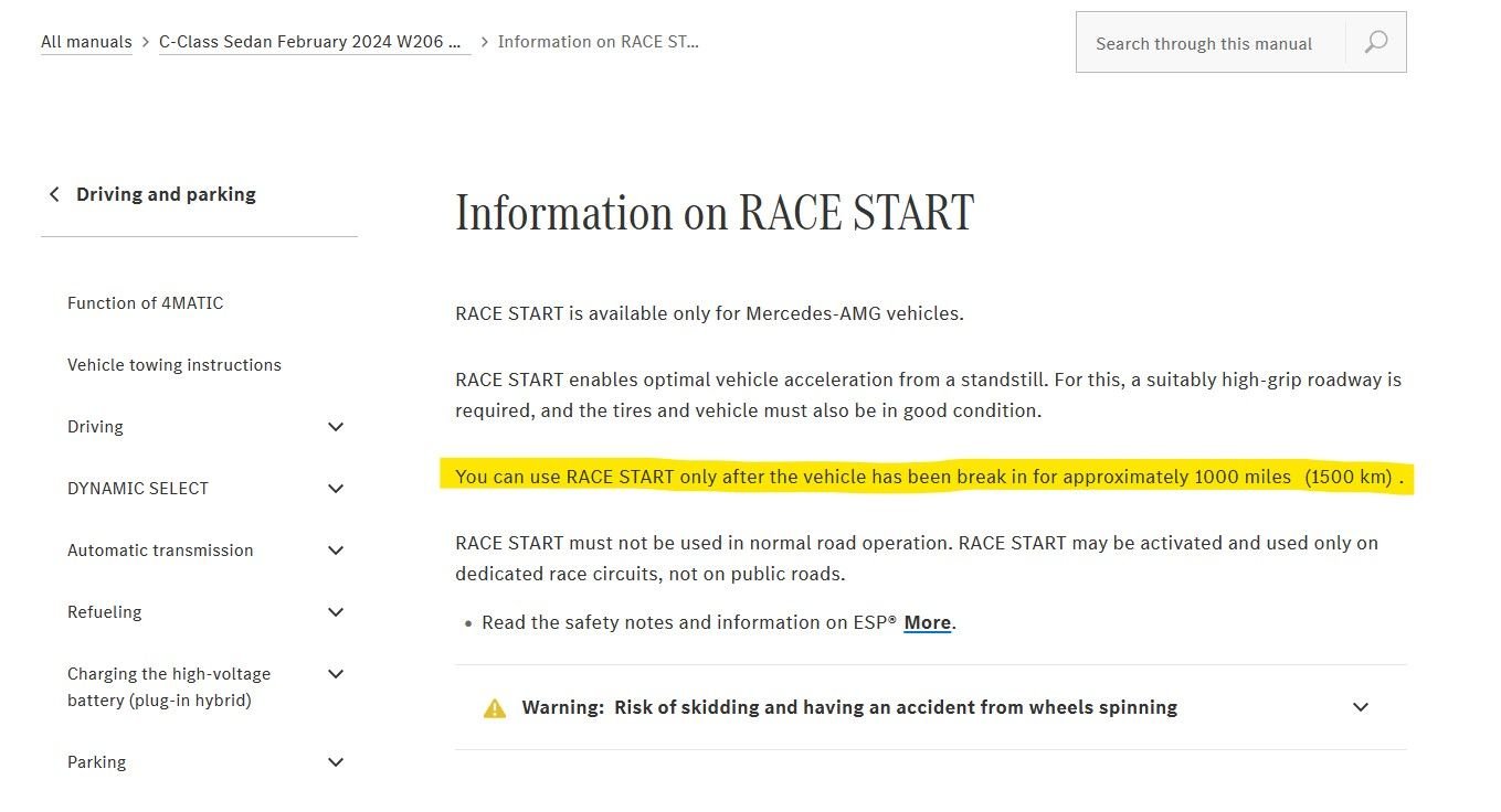

Hi everyone,
I recently took delivery of my 2024 C63S E Performance and have put about 200 miles on it so far. I'm encountering an issue with the Race Start function. Despite meeting all the typical conditions for use, every time I try to engage Race Start, I receive an error message stating, "Race Start not possible, see owner's manual" or something similar.
Here's what I've ensured before attempting to engage Race Start:
  • Vehicle is in Race Mode
  • Battery is approximately 75% charged
  • Engine and transmission temperatures are up
  • Vehicle is on a flat surface
  • Transmission is set to "D"
  • Firmly depress the brake and then rapidly floor the gas
I have reviewed the user manual, and it seems like I am following all of the correct steps. The manual does not specifically state that a break-in period is required for Race Start. However, it does mention elsewhere a 1000-mile break-in period. Could this be impacting the Race Start function?
Has anyone else experienced this? Any suggestions on what might be going wrong or how to fix it?
Thanks in advance for your help!

I believe Race Start will only become available once you have passed the break in period of 1500 miles. Try again once you are passed that.

totally normal until break in is over.

I'm amazed the OP didn't realize that he needed to get past his break-in period...."amazed" is by far the nicest word I can think of. Whether the manual makes an explicit declaration or not, common sense has to play a part. Not trying to be a jerk, but C'mon man!!!

+1...200 miles and wants to do RACE START! It's right freaking there in the owner's manual, too.

You have to be past the break in period of 1000 miles for this to work.
