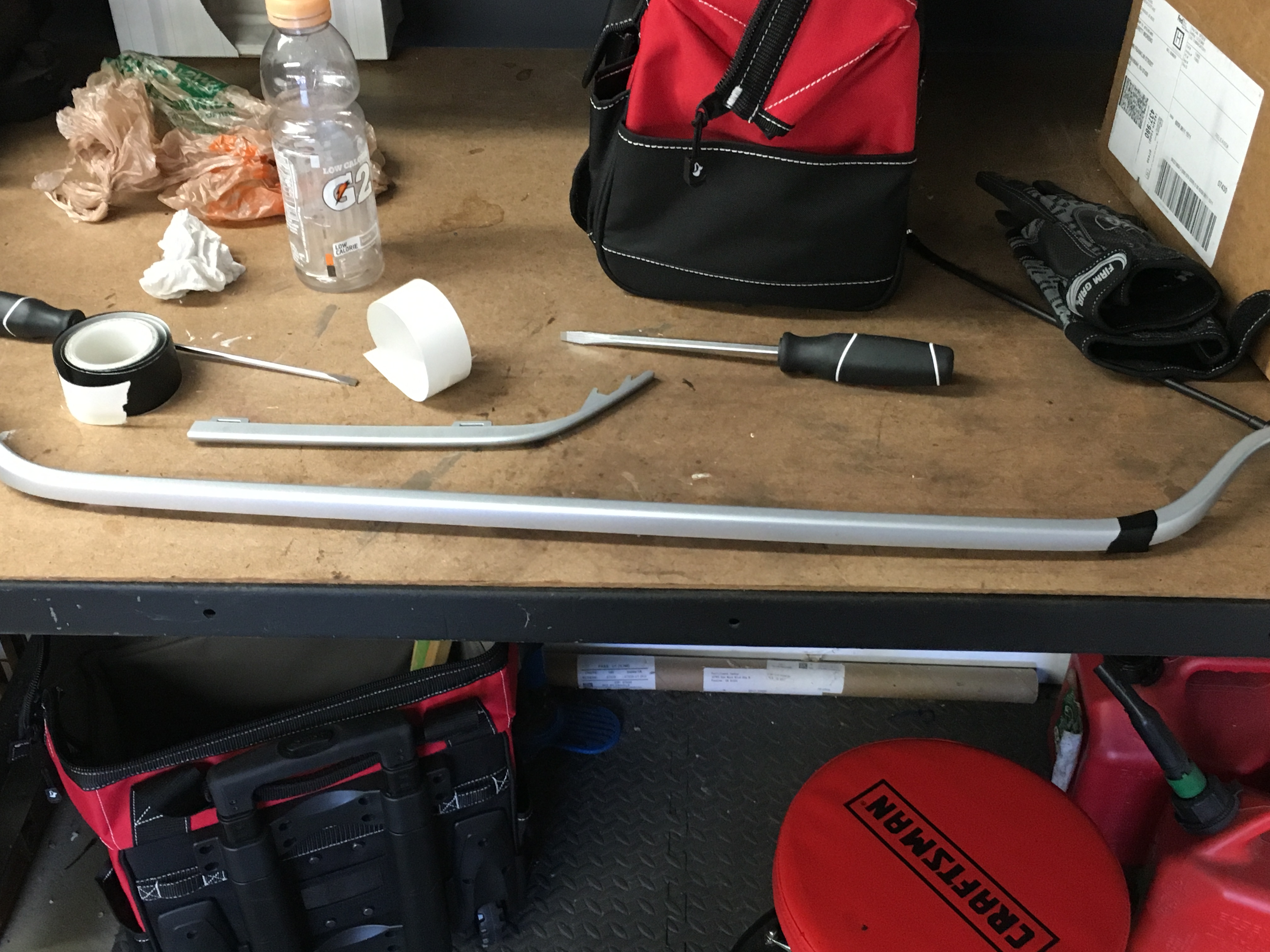

Here is where I can help you all. The three tail pieces (yes 3 in total) snap in and out of the bumper. It isn't easy but they do snap out. The front 3 pieces are impossible to remove. We tried and it cannot be done. HOWEVER, what we found out is that the piece that these 3 pieces snap into CAN be removed. SO, if you plan on wrapping or painting the front 3 trim pieces, just unsnap the long piece they snap into first and remove the trim from behind after the long piece is removed. This long piece extends the entire length of the bumper so, remove it first and then unsnap the 3 trim pieces from behind. Snapping everything back in is simple.
Finally, the side trim pieces above the rockers.. This was interesting. There are only clips on both ends of the rocker. The entire piece is held on by double stick foam tape. Unsnap both ends and gently pry it away from the body. The tape may stay on the car, may remain on the part or may break away in pieces but, it rubs off.

BGM130: It is a real BIT-CH to get those pieces out. The front lip had a piece that pulled out and all 3 trim pieces could then be removed from the back. I don't know if the rear has a similar piece but, we managed to get all 3 of the rear pieces out, with some effort.
Look at the way the clips push into the bumper on the parts you removed and you will find the center piece pops in and out the same way and with the same clips.

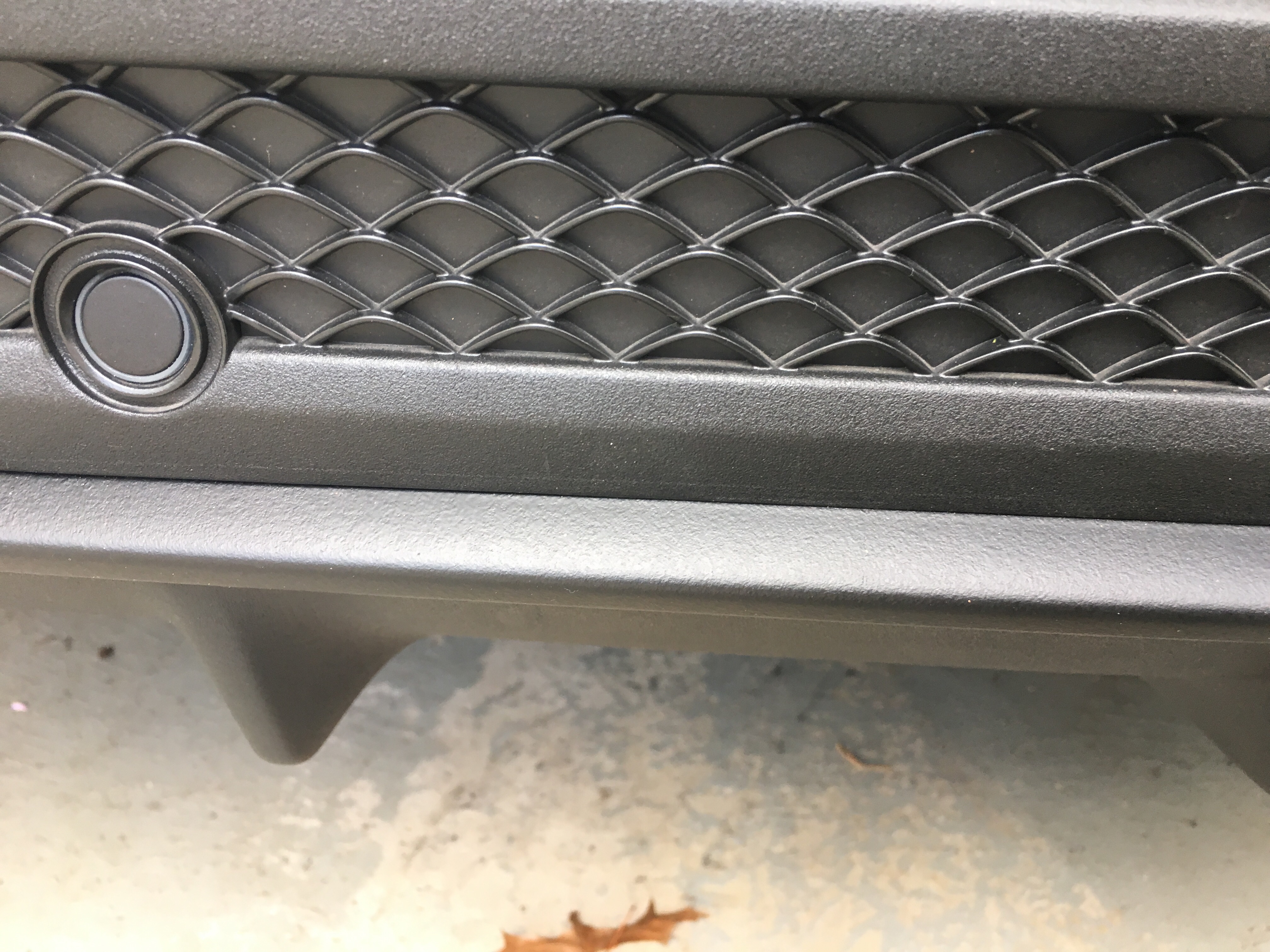

Here are some pics of what the body of the car looks like with the parts removed. It is really nothing more than an oval hole but, when I get to the painted parts, I will take some pictures of what the clips look like. They are in there solid and deep. Even with the whole bumper removed it wouldn't be able to be pushed out by hand. They must make some sort of tool from MB to get it out. My paint shop just used brute force and flat head screwdrivers..

Painted parts. See the tabs to figure out how they go in and come out:
