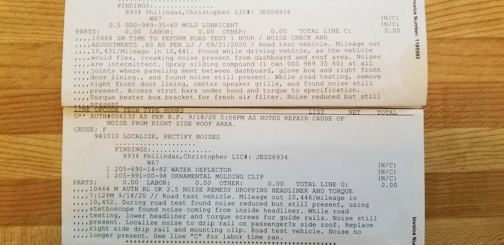

In Sept. 2020 had a rattle from what I believed was coming from the overhead rear view mirror box or pano roof. Sounds can be tricky to locate. My car 2019 C63s coupe had 10,400 miles at the time.
Photo below show what steps were done by MB Service.
