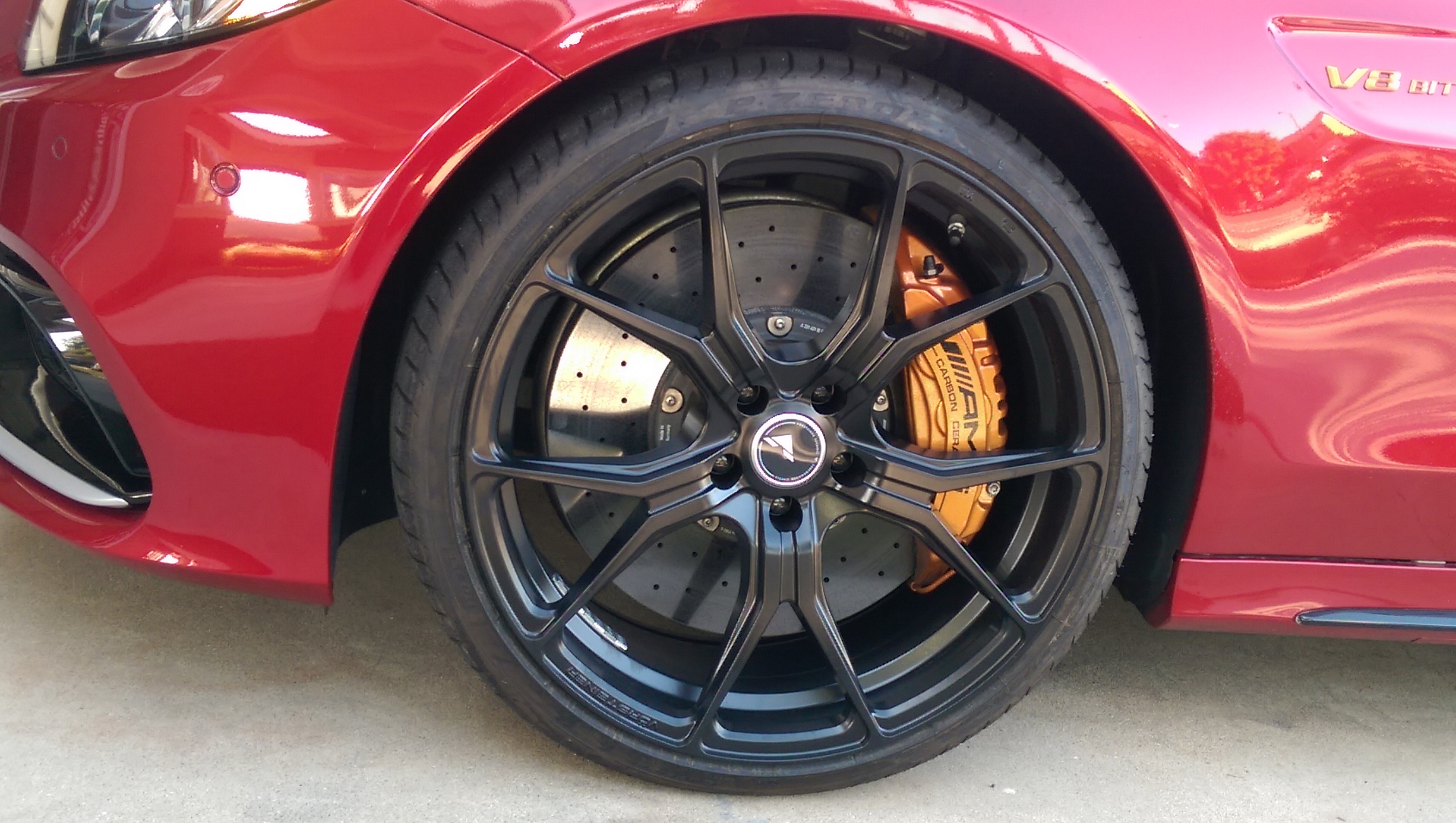

If you have CCB only a few companies offer a wheel without SPACERS to fit over the Brake Calibers.
I have Vorsteiners and they fit great.
Attached Thumbnails Getting new rims - help me pick tire-2016-07-13-17.46.59.jpg
