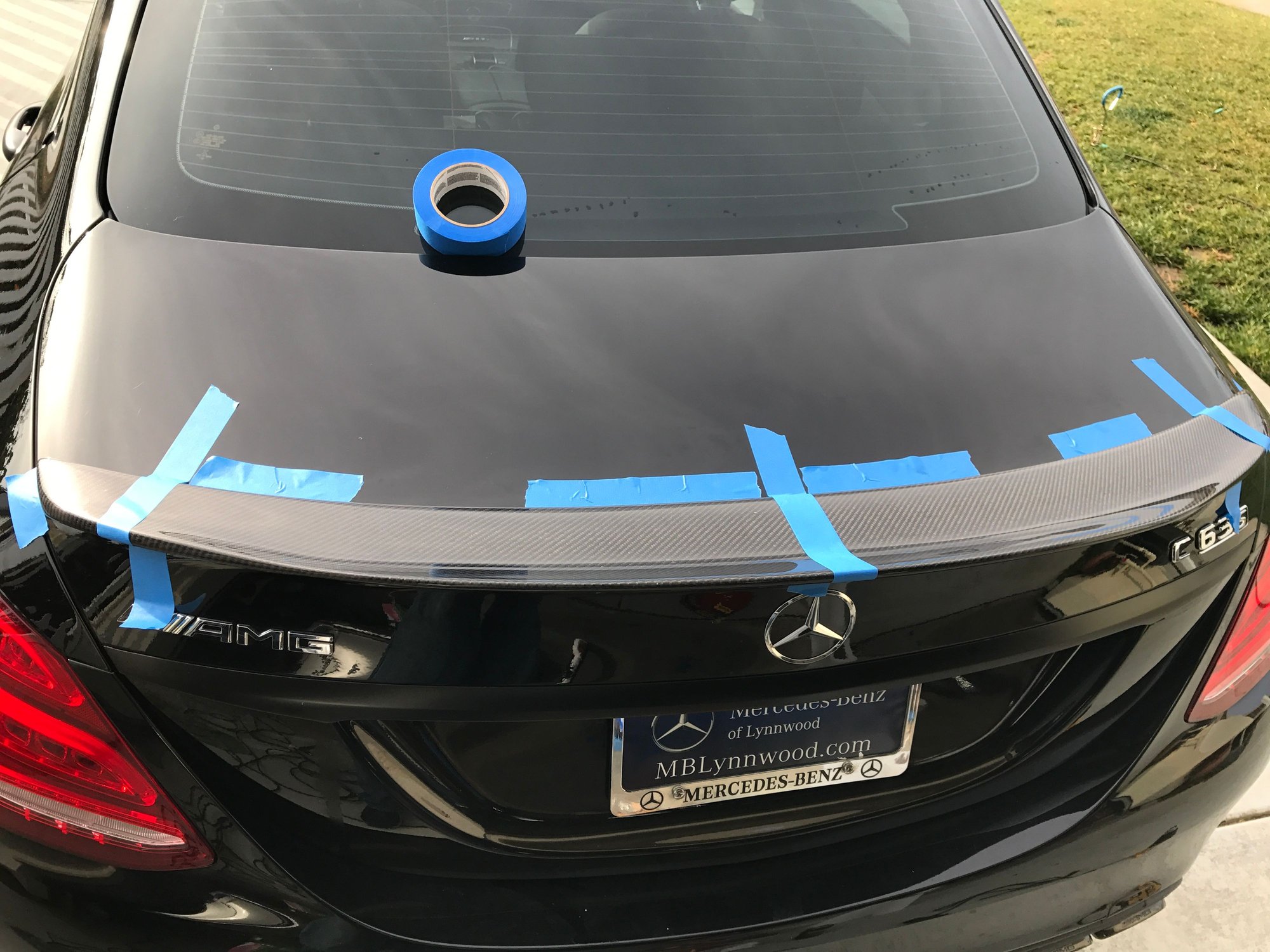

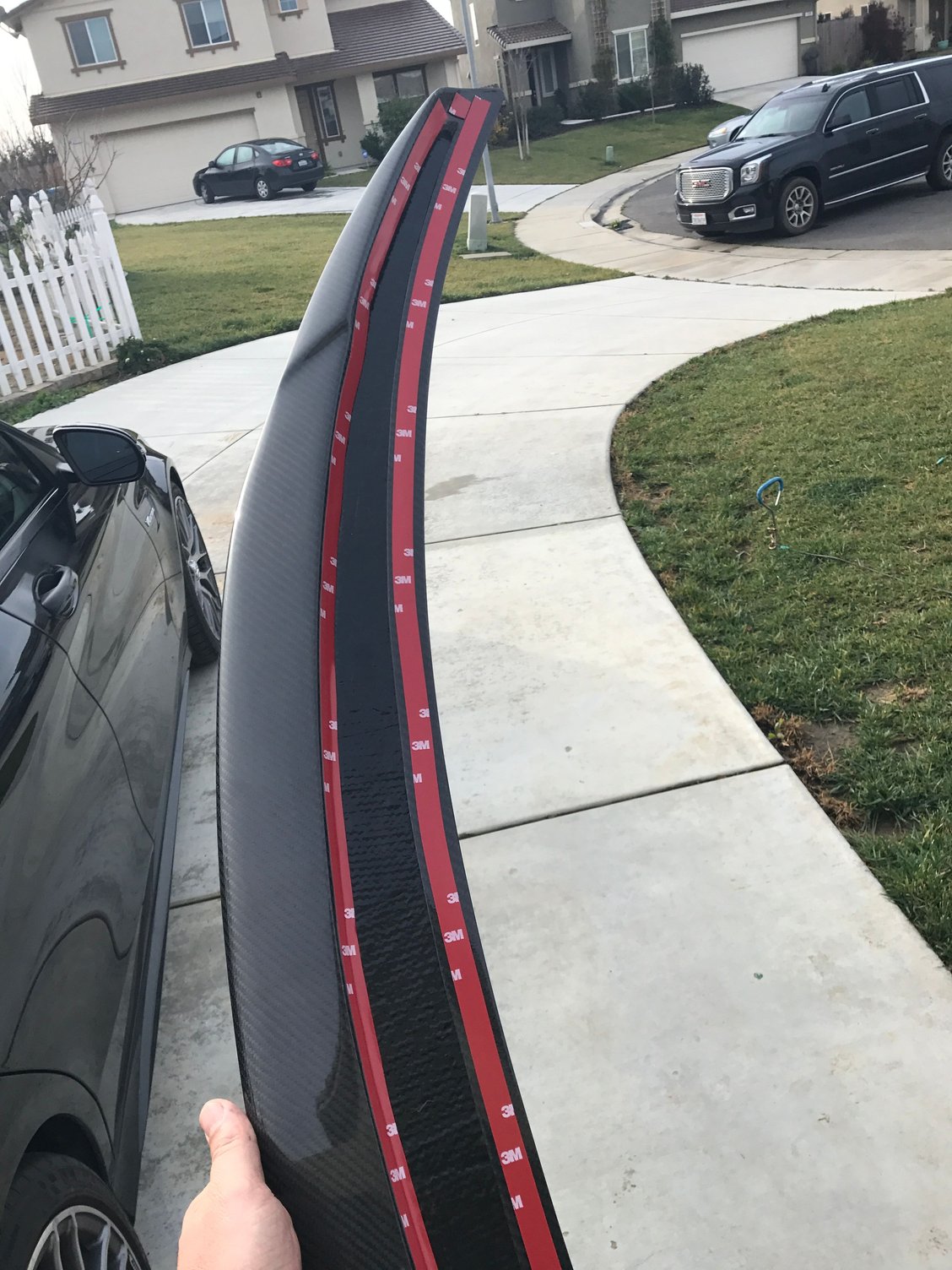

Installing was easy. Put 3M tape on, then positioned it just right and marked the position with tape. Then I exposed the tape and applied a little heat. Pressed the spoiler on the trunk and applied some more heat to ends and pressure to it to stick down all the way. Came out pretty nice IMO.

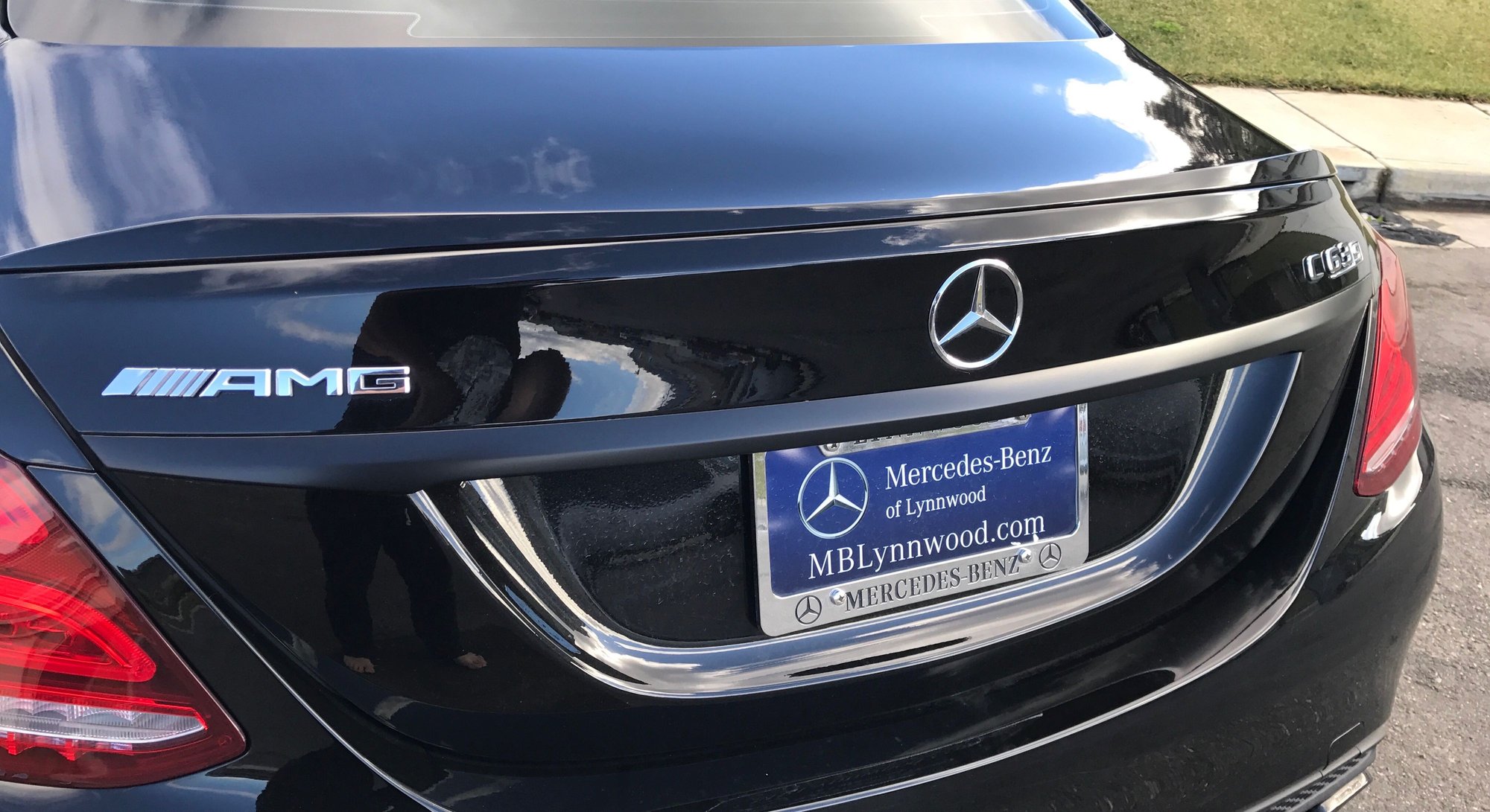

OEM

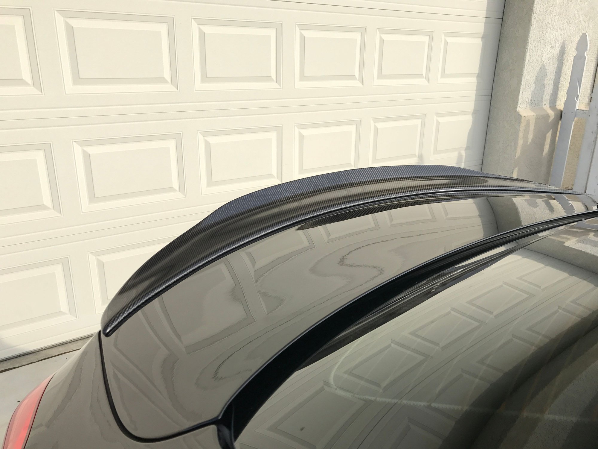

OEM Removed
Placement of 3M tape
Lined up

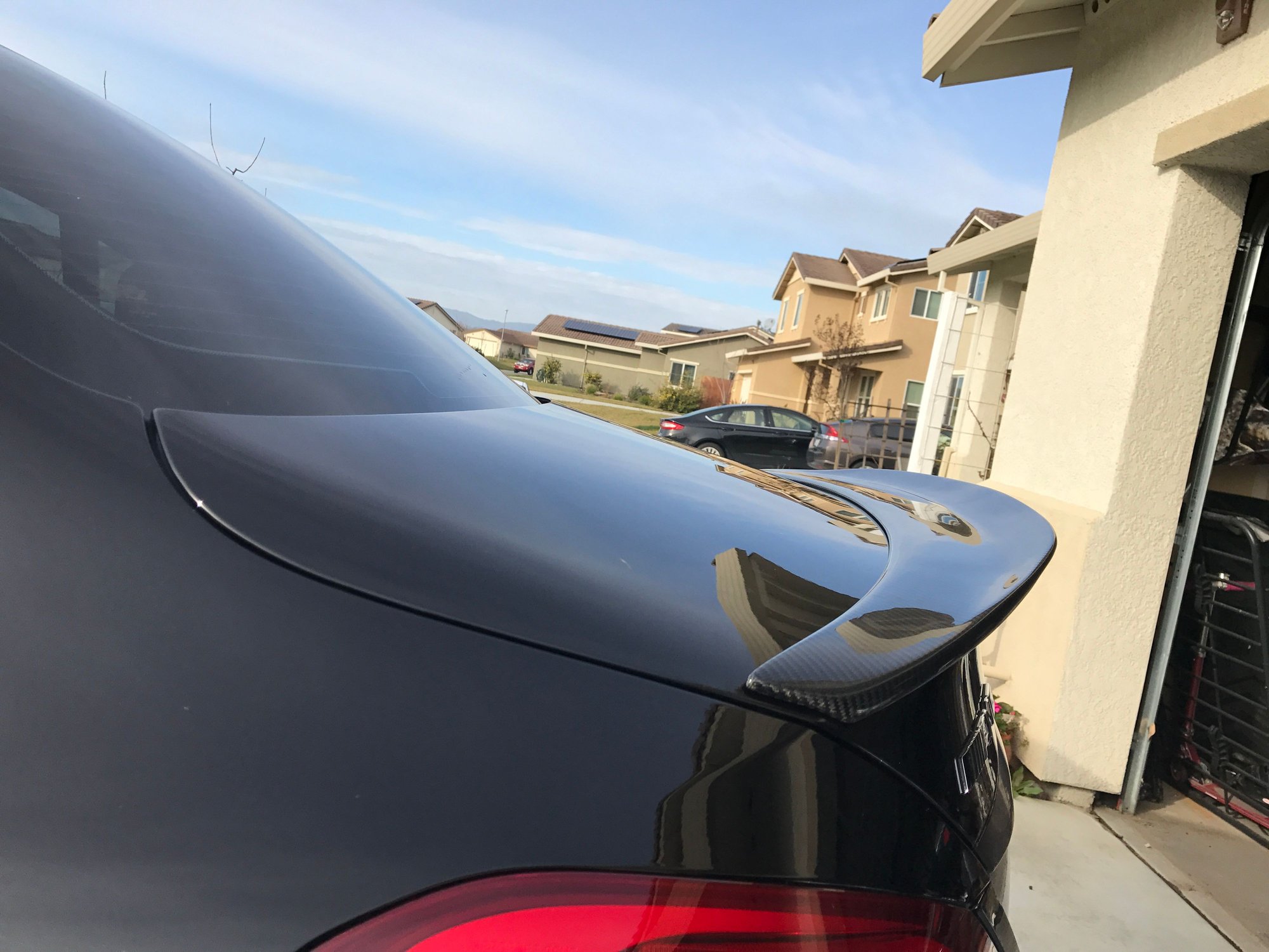

Finished!
