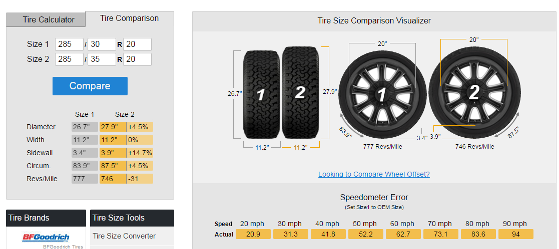

is it possible to use 285/35 tires on rear wheels instead of 285/30?
has someone tested it or maybe has information about it?
Will it fit? Is there enough space for those tires?

That's a lot of sidewall compared to stock.

JMO - it fills the wheel well 12mm more all around but most critical the top...which I think is okay if you are not lowered (lowering has the same effect here). But why would you instead getting the right size?

Mainly looking for softer ride and less tire noise.
