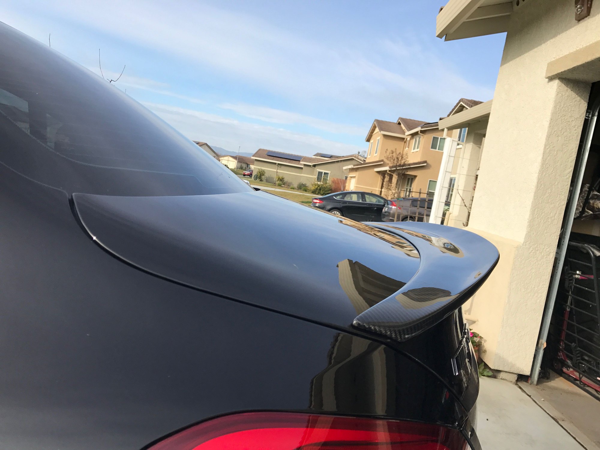

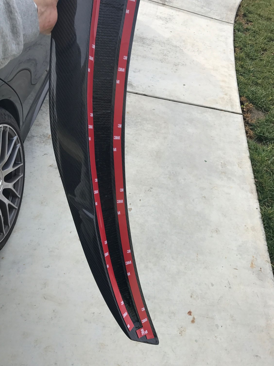

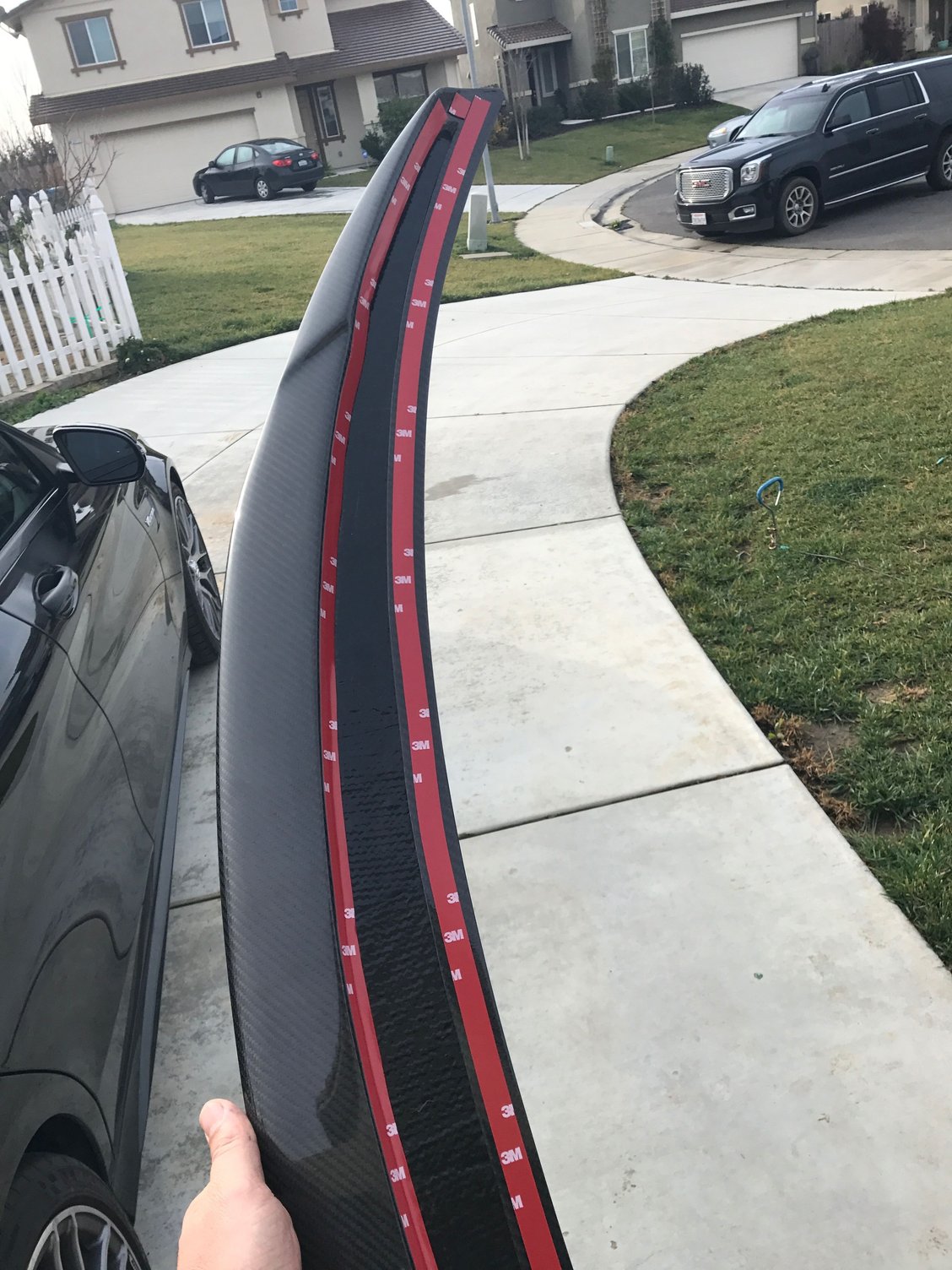

For installation, was pretty simple, just used 3m moulding tape.
1. Put the tape on the spoiler, but do not peel the backing off.

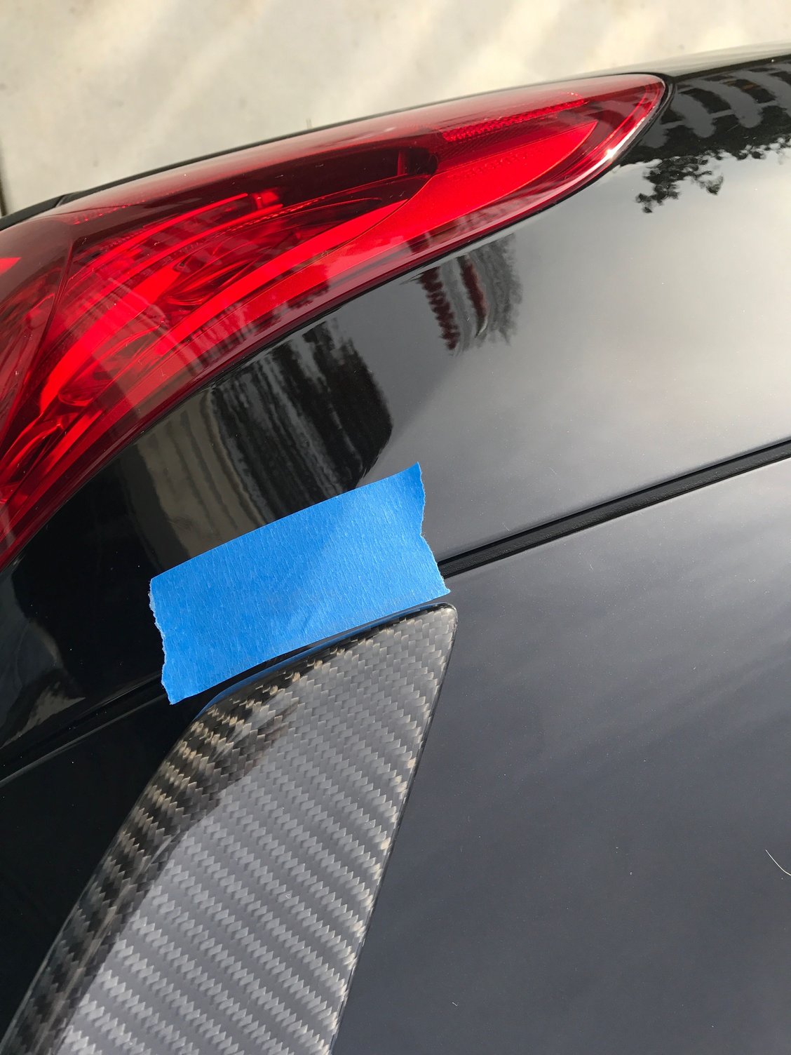

2. Align the spoiler exactly where you want it on the car and use blue masking tape to hold it down.
3. With the masking tape, mark a couple points so you know exactly where it will go back on.
4. Take the spoiler off and peel back the tape cover
5. Use some heat and warm up the tape
6. Working SLOWLY from one side, place the spoiler on the car
7. Apply ample force to get the tape to seal. You may want to apply a little more heat to the edges where the tape meets the car.
8. I'd leave it for a few hours before driving it.
