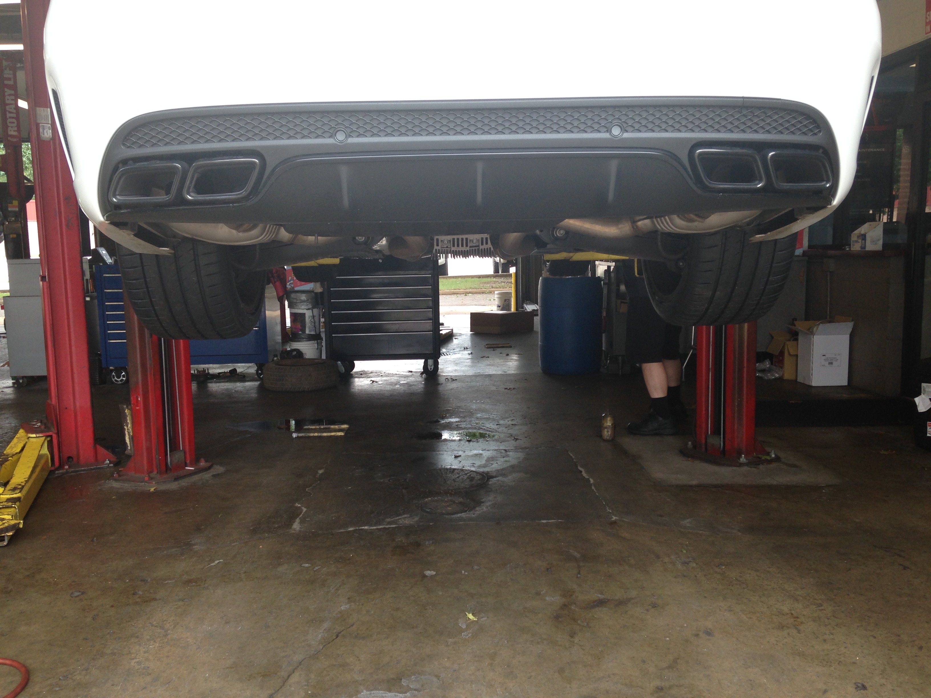

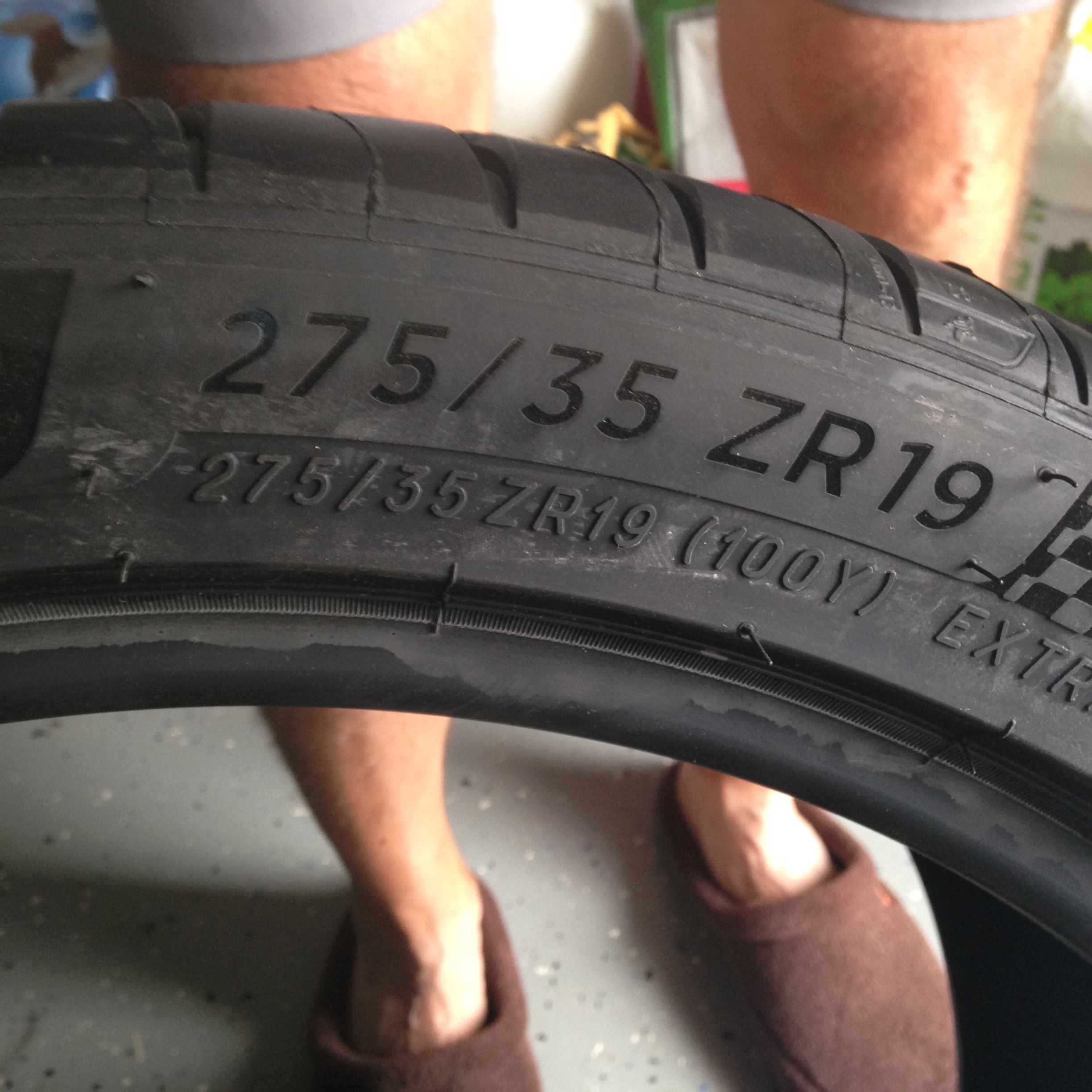

This is a topic that gets talked about frequently. It was time for me to put new tires on my 2016 c63s sedan. The car came with the Dunlop tires from the factory and lasted almost 20000 miles. As a side note for those who have them on your car, make sure you have them checked because my left front had a crack on the inside with the metal showing. The tire was basically starting to separate. Sorry I forgot to take a pic of this.
I was looking to get some more "meat" in the back and hoping for some traction. The car brakes loose way to easily in second gear and I have had the back-end step out a few times at 60- 65 mph in third as well. Wakes you up quickly, scares u for a moment and then puts a smile on your face.
I purchased the new Michelin Pilot 4s tires from Tire Rack. I kept the front tires the same size but went up to 275's in the rear. 275's fit on the 9 1/2 inch rim without any problem. You can take a look at the spec sheet on Tire Rack's website to see that the 9 1/2" rim will accommodate this size.
I have driven the car only for a few days but the traction is without a doubt much better. Some people talk about the balance being off but I don't feel it. I don't plan to visit the track with this vehicle though.
It definitely looks a lot better with the added meat.

Couple of pics

Yes. They have been on there for a while now and no problems. A big positive note; much better grip and better look then the Dunlop's.
