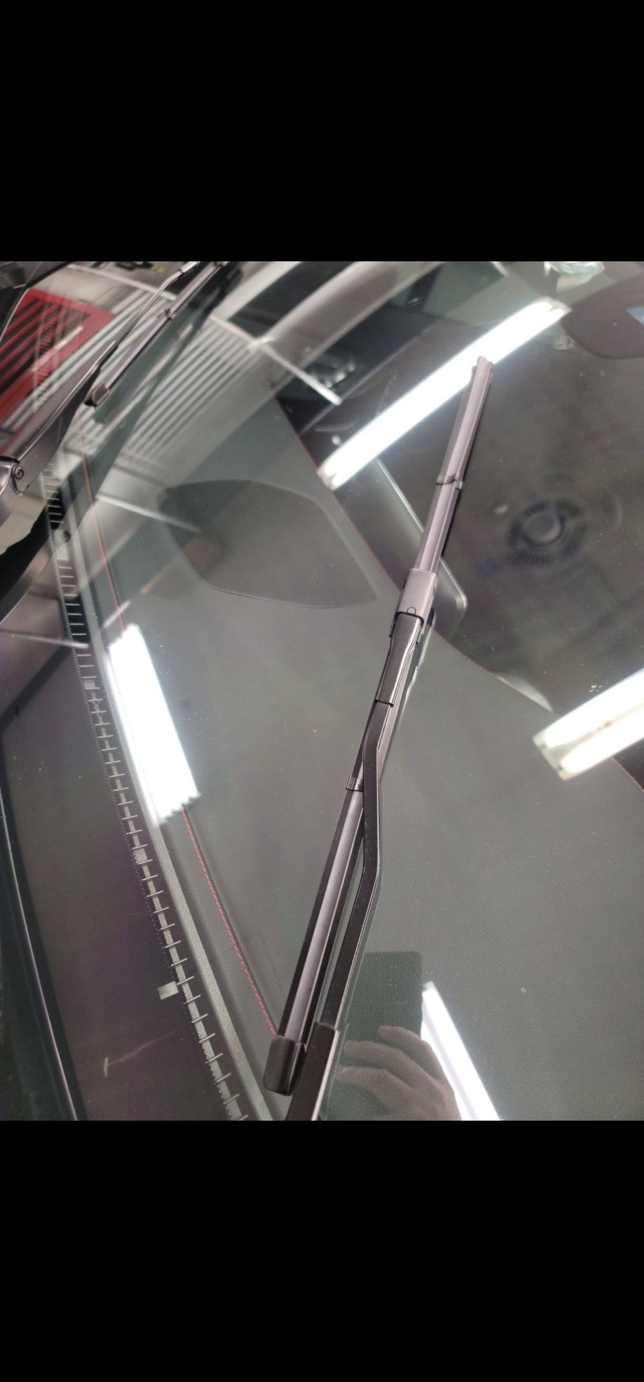

Do you mind taking a pic of the blade, in particular where it attaches to the wiper arm? I just tried the aero blades and they do NOT have the same little box like attachment point so I'm returning them. Want to make sure these are the same, unless we have to replace the attachment mechanism on the wiper arm itself?
Sure, no problem. I will tonight when I get home from work. I don't have the C43 at work today. I will take a pic of the blades (close ups).
This is the YouTube video I always reference when changing blades. They look almost identical to the OEM MB blades
The Broshoo blades are life changers with fixing the skipping issue! Truly amazing!

& these are 100% direct replacement. You do not need anything additional. You literally snap off the stock OEM and attach these. I'll post pics to this thread tonight.

Here you go.....these are screenshots of the actual pictures, since the files were very large:
