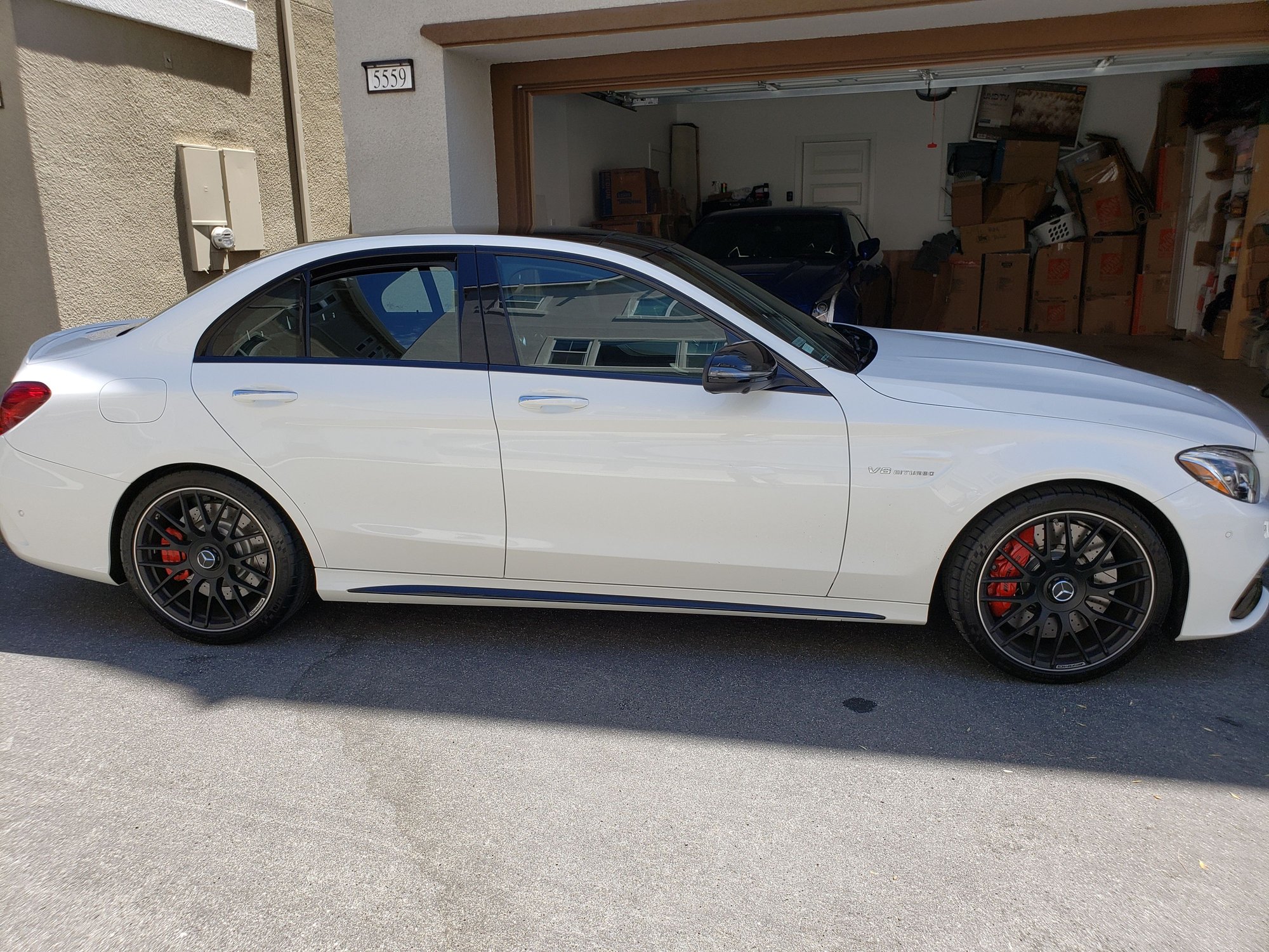

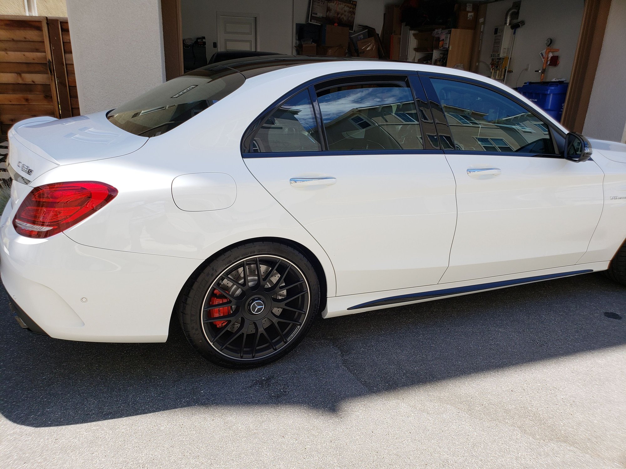

Looks good! Fellow white C63s and here's mine so far...
