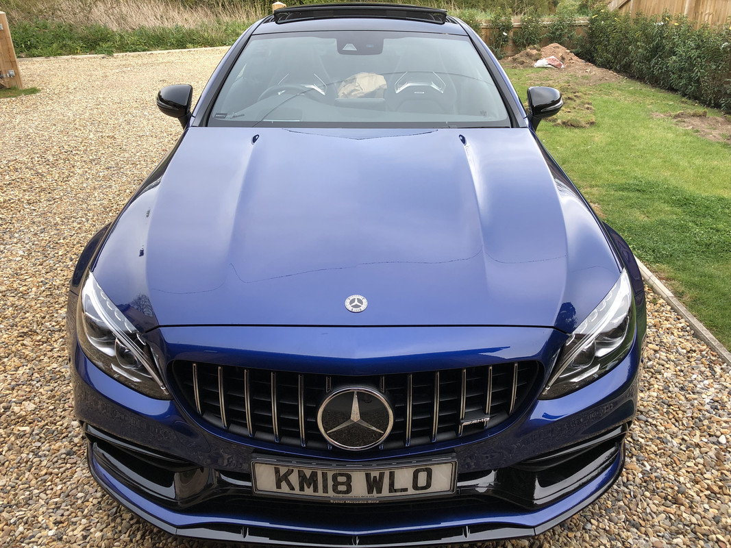

She is starting to look really untamed
cant wait for cf brabus lip to come and complete the front

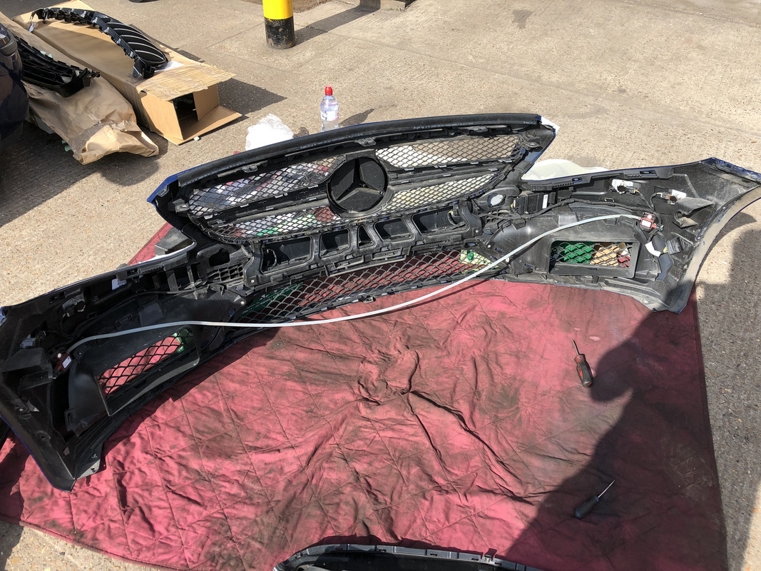

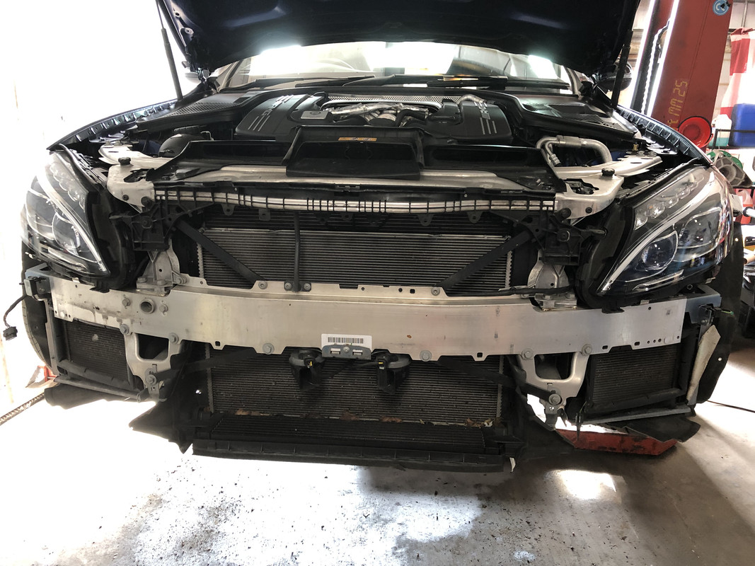

Here she is after MB put her back together.
I used a plastic riveter to secure the parts that were originally secured with aluminum rivets. It wasn’t as tight and I would suggest getting the correct parts to do this.
What caused my issue? The tech said something I did had caused the bumper to torque slightly. That’s why he stripped it all the way down and reworked the whole job. You may do just fine and it maybe me that was the problem.

My memory is a little vague on when I started seeing the rivets but I think you’re right. I think the center grill is the easiest so I left that part until last and just started with the lowers and left the center as my motivation at the end.
The parts are a waterfall inside of the bumper, have to remove a lot of things in succession to get to the one you want type of deal.

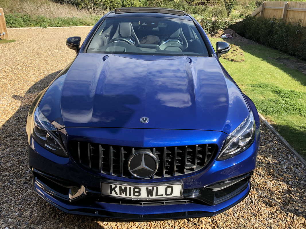

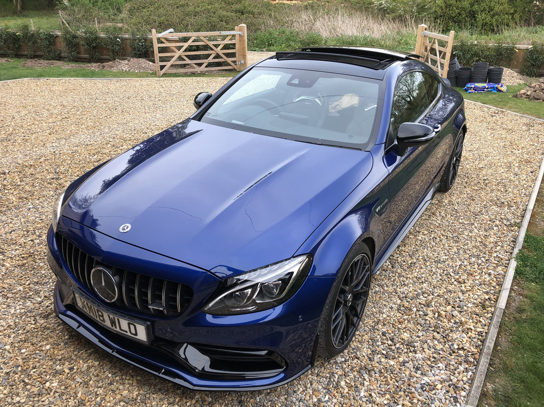

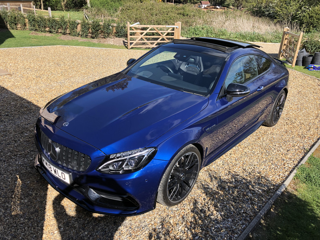

Well, tackled this today and went well using the advise from BG09 and reading the various threads. As previously stated removing the bumper was 30 mins and a lift ramp preferable. We removed the undertrays and this made life easier to access the bolts.
Then the hard graft started. Stripping it out took 2-3 hours of carefully removing parts and lots of fiddly clips. Same for re fitting it all up. Pot rivets. Lots of time drilling out and re fitting. We onky removed one grill at a time and re fitted new part to avoid any potential flex, as warned by BG.
Managed to squeeze in fitting edition 1/ 2019 side skirts also, and these really make the car stand out. Possibly like these more than the grill.....
couple more pics,
Also fitted the edition 1 / 2019 rear spoiler
will post some better pics soon. 2019 rear diffuser and tailpipes on order. Tried fitting rear flicks and failed massively so more research needed in these.
