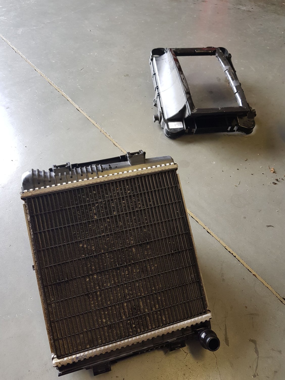

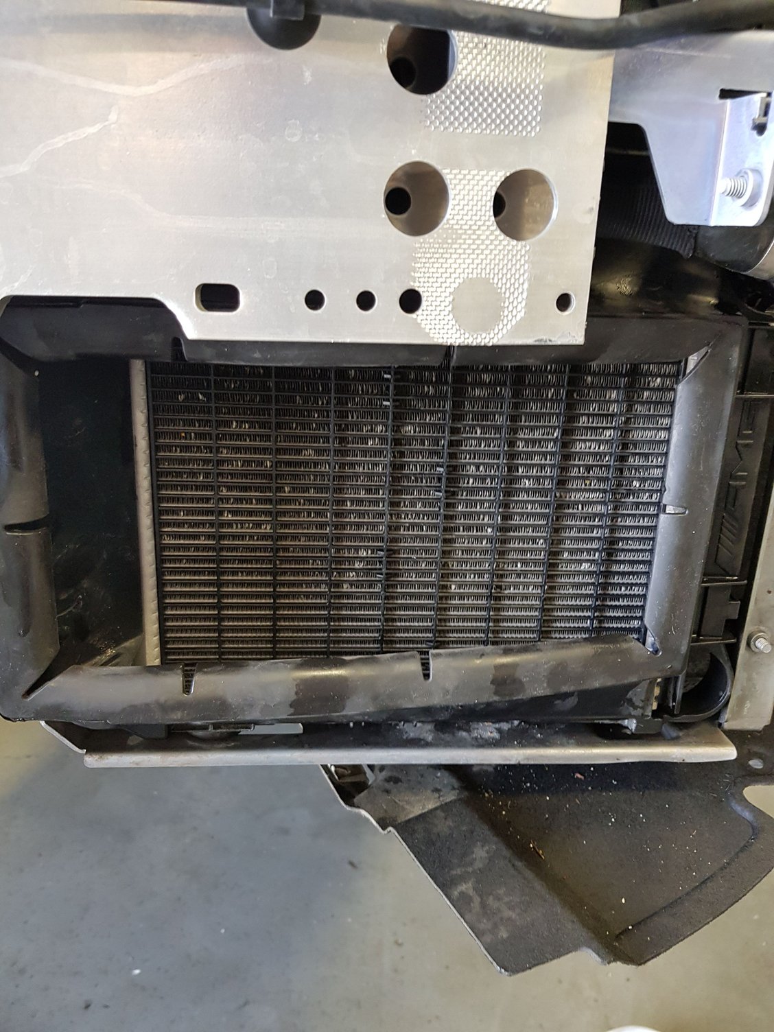

Installed the cooler grilles today . You will need to remove the coolers to complete the job as the ducts are in the way . The grilles are very easy to install once the coolers are removed and they have barbs that push into the cooler fins and they also have tangs on the ends to slide under the cooler tanks ...... pretty simple but removing coolers is a pain and whole job with the bumper already removed took just about an hour. My car only has 15,000 miles roughly and you can see the amount of impacts the coolers have already taken ....this should cut down the damage significantly
You will need to remove the coolers to install the grilles as the ducting is in the way
Here it is installed , perfect fit and goes on very easy .You can see how much damage mine have and I only have 15,000 miles
Here they are both installed
Close up of how the barbs such into the fins to hold in place

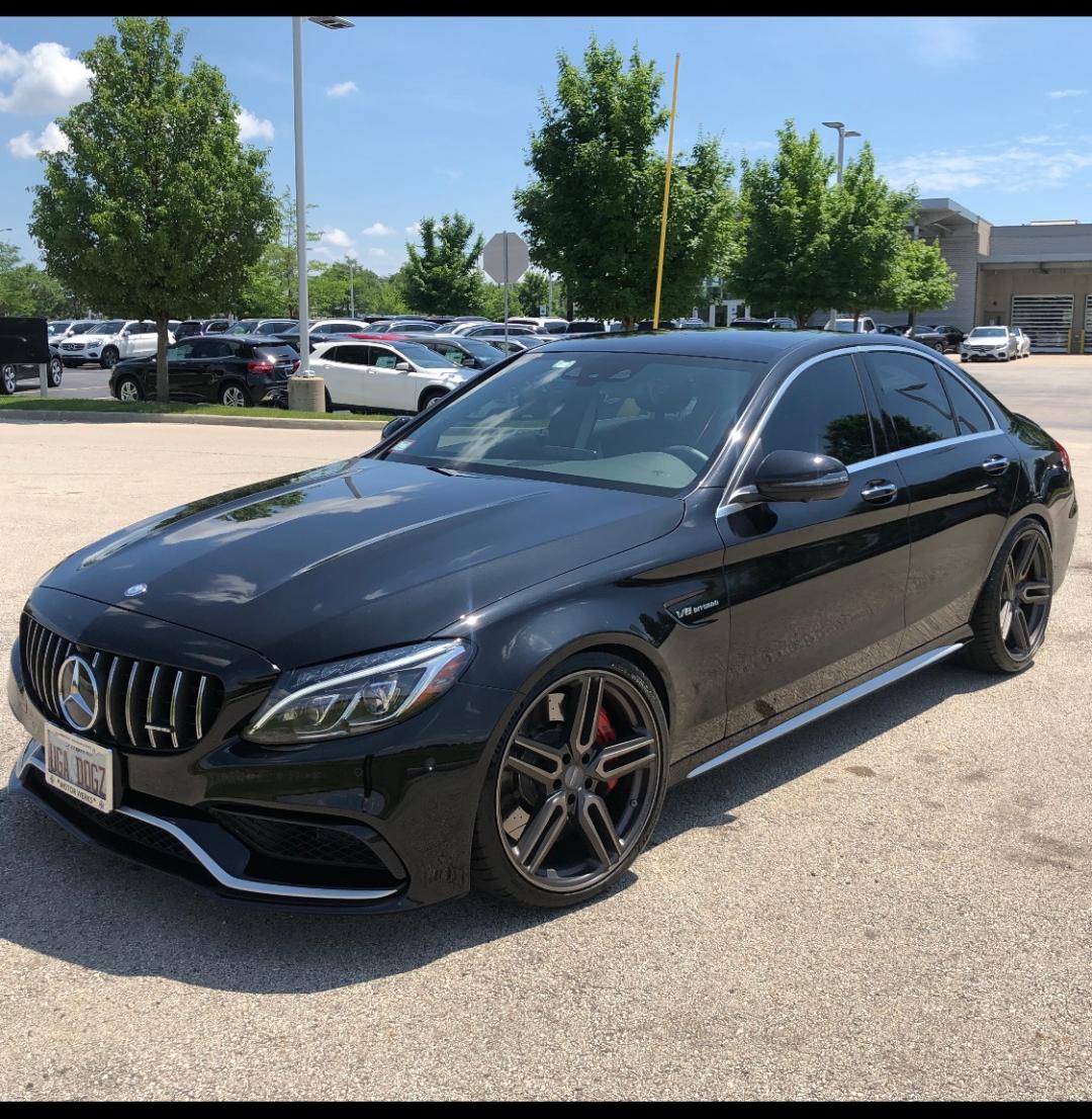

And the end result .....

Quote: And the end result .....
Awesome updated look! I have the same color sedan and looking to add the grill. Thinking about not installing the bottom inserts though.
just curious did you go to MB dealership to install the grill? If so how much did it cost you if you don't mind me asking?
im looking to order the parts from MB and have them install it.

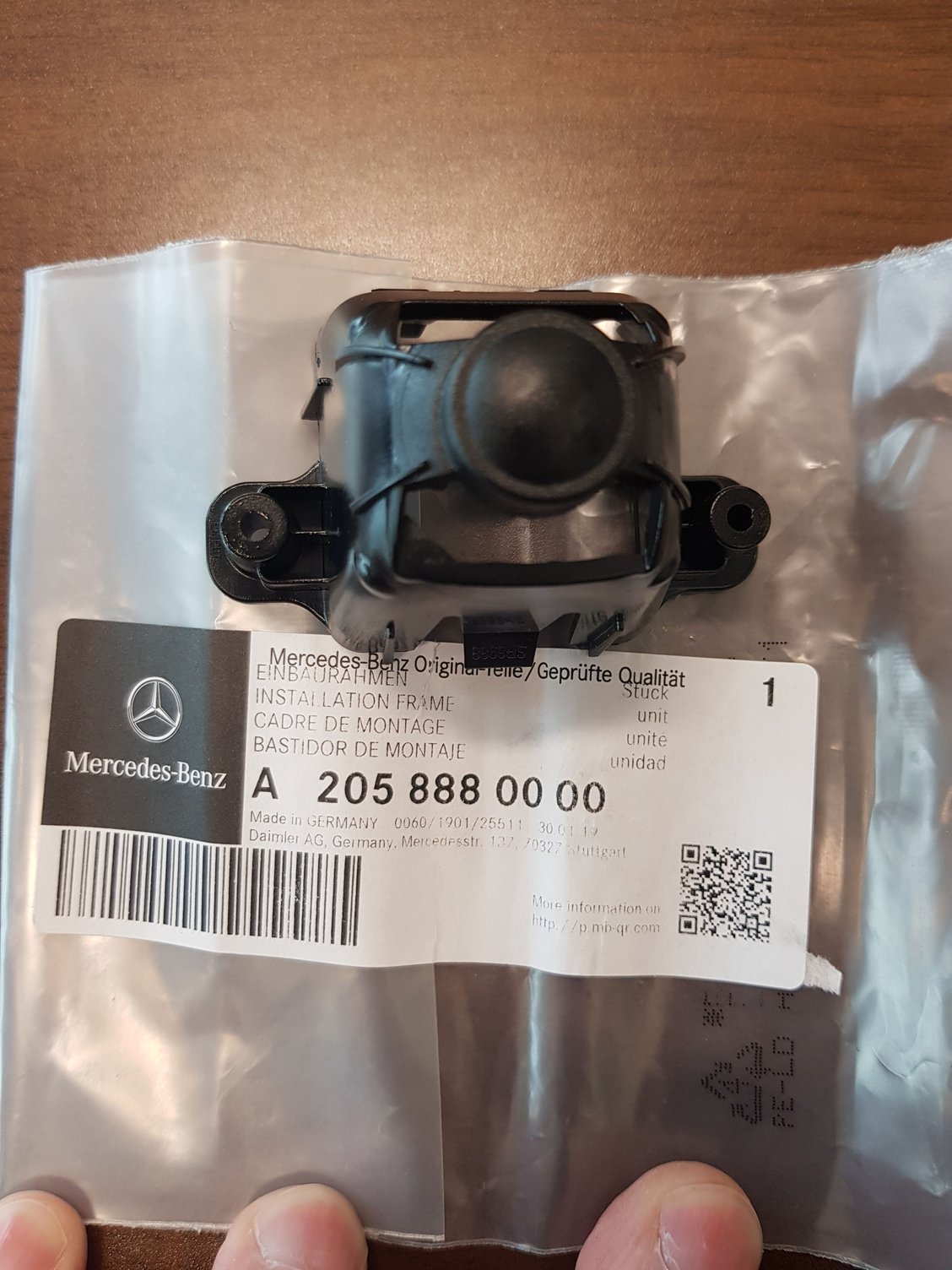

Question for those that have done the conversion ........ What did you do about your temperature sensor mounting in the left lower grille ? Ive been waiting for a 2019 c63 to come into my work so I can see how its it's mounted to the lower grille. There is a round opening but unlike the earlier years there is no extension to mount it in its just a hole .
The Mercedes parts catalogue does not show any add't parts and the sensor seems to be the same part number as earlier years . For now I zap strapped mine in place but there must be another piece or something different about the sensor ......... anyone ?

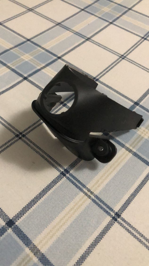

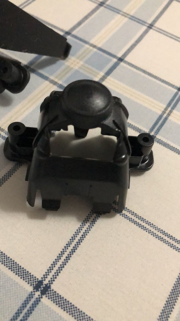

Quote: If you are doing the conversion and do not have a 360 camera in the front this is the blank you need to fill the hole in the upper grille ....took a while to figure it out as EPC doesn't really tell you this part and it took a bit of guessing but this is what I ended up with ....part # is in the photo. You will need to trim it to fit and glue it in place as it's not an exact fit . They do not make a blank for the new grille , this is for the 2015- 2018 model grille
I
i bought this dummy too. Do i have to connect this with the part that comes with the Panamera grill? Seem like i cant combine them. Pls see the otherr photo. Need help guys

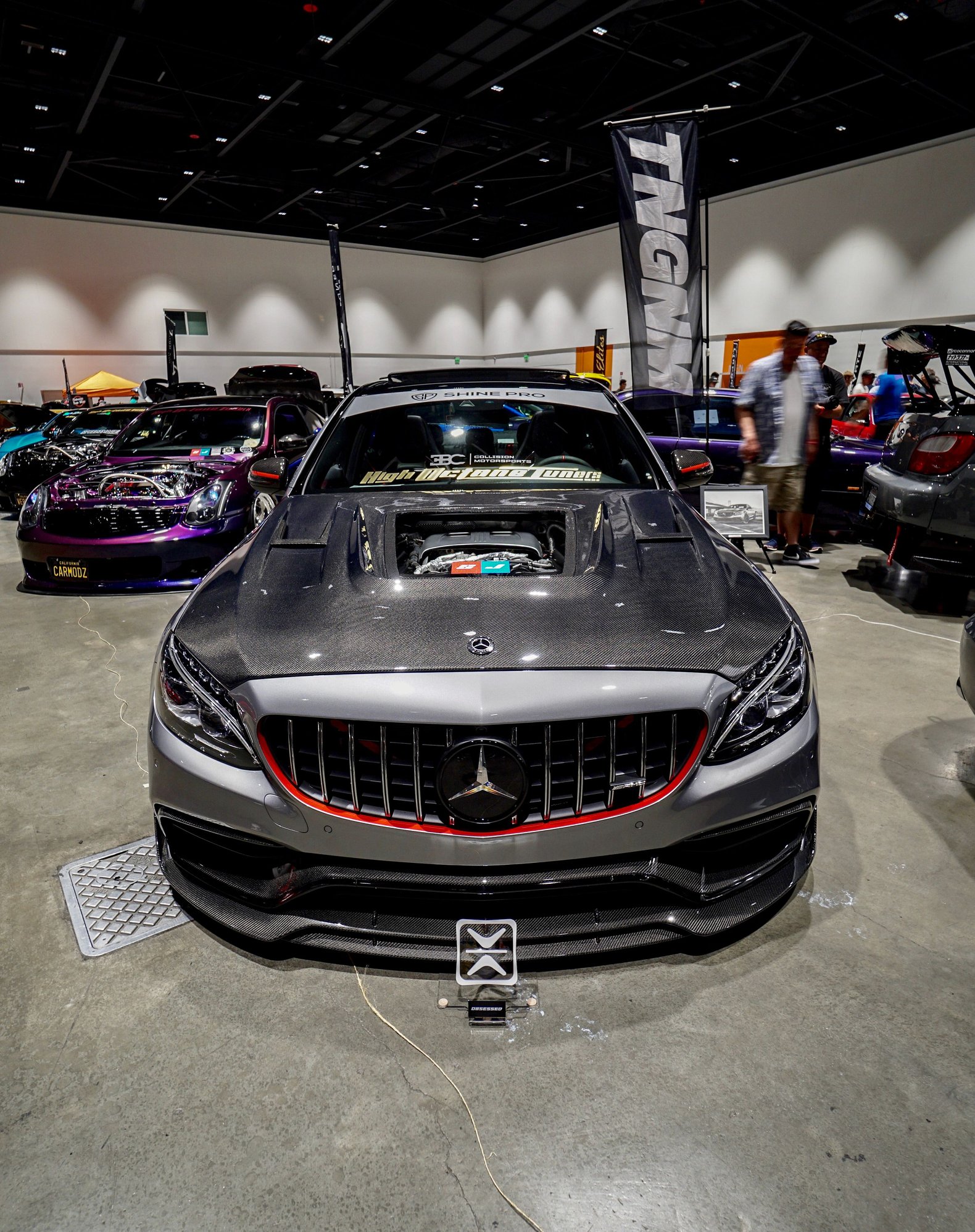

Panamericana
Rocking the facelift look now too. Grill and inserts. She look so different now
I'm probably late to the party but.... I'm assuming this hood is completely custom? Looks amazing!
