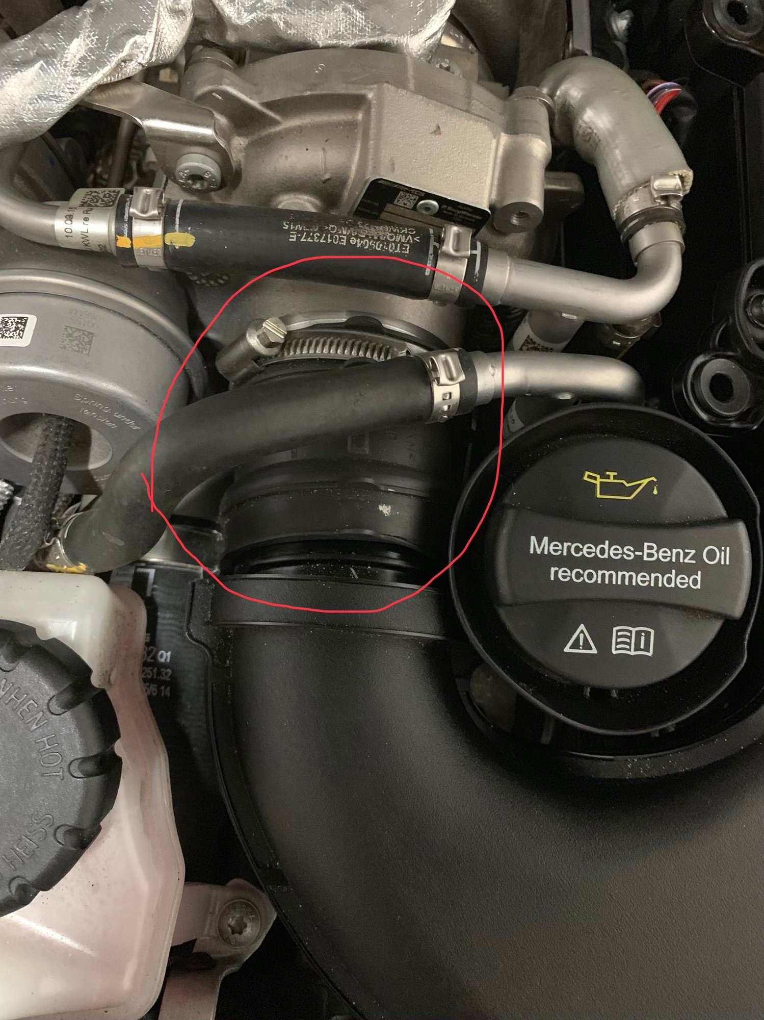

Hi all , I need some help finding a part number. I went to MB and me the parts guy and parts manager could not find this in the system or part number. I don’t know the correct name for it but it’s the rubber connector that connects to the inlet of the turbo and connects to the intake box tube
I have a 2015 C63s

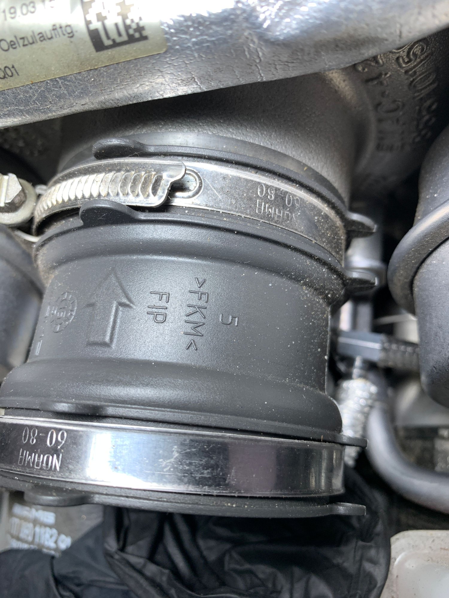

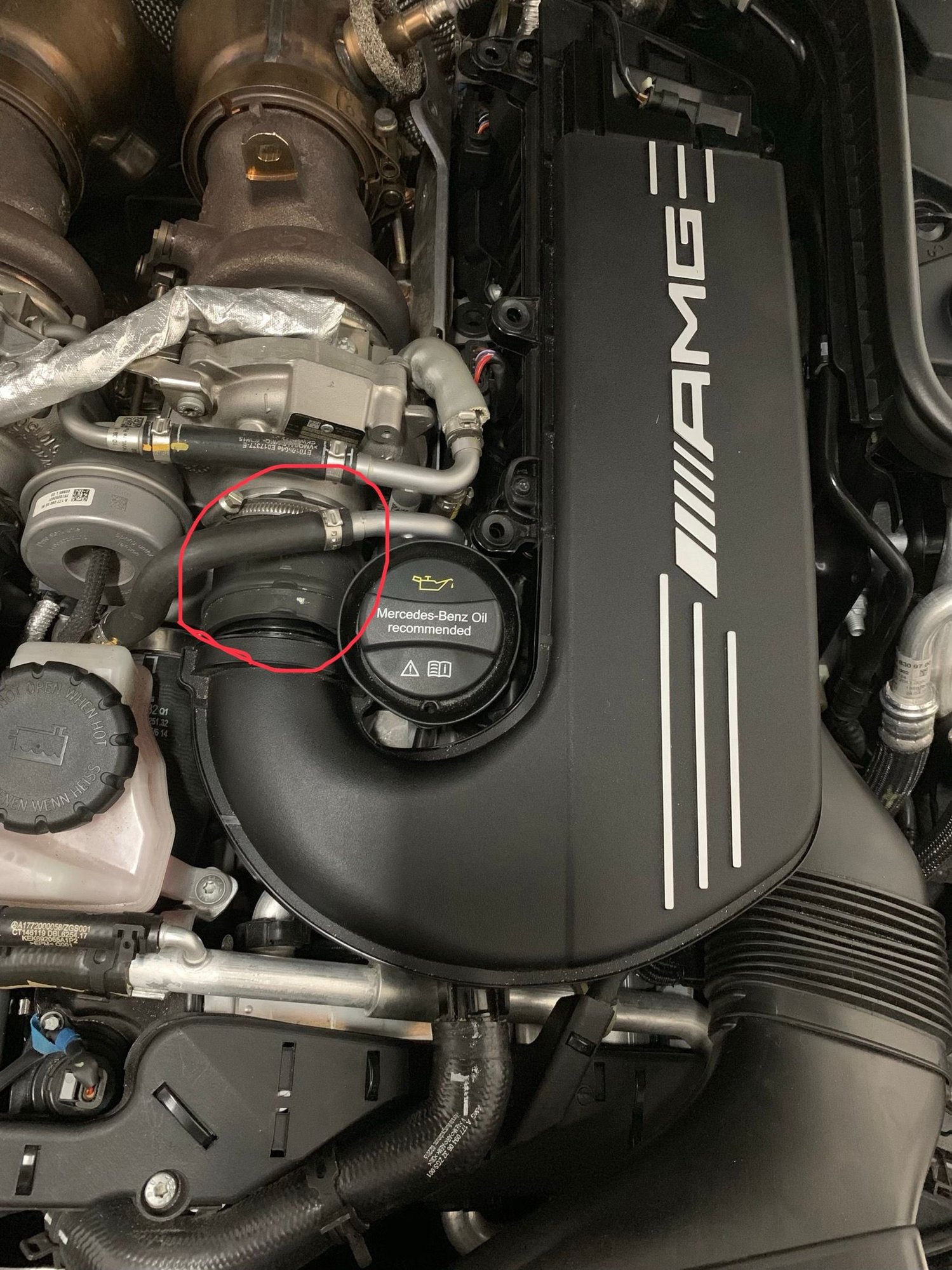

if you had a pic that was wider view, so I could get a better grasp at what I am looking at, I could dig alittle deeper.. I am in my office, so cant go out and look under my hood at moment.
That hose, needs to be FKM ,I see that ... (for the heat)

The only thing on there are the top numbers

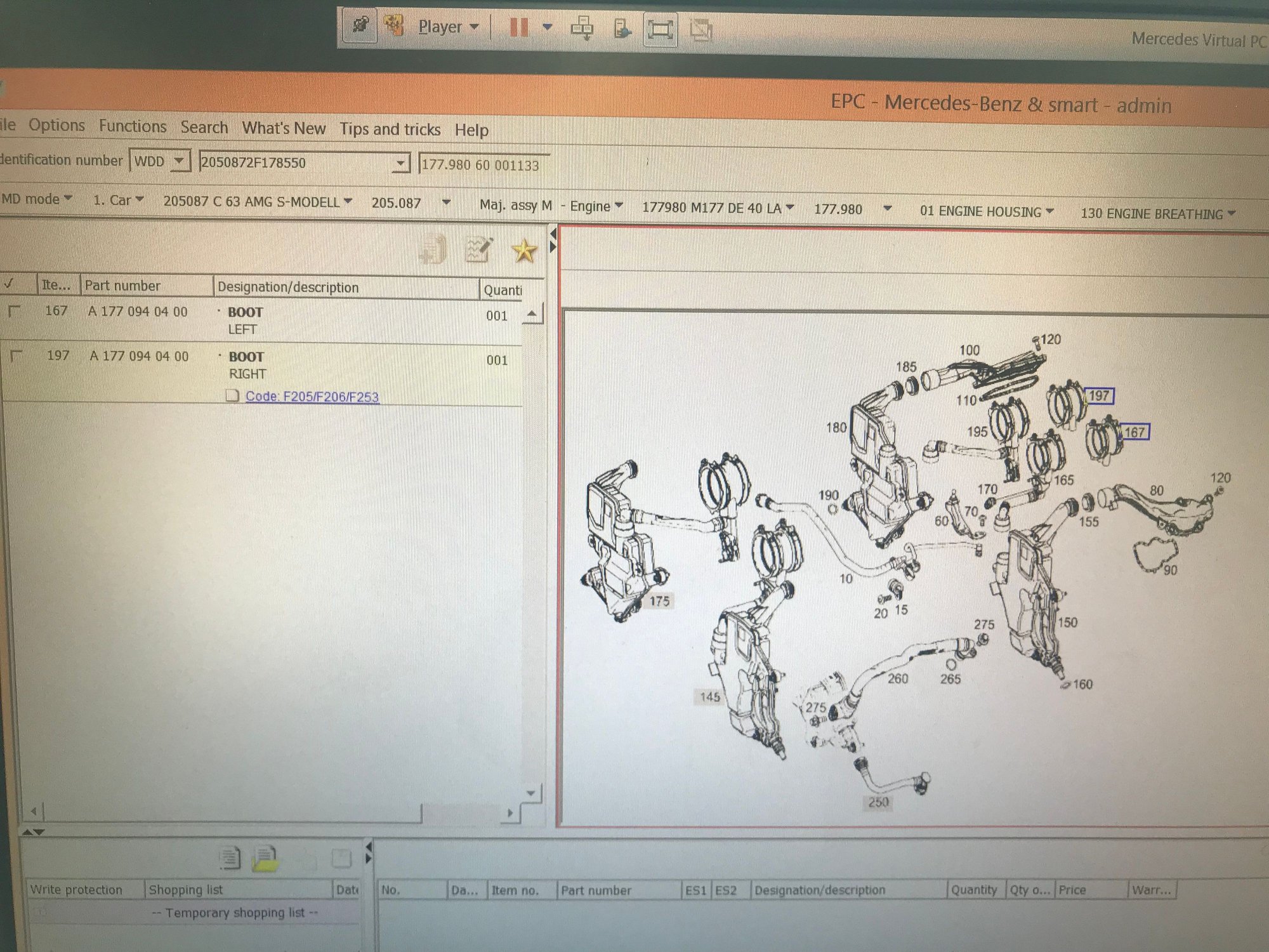

The parts are listed under the CCV system
A 177 094 04 00
same number for both left and right

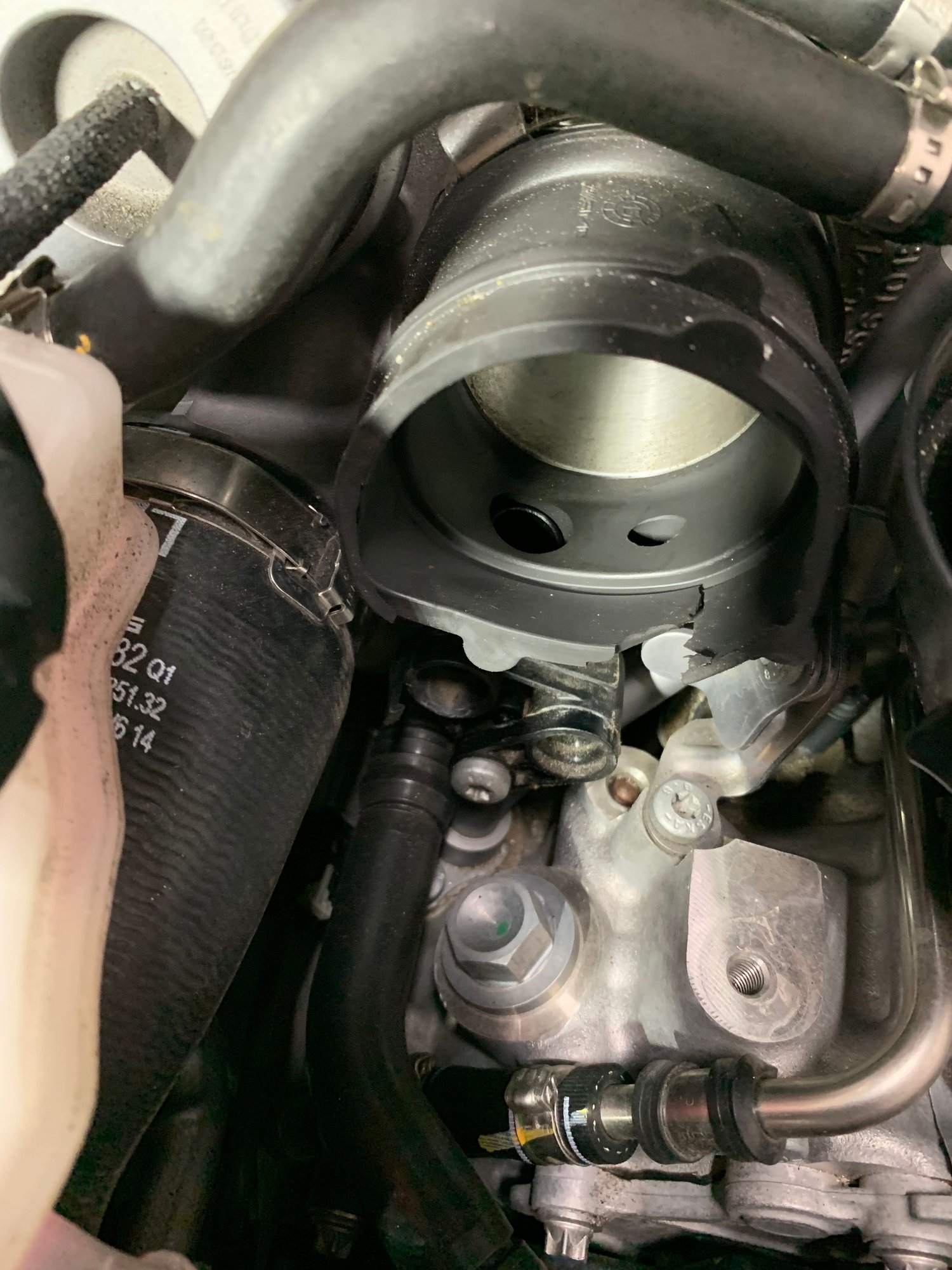

lucky that missing piece of rubber didn’t go into your engine! The new boots have a warning on them and a torque spec

Yes I seen that when I got the diagram for MB , I seen it noted.
