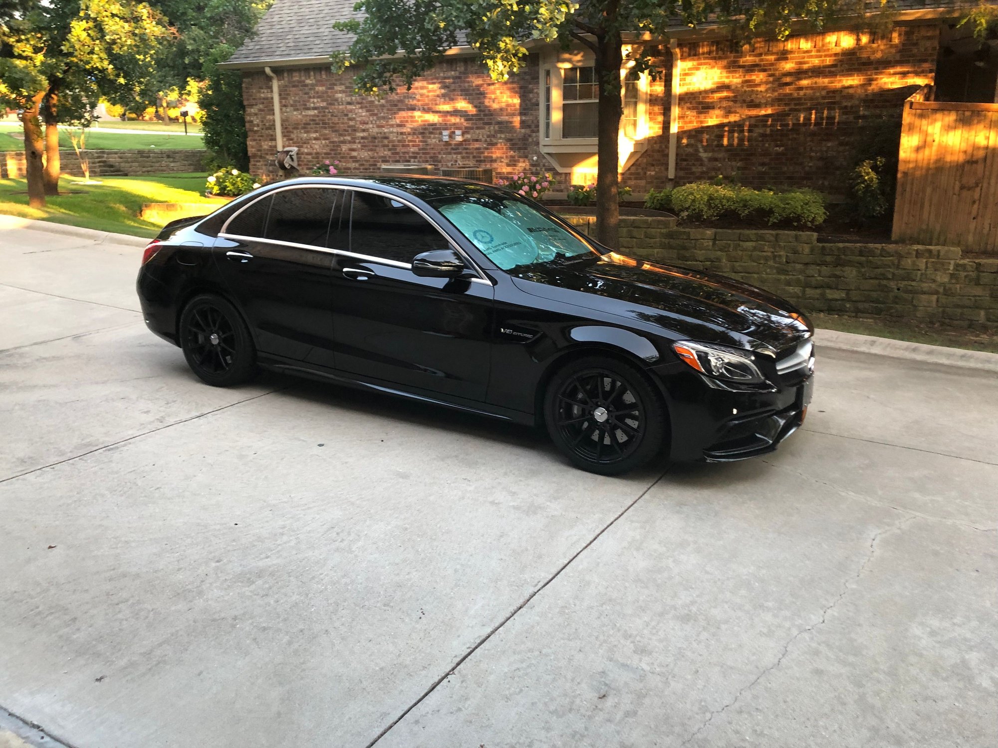

Want MORE POWER....What’s Next?
Thanks!
The Bandit....
