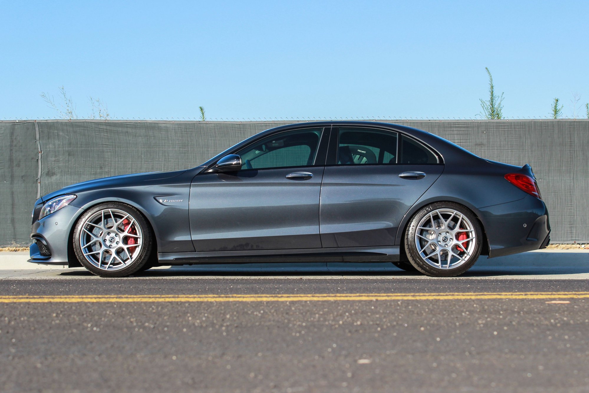

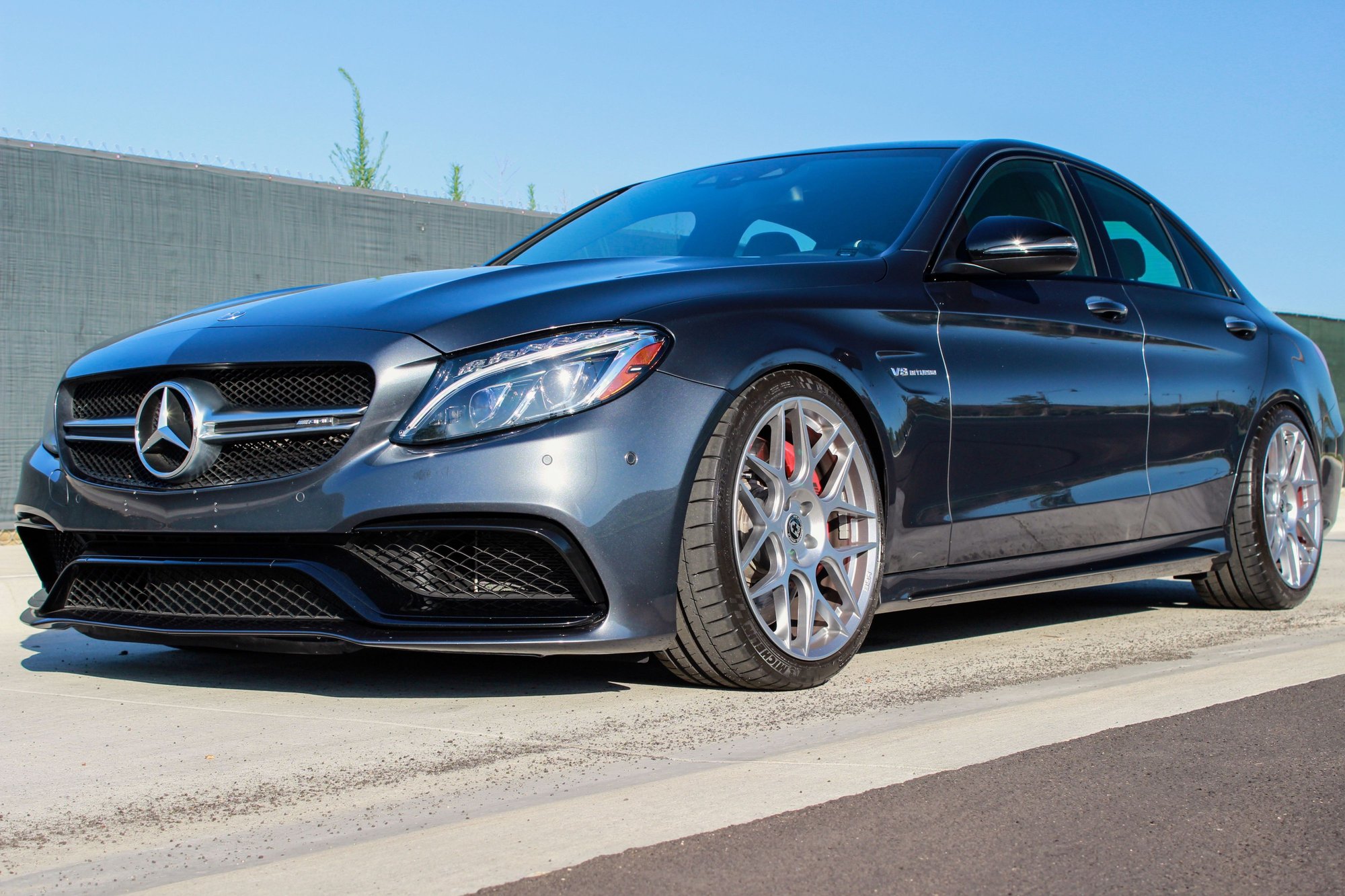

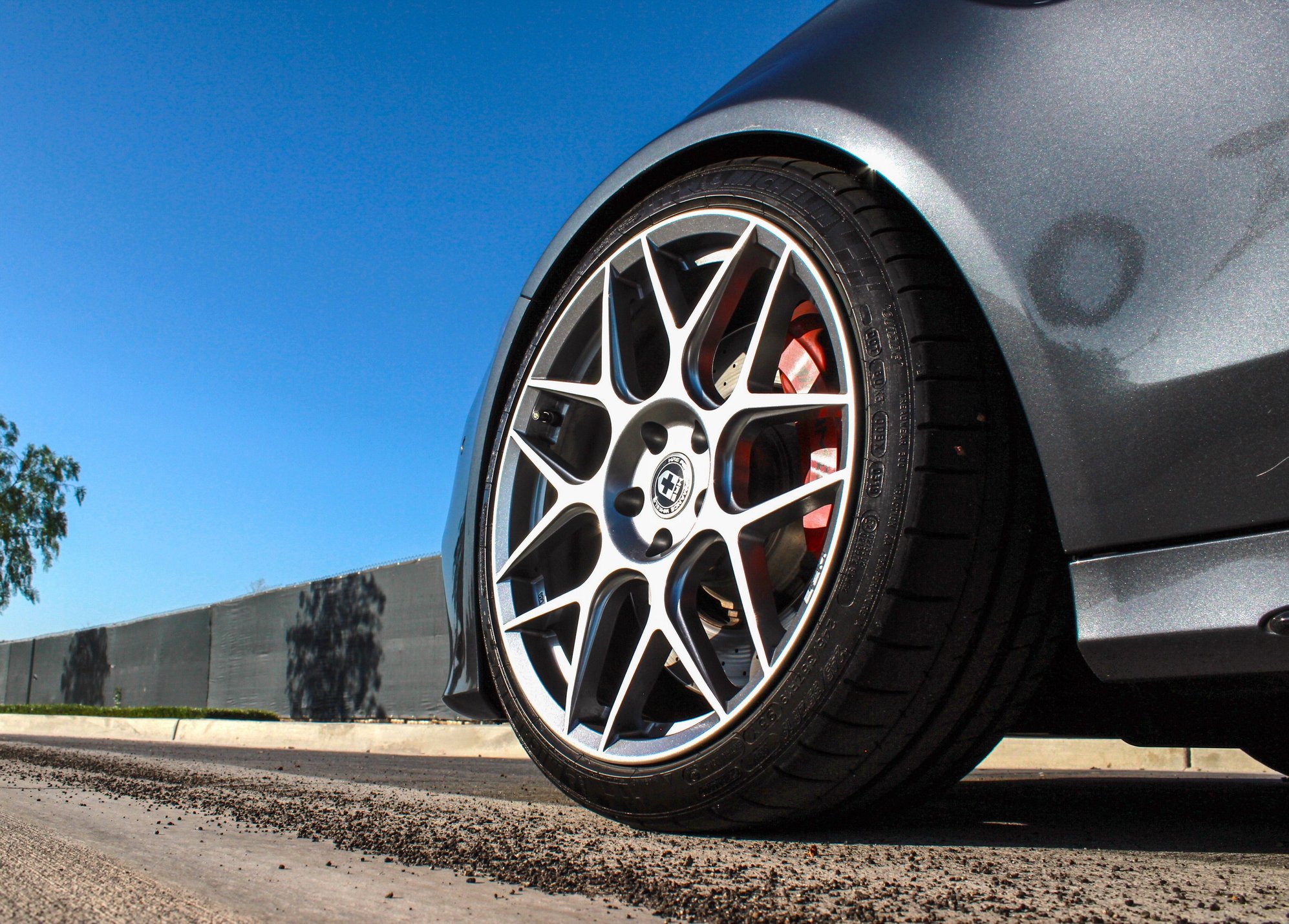

I'm running P104's but they are 20's and are on a coupe. They are great looking wheels. If you reach out to HRE they will work with you on fitment. They know the limits to put the most aggressive fitment without impacting anything.

Ok I'll send them an email. Would you mind posting some pics so I can get an idea of how they look? Thanks.

Sorry, just saw this. Here's a few.

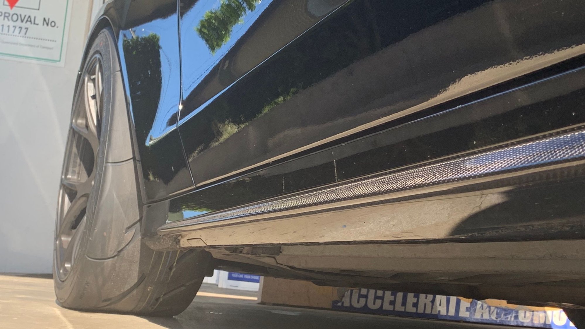

I highly recommend checking out BC Forged, lots of styles and colours and I can confirm 19x9.5 et 30 & 19x10.5 et 57 will fit sedan.
I’ve been running 265/35 up front and 295/30 on the rears for a couple of years now.
Ive just gone to 305/30 on the rear but have now got rolled rear guards for some extra room.
If in Australia contact Ross at Rollingstock he had my custom BC Forged 18” rear wheels made and on my door step in 9 days.
I also highly recommend fitting f&r camber kits to save your new tyres - contact Kevin at K-Mac.
If you need any more info feel free to pm me.
Rear 19x10.5 et 57 - 305/30/19 Nankang AR1 K-Mac Camber Kit (1 deg neg camber) Rolled Guards
Front 19x9.5 et 30 - 265/35/19 Nankang AR-1 K-Mac Camber Kit (1.5 deg neg camber)
