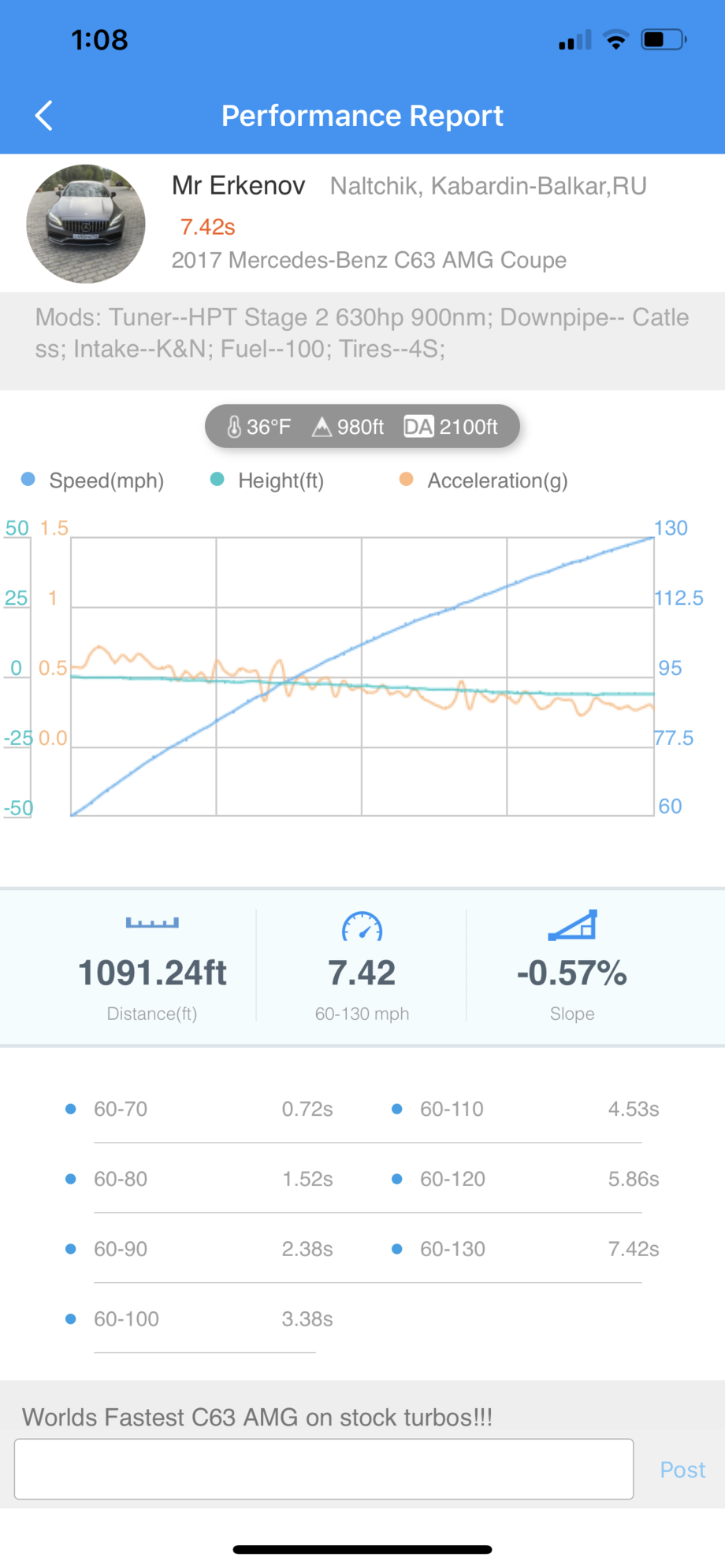

So Open Flash sent me their tablet with a stage 1 tune.
i have to say i am very impressed. the car pulls harder on top like i wanted. i just tested my draggy and it did 60-130 in 8.86 seconds which is faster than the car has gone on my previous tunes. With better traction i think i can get that time down some more
i recommend this to anyone looking for the best bang for your buck.
I paid $999.00 for tablet and i get the ots maps included and free updates for life.
Shiv, the owner and tuner at OFP offers custom etuning as well for $295.00 which i will def be doing soon to get closer to my 7.5 sec 60-130 goal.
Additionally the tablet gives you a full gauge setup so you can monitor your car and you can pull your logs on it too
https://www.openflashtablet.com/
