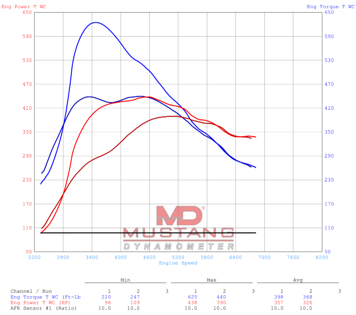

Oh! I think I find my slow buddy. We can try to get it sorted together as as I find we have exactly the same symptoms.
I am with EC Stage2+ cat-less down pipes+305 Rear
Below are my result at street 3000ish DA.
  • quarter mile: 12.3-12.5sec @118mph
  • 60-130mph: 10.3-10.5 sec
I brought my car to a dyno and found the torque actually decrease very early(shown in below pic). Probably that explains the weak high end.
I was told mustang dyno reads lower, so take the absolute HP/TQ read with a grain of salt but pay attention to the gain and curve shape.
I also had my car scanned with Xentry but actually no error codes were found.
One thing worth mentioning is that I also experienced a CEL once when doing WOT. Restarted and CEL was done.
I attributed that to low fuel remaining to support WOT, so I did not scan it.
My car is 20k and just finished service B and got the spark plugs replaced. I will test again next week to compare.
I would be nice if I can try other brand tune to compare, but too poor to buy another tune when its not a guaranteed root cause.
