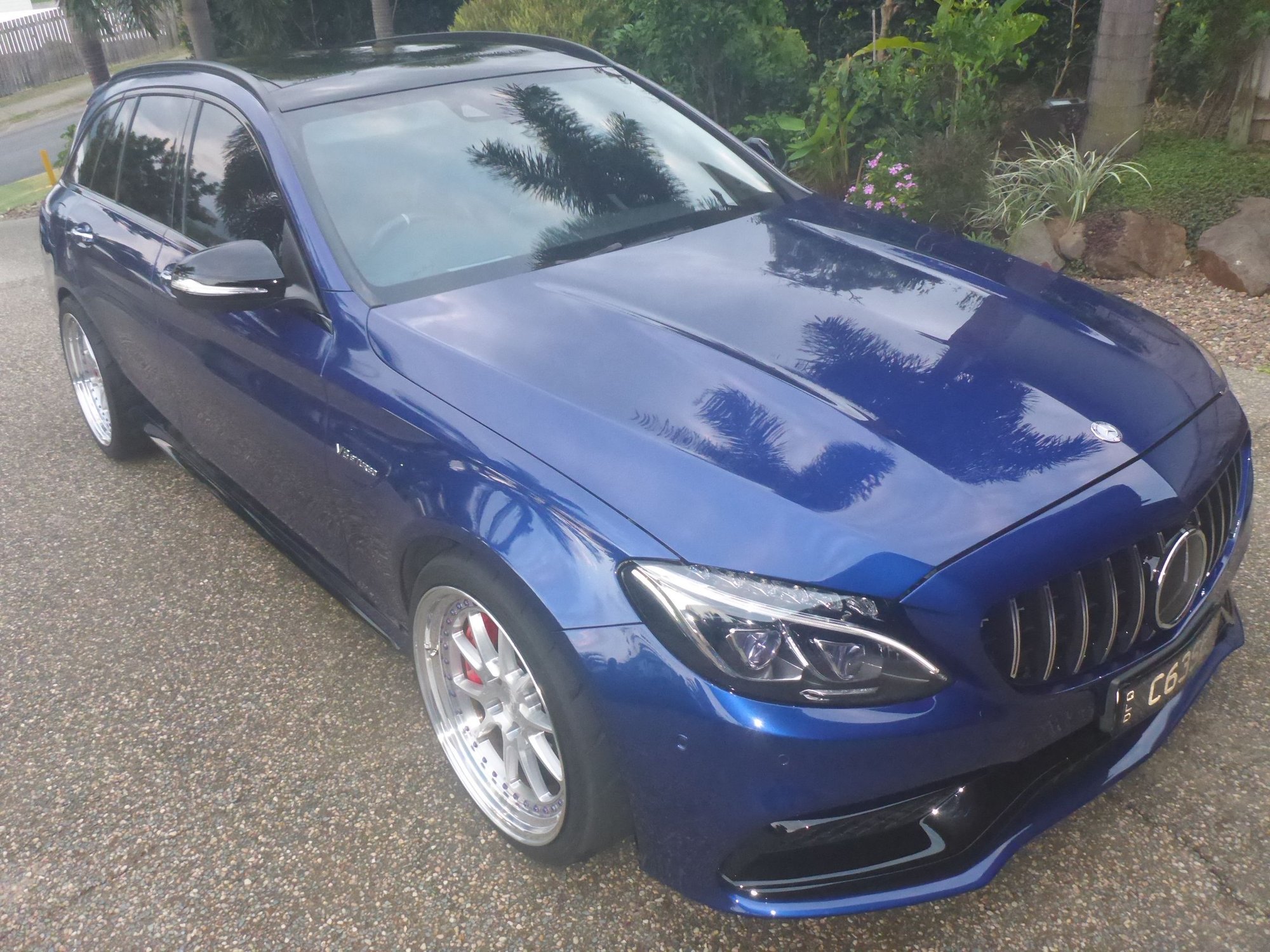

Have got BC 2 piece 19's on my estate with a 11" rear and offset is 57. A little to aggressive poke to be honest.
