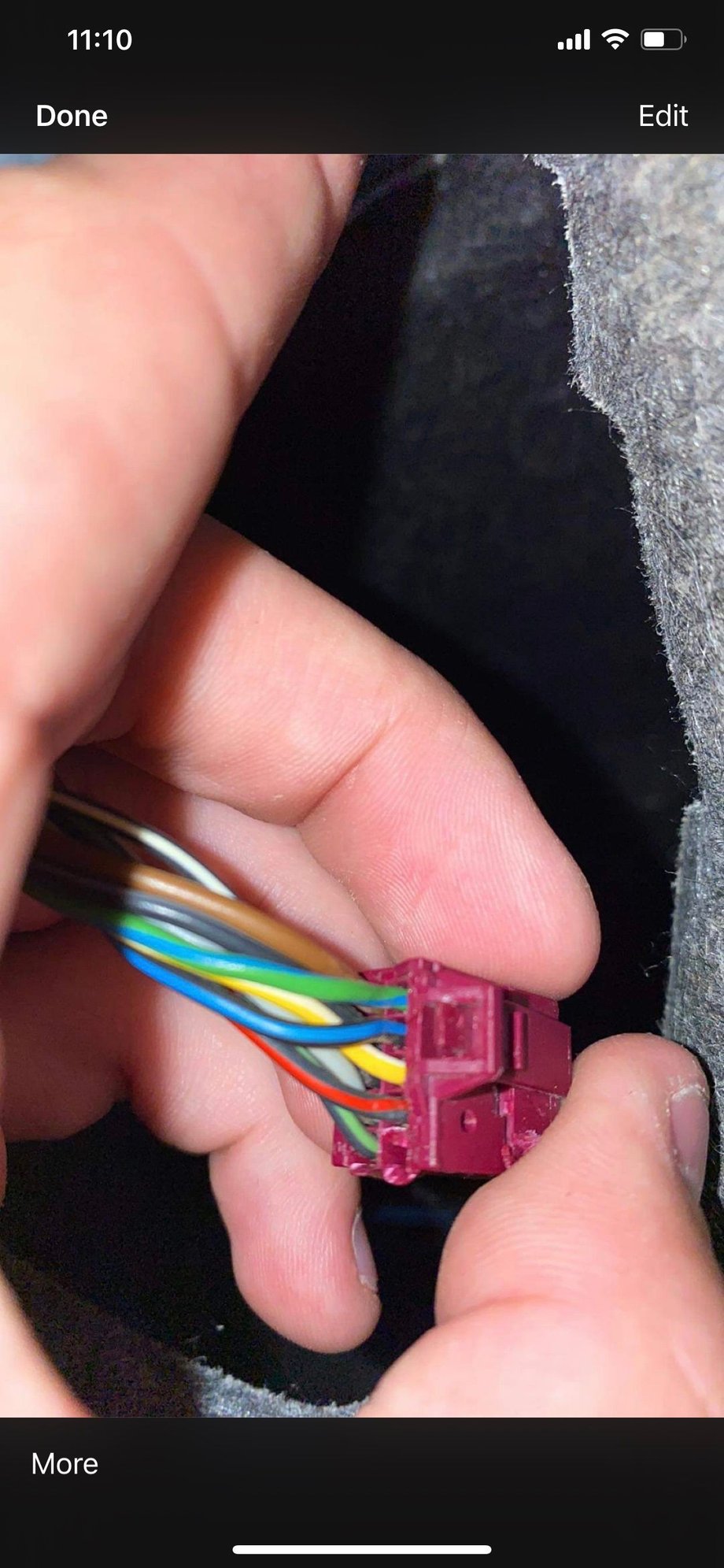

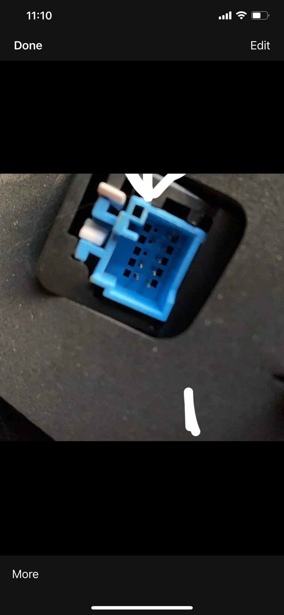

I have a 2015 US c300 that I’m trying to put 2020 European lights in with sequential. Currently they work with a minor harness change but with headlights on, the amber signal remains lit and I can only use the red signal like a normal US model. Any help would be appreciated thank you. Here are my connectors, would your cable linked work for me?
Original connector male end
Original connector female end
New tail light connection female end
Yes from what I was told it will fix the issues when upgrading from pre-facelift, btw where did you get the European lights from?

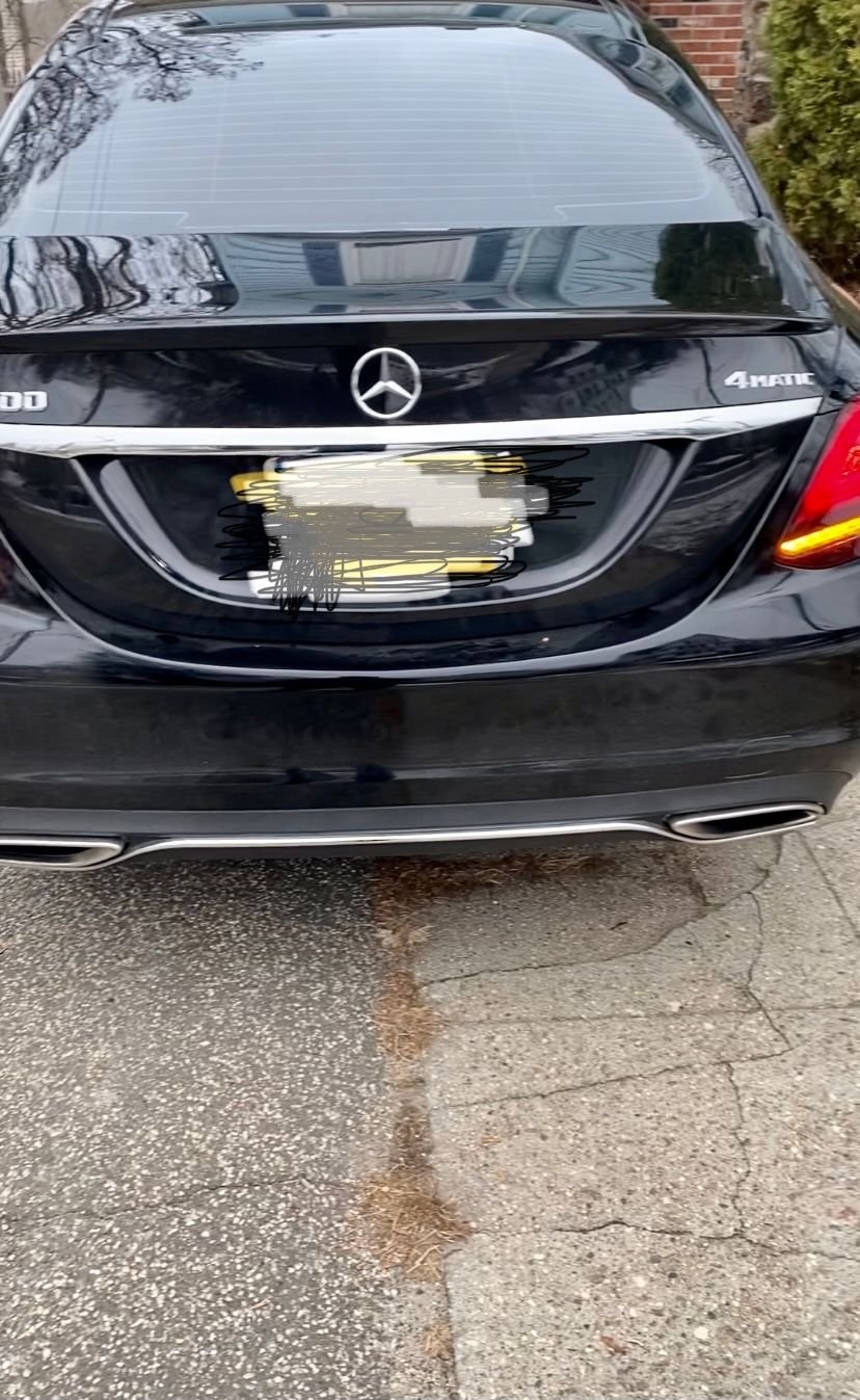

Same issue
I purchased the upgraded lights for my 2016 c300 and I had the same issue with the amber turn signal working as a running light, will that harness work on mine because on that German site that was suggested it said it doesn’t work on us models?
It will not, I ended up with the same issue. My lights are sitting around because I’ve been too lazy to mail them back to have them completely adapted from aftermarket company. Let me know if you find a better solution, otherwise I pretty much gave up.
