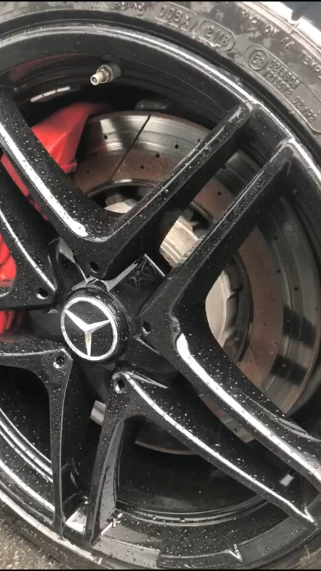

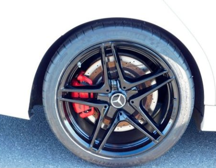

I found a really nice C63s, exactly the color and everything I always wanted but there are a few concerns I have. The brake rotors look really worn, car was probably on the track a lot. How much do those usually cost to replace?
Also the carfax looks sketchy. The only reported servicing was at 40,000 miles (1 owner) so this guy either did it himself or had some side shop do it before then. I can't imagine him driving that long without an oil change, but who knows.
Current odometer reading is 47,000. Other than that the car looks and sounds great. Any thoughts?

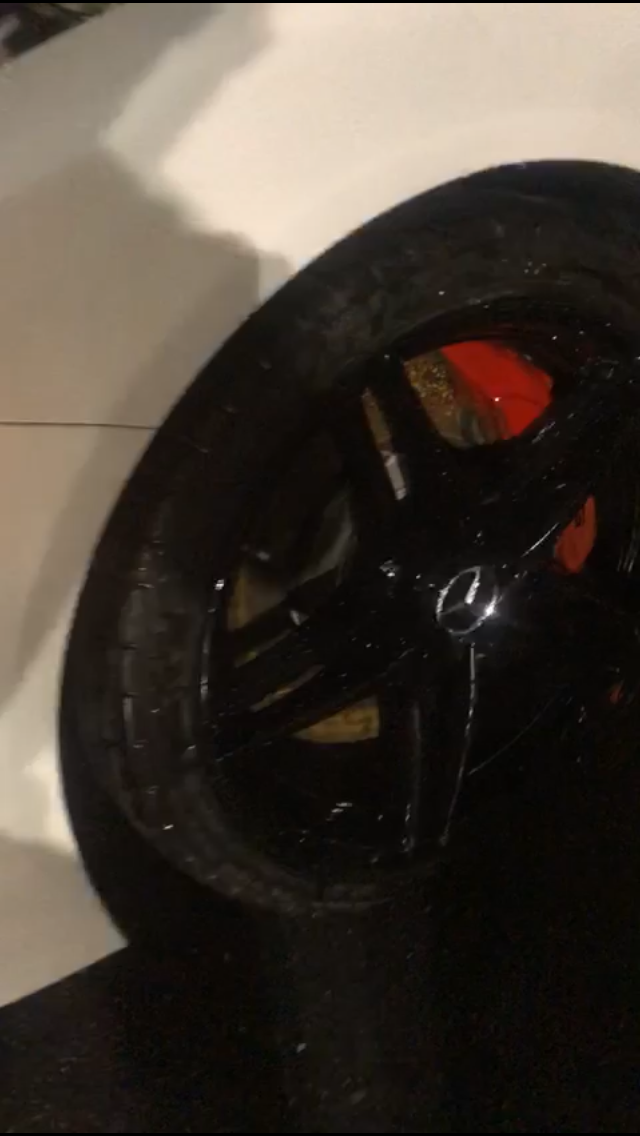

The front looked more rough but I should get a better photo tomorrow. I'd be looking to replace the front if I needed to, though.

Fronts just look like surface rust from sitting after a wash. The rears look odd, as the pad is not making full contact with rotor

Just got another pic of the fronts. Would you say it's still a good buy or do you think they'll need to be changed out soon? I plan to drive it on the track once every few months.

You really can't tell visually if a rotor is worn unless it has really obvious score marks or something. I just see normal rust, which all rotors have after sitting for more than a few days. Only guaranteed way to tell is to put some calipers on them. If it's a CPO, the dealer should do this for you and tell you the exact thickness. My dealer does this for brakes and tires at every service.

The rust on the rotors is simple surface rust that any rotor will get after sitting for a while or after being washed and not driven.
The uneven look of the rust looks like the car has recently had its brake pads changed, and the new pads have yet to properly seat with the rotors. New pads won't be exactly flush with the rotor, and it takes them a little bit of time to wear flat. Drive it for a few hundred miles or so, let the pads seat, and the rotors will look more uniform.

- the half-rusted rotor surface is bothersome, even if the pads are new ... it implies that either the wear on the rotor or the pad seating (or caliper-piston pressure) is quite uneven (from outside to inside)
- you CAN tell whether the rotors need replacing due to reaching their wear limit ... there are "wear holes" (divits, actually) around the inside and outside edges (intermittently, between the thru/vent holes) -- when those have disappeared (i.e., the wear reaches the bottom of those divits), the rotor needs replacing due to wear/thickness (there are other things to look for, as well, such as radial cracks that usually emanate outwards from the holes ... WIS specifies a maximum length for such cracks)
- I assume you also noticed that the rims have been painted/coated, which could be a feature or not
