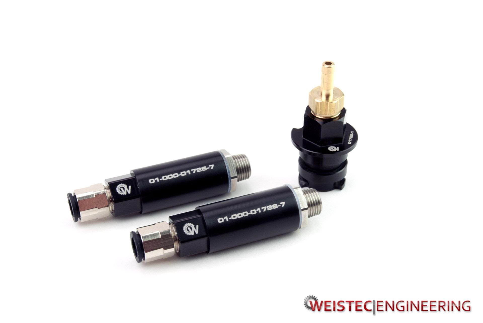

Where did you end up tapping your T hose for the dual port?
Old May 8, 2020 | 01:02 AM

https://mbworld.org/forums/c63-c63s-...tallation.html
explanation and a pic in the above hyper link , as Alex mentions in the post there are taps on each of the manifolds that could be used with an adaptor but the only people I know who make them is Weistec for their WMI kit and they don’t sell it separately. If you find someone that does sell them separately let me know !

Man! Nothing is easy with our cars eh? So since I also couldn't find the MAP adapter, I thought of just purchasing extra vacuum plugs and see if I can jerry rig that. Perhaps drill a hole, stick the vacuum line in and seal it somehow.
It would be nice if the aftermarket had an easy solution. If only Weistec sold their adapter separately from their water meth kit (on the right):
It seems like a simple enough CNC’d piece. You probably could DIY something like tap the OEM plastic plug (#80) that twists out.
