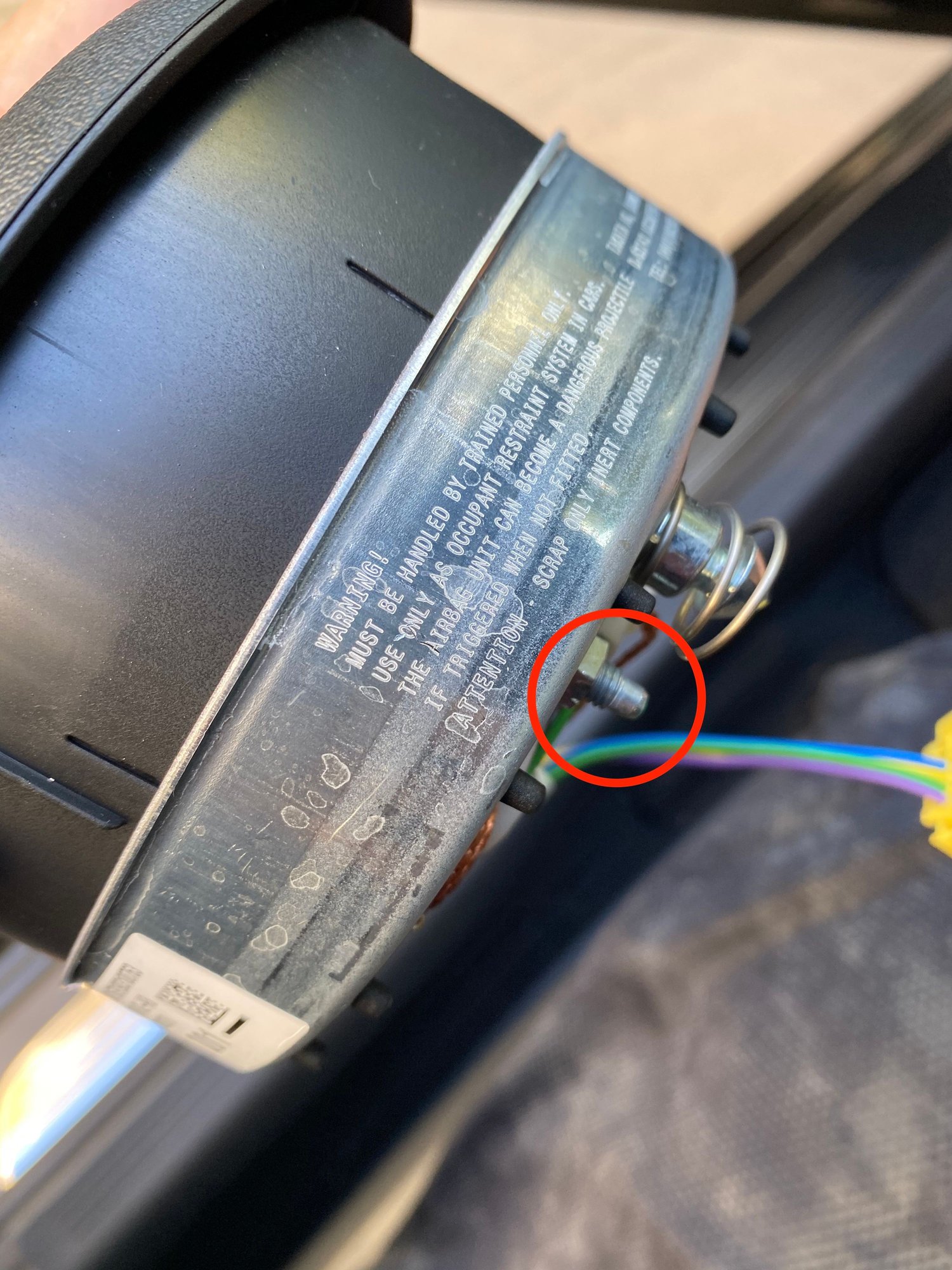

I just got my alcantara steering wheel airbag cover from carbontastic.
Got the airbag off the steering wheel, but I have no idea at all how to get the airbag cover off the airbag??
I don't see any screws to remove. I tried just pulling it apart and it seems really tight on there, didn't seem like it would budge.
I see the black pegs go through to the back, but I wasn't able to push them through the other way.
Any help would be appreciated!

its the 4 metal screws you can clearly see. then pull apart.

These? It's the threaded end. I'd need a wrench.

yes those. Just use a socket on a bit screwdriver
