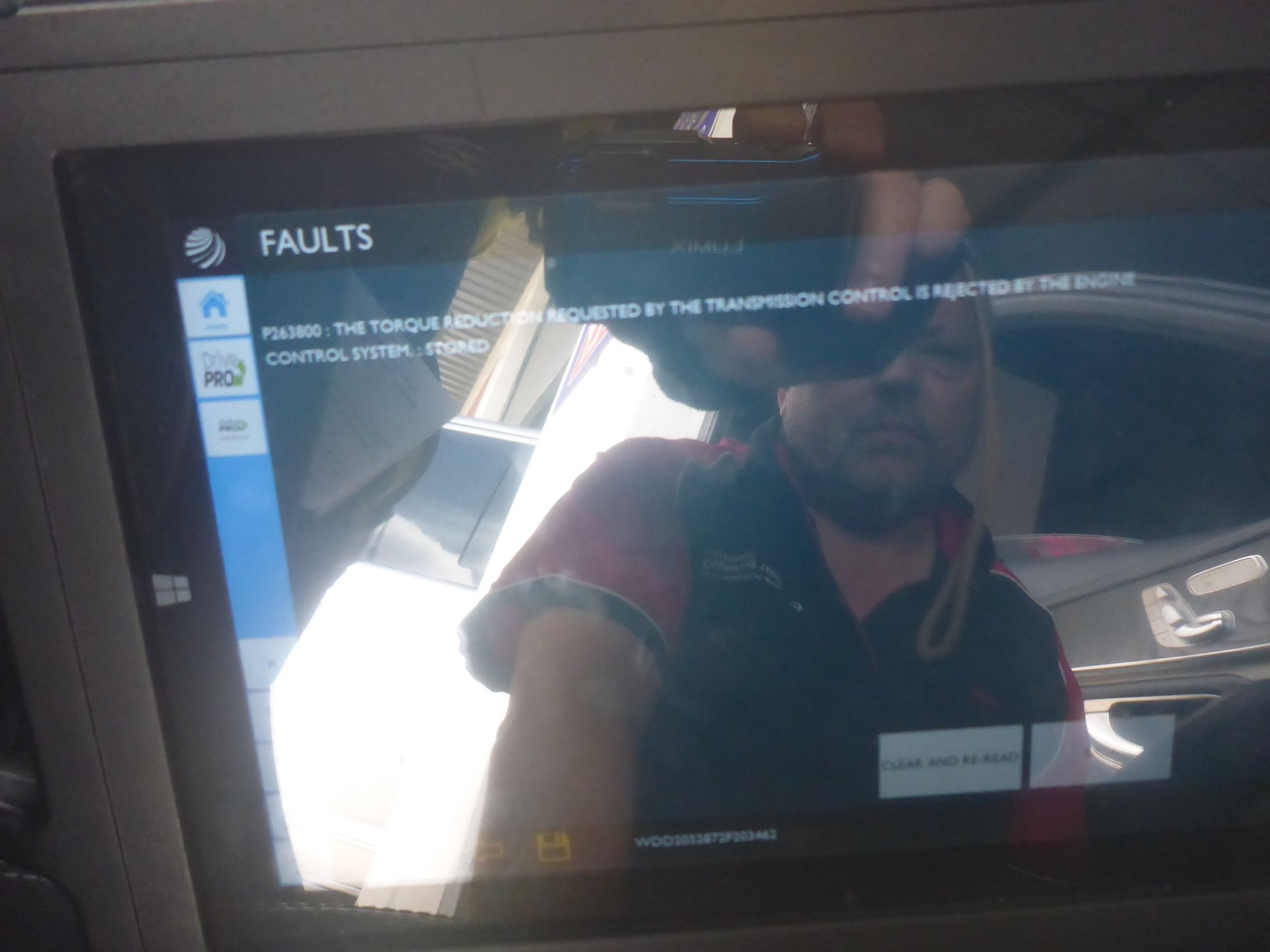

Have to be happy when you see a fault code like this !

Which trans tune are you running?

Have NOT got a TCU Tune.

So you completely removed the TQ limits? If so, are you not concerned about your trans reliability and longevity?

No, not worried. For the extra fun and only 2k for good second hand box.
Do not think the ECU tune would do this. Might be the JB4 and the extra power it's making but tricking the ECU.
Anyway happy about it, less interference the better.

That’s one way to look at it haha 👍
I’m curious what sort of hurdles you had to jump over to remove the TQ limits? Is this something we could do at home or requires expensive flashing tools? You’ve definitely sparked my interest, very curious to know how you managed this, be great if you could share for the community!

The jb4 does not provide accurate tq values to the TCU. This can lead to long term clutch wear and issues. JB4 will under report those tq values.
Really the best way to get it done is via a proper Flash tune that accurately reports proper tq, with a full flash TCU tune, so they can work together
