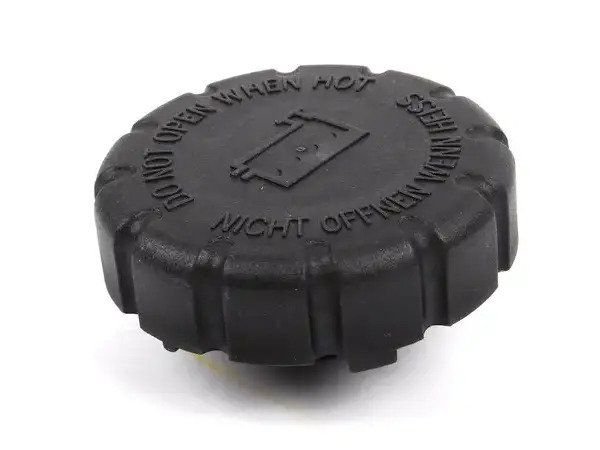

Hey all,
So it looks like I have a leaking coolant reservoir. I just bought this car, just over 100 miles into it now. The cap feels like it's missing a gasket or something when I try and tighten the cap. Just checking to see if the cap should have a rubber gasket or something? It feels "tight" and I don't wanna be the schmuck that brings in his car to see that "I just need to tighten down on it"

The cap should just screw into place without much effort. It won't feel "tight" when you screw it in all the way.
Most people don't realize it, but the reservoir cap is also a valve/vent that bleeds off excess pressure if the pressure within the cooing circuit gets too high. This usually happens if the car is run really hard (temperature gets high) and/or if the coolant level is overfilled. It can also happen if the circuit was not properly bled of any air bubbles after it's been filled.
I'm willing to be that the coolant level was overfilled from the factory or at the dealership. Nothing to worry about at all except for the mess it can make under the hood. You'll still want the dealership to take a look at it to make sure there isn't anything else wrong.

There's a new design cap, old one sucks, new one stops this from happening.
Thanks, I was hoping and half-expecting that this would be the answer. Do you happen to have a part number for the new cap?

Update: went to another dealership, drove up to service and showed them what Chino posted... Tech told me the FL cars already have the newest cap. So he just open the cap a bit since it was still hot, vented some of the coolant, and then rinsed out the engine bay near the radiator. I came back home and new coolant is still seeping out... guess I have to wait for it to boil out some more?

And no one even bothered posting up the part number - what a lazy lot.
For anyone still looking for the coolant cap the part number it's is 2105010615.
