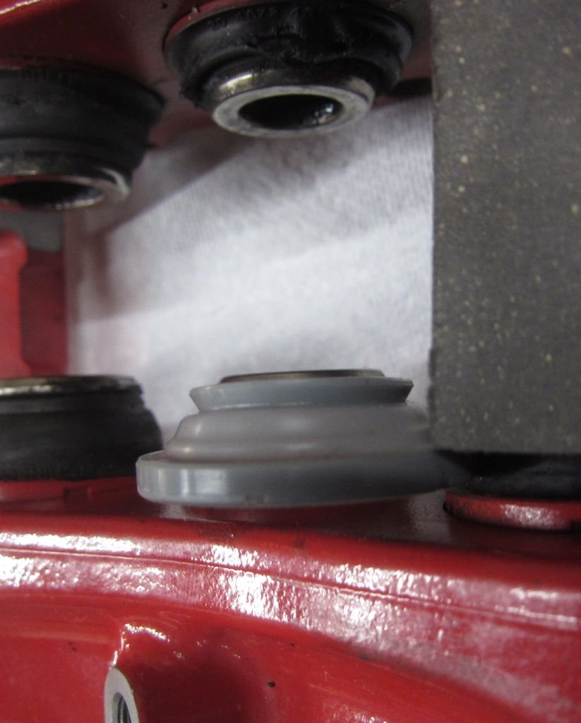

Timely ... I'm in the middle of doing a seal/dust-boot replacement. I did a WIS search and didn't find them so ordered an aftermarket seal/dust-boot kit by Centric. Turns out, it's a garbage product. In desparation, I called my dealer and they've ordered me the kits ... unfortunately they'll have to come from Germany, so I'll miss the last track day of the year. Lesson learned. Turns out there's no WIS job and you need to look in EPC. Lesson learned.
OK, so my car is a C63 S with the U70/red-caliper option (6-piston calipers) so yours are likely different. Regardless, you might want to try another dealer (and stay away from the Centric kits).
For reference, the dust-boot kit for U70/red C63 S calipers is Mercedes part # A 001 421 3186 (see attached screenshot from EPC).
For detail, the Centric seal/dust-boot kit (part # 143.35052) was unacceptable on 2 fronts:
- the Centric boots are "paper thin" (actually, I suspect most paper is thicker)
- the Centric boots won't extend far enough and will be torn (or pop out of it's caliper-surface mounting) when the pads get to their wear limit (see attached picture that has the piston extended to the point of worn pads and you can see that the boot still needs to be longer in order to allow the base to be seated into the caliper ... the worn-out black boots are the originals from the factory, after numerous track days)
