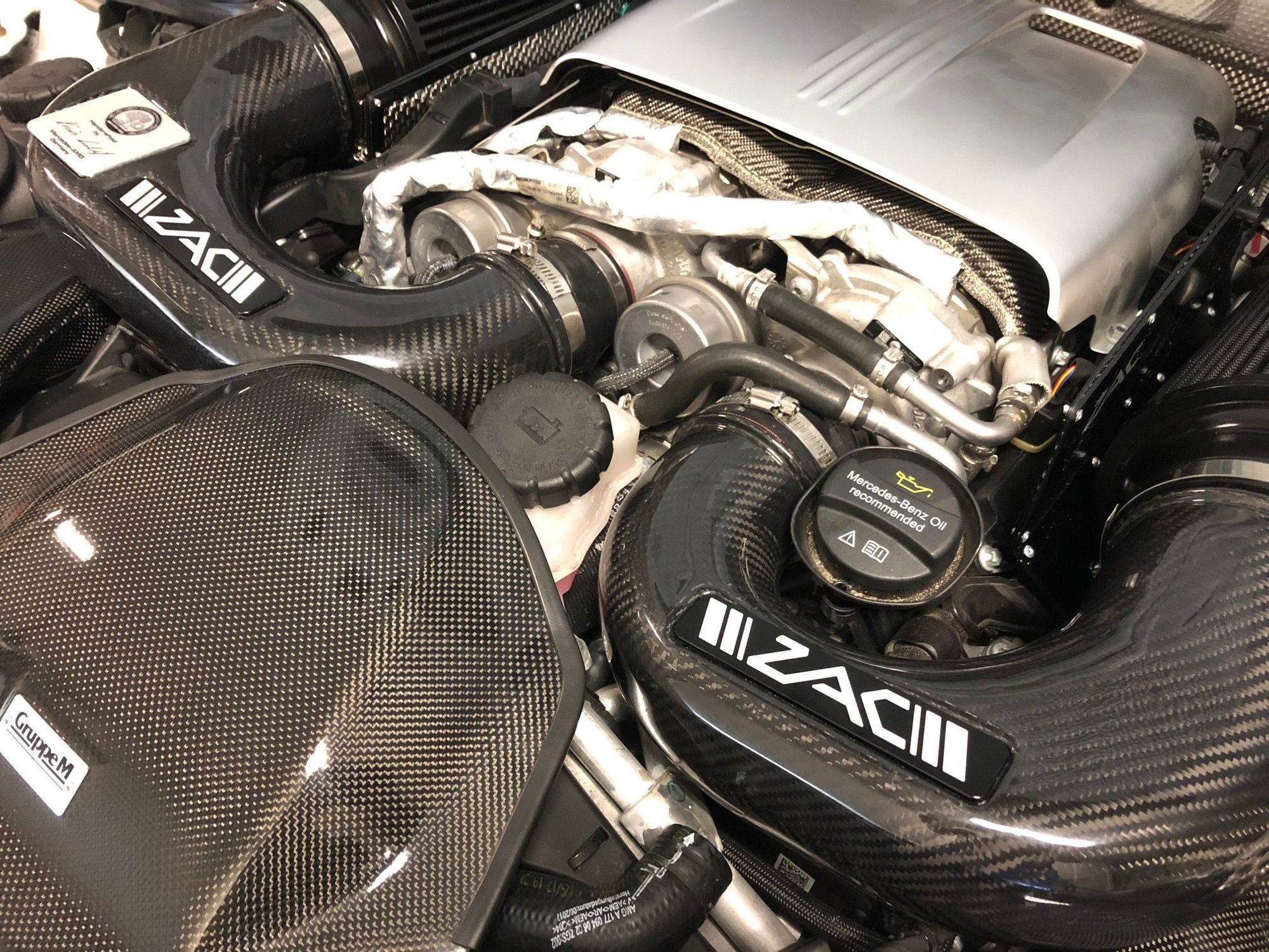

What's the disconnected pipe on the Zack intakes? Is that the recirculation valve? It's connected like stock on the modal.
This is removed completely for BOV VTA. However in this photo it has not been removed. We suggest complete removal.
So you'd get a woosh-tish if it's venting to air.
Yes, that's it. also not recirculating hot air back into the intake.
the ZAC one don't have the option to "recirculate" the air back into the intakes. Not a bad thing though as you get the BOV noise then and to be honest, why blow hot recirculated air back into the turbos... Also, FYI, ZAC intakes do not fit 110% so you will need to make mods to your engine bay and be comfortable with them pressing up under the bonnet. I have numerous chat with Greg from ZAC about this and he gets all defensive and essentially will put the ball back in your court saying they do fit and he has loads of reviews blah blah blah but I know many people who aren't happy with the ZAC ones due to the fitment. They need refining in terms of size and then would be an esy fit...
