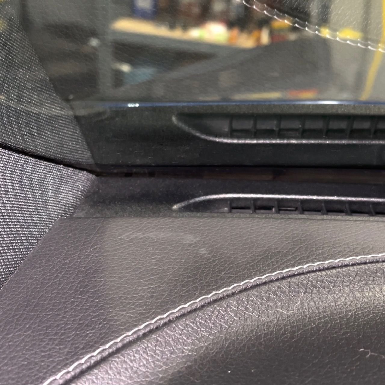

I just had my front windshield replaced and I have to say it's been a bit of a nightmare getting the people that my shop subbed it out with to get things right. They've already had to reinstall it once for using too much adhesive and it sticking to the a-pillar cloth. I'm now noticing that I'm seeing a reflection of my white paint at the very bottom of the window. I'm pretty sure it's because they installed the windshield incorrectly again or they are missing a part. Could anyone check and see if there is any gap at all between their windshield and the defrost vents on their front? I'm able to fit a full finger and go all the way down and touch the exterior paint underneath. I checked on my wife's C43 (yeah, I know, we're weird like that) and there is no gap at all between the plastic of the defrost vent and the windshield.
Thanks in advance everyone.

Examples of what I'm talking about.
My car new glass
wifes car
my car new glass
Wifes car

I've just recently had my windshield replaced also, but my MB dealership to my surprise and delight does this all in-house. They have factory trained glass techs, so they use factory glass and do the install and all the required calibration of the cameras afterwards themselves. There's not supposed to be any gaps and MB actually has a patented way to glue the windshield in to make sure there is a proper seal along the A-pillar. Did you get factory glass or NAGS glass (aftermarket)? It sounds like your windshield is not a proper fit, which is something I've heard can be a problem with NAGS glass. I have a minor issue with the install. I noticed a bubble inside the rain sensor. Doesn't seem to affect its function, but I'm gonna have them fix it next time I take my car in for service. This is not my first windshield replacement on my cars, and in the past I've used glass shops or dealerships that sub out to a glass shops, but I've always requested factory glass and gotten it covered by my insurance all but once. This time was no different. Geico covered the whole thing minus my $100 deductible under my comprehensive coverage. Because it was done at the dealership, though, I had to send in the invoice and get reimburse, but that's worth the quality of the work.
My car new glass
wifes car
my car new glass
Wifes car
Oh, didn't quite get what you were talking about. What body style is your C63 and your wife's C43. The coupes and sedans have different dashes. The coupe dash is higher up and have a different angle to the windshield. In my coupe I can stick a finger in there like in your car's case.

It's aftermarket glass as far as I can tell, but it's also Pilkington so I'd be surprised if it's low quality. Thanks for confirming there should be no gaps, I'm fearful at this point that I'm just going to have to get my money back and take it to the dealership to see if they can unscrew it.

Many folks including insurance companies claim that aftermarket glass is the same glass just w/o the logo. That's simply not true in my experience. Not saying the quality is necessarily bad, but it's not the same glass. The factory glass is Saint Gobain Sekurit and the Germans use acoustic glass these days, which has a special noise insulating layer inside the windshield. My understanding is the aftermarket glass doesn't have that. So your reflections can be a result of the difference in the glass between Pilkington and Saint Gobain and the difference in the laminates used.

Post pic comparison of the exterior view of windshield base of both cars. Assuming both new and old glass are the same thickness, would appear differently no?
If the new glass was thinner it might appear to be installed similar as old glass on exterior but explain discrepancy inside.
Do you know for fact that your wife's car winshield is OEM and never replaced? (if bought used)

Yup, the glass is original to the car.
