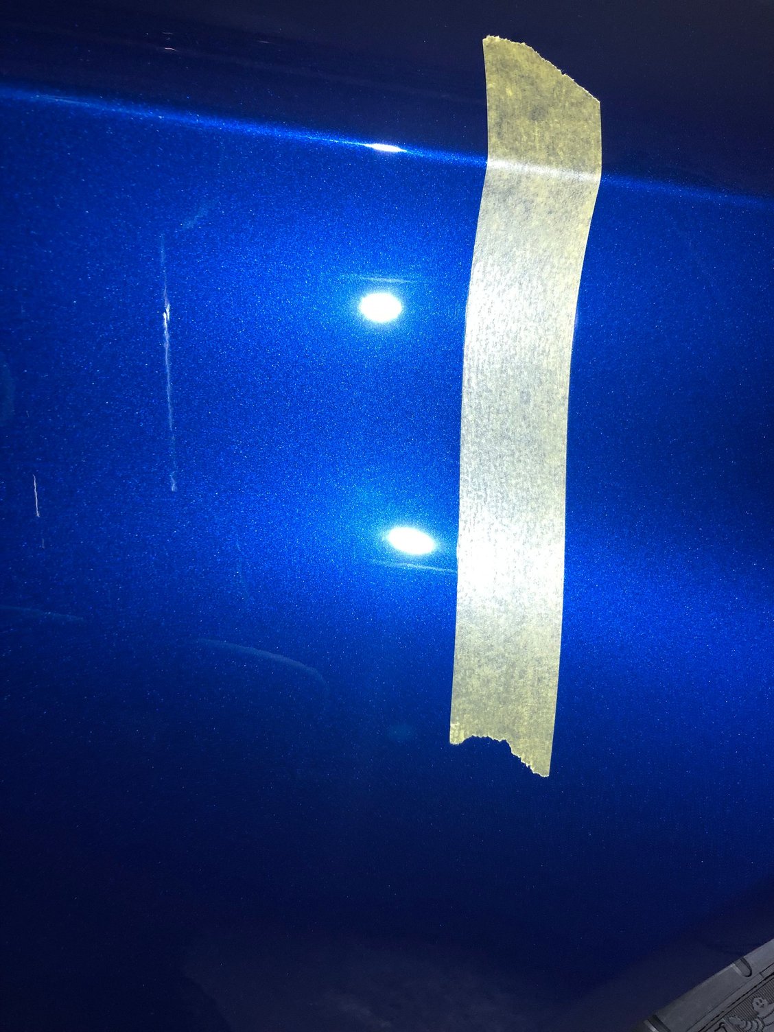

I had my 2019 C63s coupe with about 5,000 miles ( Iridium Silver in pristine condition) installed with XPEL by an authorized dealer.
Soon after the install I noticed many blemishes and distortions throughout the hood and front fenders. (below photos). This occured only while wearing polarized sunglasses and on sunny days. Take the sunglasses off and everything looked fine. I drove over to the XPEL installer who stated he was unaware of this. But once he put on polarized sunglasses he saw the blemishes and distortions. He realized re-doing was not going to correct it. On the XPEL site under FAQ, last question it explains it common to see these distortions/blemishes with polarized sunglasses. For me, this was something that bothered me, did not want to see it and was the beginning of the end for my XPEL install.
On my 3rd return visit to installer for dirt/grime finding its
way under the seams, peeling under a headlight and need to rent a car again, I decided to have him remove it all. I never filed a case with XPEL and the installer removed it at no cost.
The installer was always willling to make corrections but my mind was made up.
Almost 1 year later been lucky no chips. I'm glad I had it removed.
So if you wear polarized sunglasses these distortions/blemishes as noted by XPEL may be something to consider.
On the other hand having a black car I would really consider having it done and only by a very qualified XPEL installer.

Wanted to add one thing I forgot to mention. The pics two posts above shows an example of a poor install, IMO. Most XPEL installers just use the templates from XPEL. The problem with those is they don't wrap the panel edges, so the film stops short of the edges and dirt etc. can get under it. You can ask them to customize the templates for a proper fit and wrapped edges. This is what I did. It makes it more expensive of course, but you are unlikely to have issues with the film in the future. This is why I paid $4000 for the job and it took them 3 days to properly do it. You do get what you pay for in this business. BTW, my install also wrapped the rear diffuser and all the carbon fiber and glossy parts around the car. I have the Aero package, which adds some complicated shapes to the front and rear lower parts of the car. As for the artifacts with polarized sunglasses, I realize that XPEL mentions it as normal on their website, but I don't have any. Maybe it's an issue on lighter color cars, but you can't tell that there is film on any of my panels of my Obsidian black coupe with or without polarized sunglasses. I'm a big fan of polarized sunglasses and wear them all the time. It's the reason I didn't opt for the HUD for example. I know these artifacts are an issue on matte paints, but I've honestly never seen this on glossy paint.

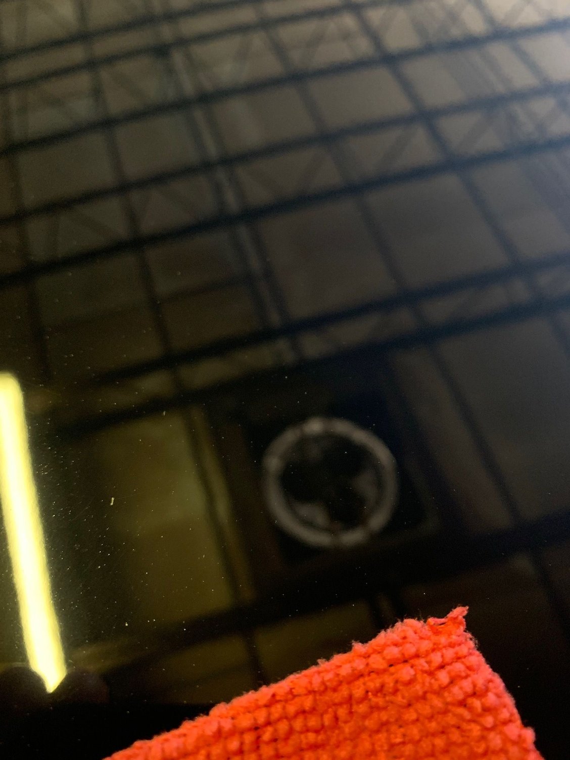

I have 20k on my black car now - the front end is destroyed. It looks like it was sand blasted. This picture is up on the hood - look near the light source reflection (the entire hood looks like this but hides itself). My car is non metallic and this is after a full correction.
Now, it's even worse on the front bumper that has a horizontal plane to the incoming damage.
