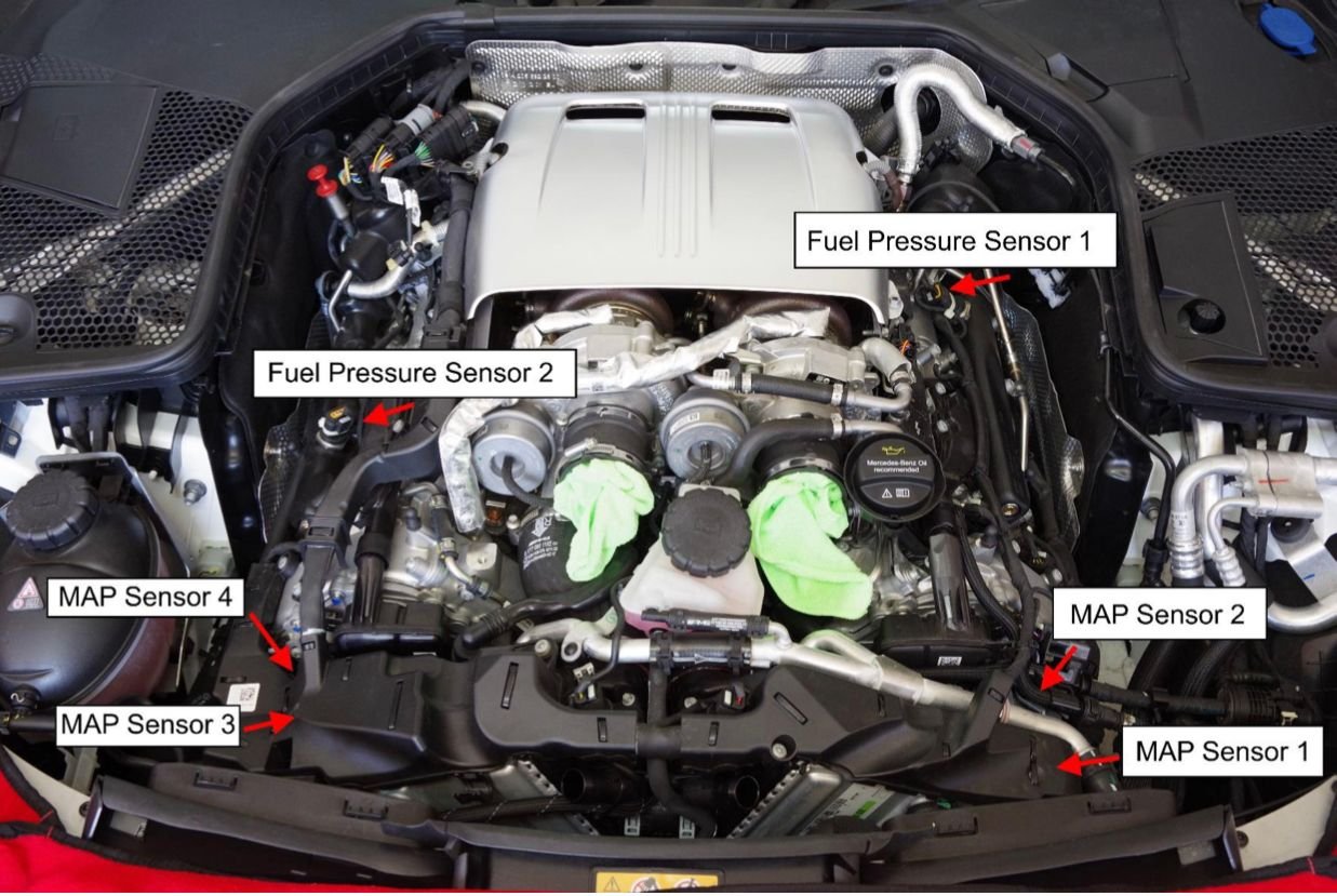

I think I’ve located the MAP sensors
if I were to follow instructions on the CRC chemicals(spray past the sensors) it means I need to take of the air filter housing and spray directly in to the turbos
Am i right?

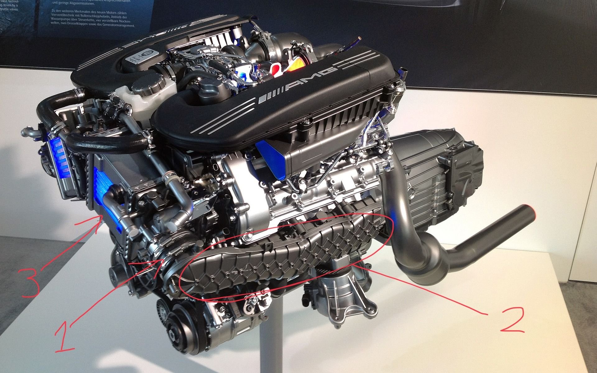

Ok I’ve done some more research and it’s harder than I thought
the turbos are located after the air filter intake but it won’t help to spray there cuz after the MAP sensor the air goes through intercoolers before entering the intakemanifold
Enclosed pic I have marked intercooler as #3 and the intakemanifold as #2. I need to spray the chemicals at the arrow marked #1 which is located very low in the engine bay with a lot of things to remove

I think your diagram is correct on where you need to spray the cleaner (arrow 1 on the picture with engine) but from the looks of it you don't need to remove anything but just loosen the clips enough to stick the straw in to spray.
I think you're right but its hard to get to. Very tight and low down in the engine bay

Should be able to get in a vac hose somewhere, the map sensor should be after the intercooler, I would have thought. Didn't know the M177 had 4, are you sure the others aren't boost pressure sensors?
