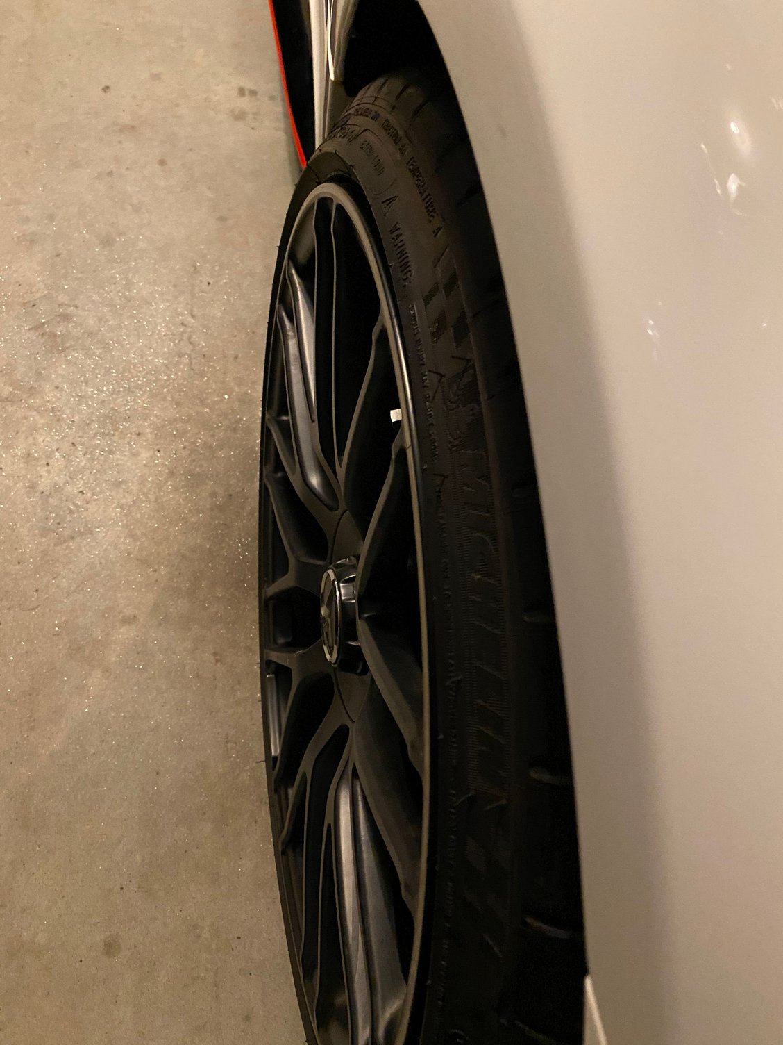

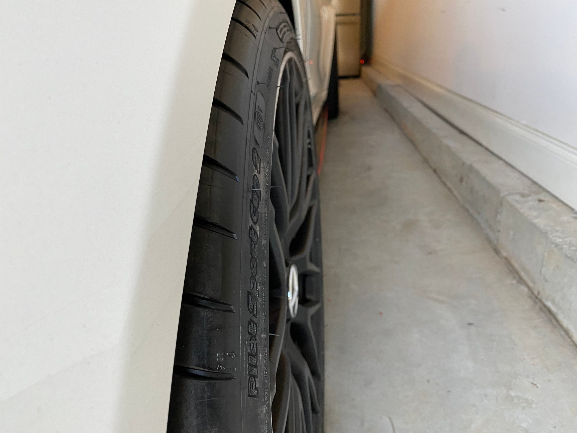

Installed Michelin Cup 2’s
Just showing you guys the pictures of the rear tires. They are both exactly the same factory size. Cup 2’s run wider and actually look better.
Pilot super sports
Pilot Cup 2

Sure looks a lot different but part of it maybe optical illusion (?) as the PSS have that rim protector and the cup 2's don't (its much smaller).

Definitely not optical illusion. Looking at actual specs, cup2’s are wider in MB spec.

According to Tire Rack, the Cup 2 has about .5" wider tread width, however, they look more stretched in your picture, not wider. The wider part is the extra rim protection that the Cup 2 and PS4S have. Here's a pic of my PS4S for comparison. They also stretch less than the Cup 2. You sure they are the same size?

Top picture is clearly more stretched than the bottom. To me, cup 2’s seems less stretchered than your PS4s? Are you on stock size?

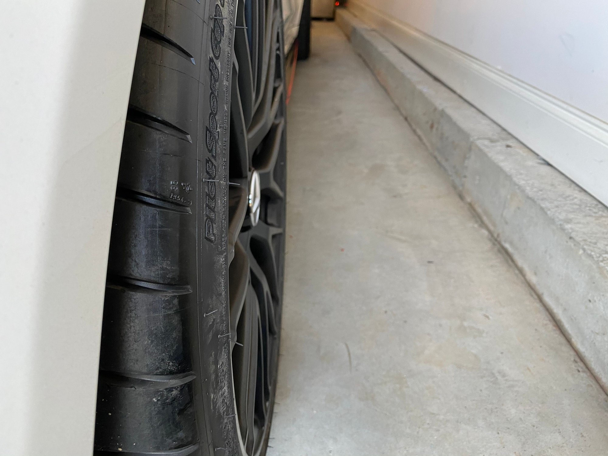

More angles on Cup 2’s.

Oh never mind. I lopsided the picture labels. Didn't realize your top picture was the PSS. Yes, you are right, the PSS is far more stretched, so now it makes sense. Yep, the PS4S would be a bit more stretched. The PS4S has 9.9" tread width and the Cup 2 has 10.5". So the Cup 2 is the same width as the wheels and therefore will be square pretty much. Interesting thing is the PSS has a tread with of 10", but it looks far more stretched on the wheel than the PS4S. A little bit of stretch stiffens the sidewall around corners. Basically makes the tire less likely to roll over the sides and improve handling.

Agreed about the little bit of stretch. PSS’s are a little too stretched IMO.

Excellent demonstration how different tyres are not produced to precise sizes , there is manipulation !
To some this is like telling them that the world is a flat disk .
Also happens to the aspect ratio too so throws out those online calculators .
