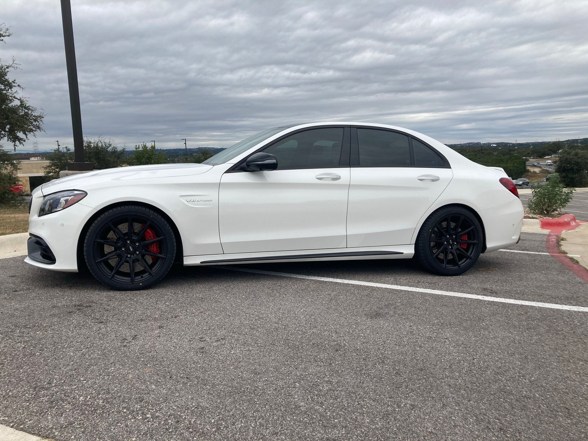

Welcome to the forums and congratulations on your new C63S AMG! The "perfect" wheel fitment is going to vary depending on who you ask. A perfect fitment for us means a fitment that looks good but also adds performance to your car without having to make any sacrificed or modifications to make it work. For the C63S Coupe we have found that the best fitment in our opinion is: 20"x10" || 20"x11.5" using 265/30/20 and 305/25/20 tires. I have included photos our client's C63S below with that same setup. Please feel free to reach out to me directly for more help David@WheelsBoutique.com.
does these rim and tire specs work on the sedan. And would it require spacers etc??
no, sedan can’t fit those. A similar looking fit on sedan is 20x9.5 +35 and 20x10.5 + 57 on 265 and 285 tires.
These HRE P103's are custom built to order so they can fit on the W205 C63S Sedan however the Sedan would use different specs than the Coupe above. If you like the flush fitment that we did on the Coupe we can do the same for your Sedan. No spacers are needed, the wheels would already be built to the correct specs.
