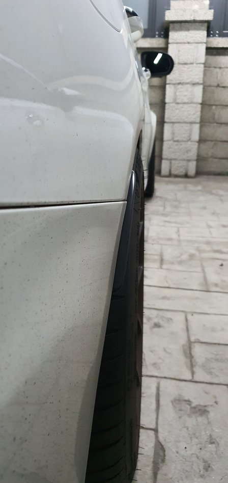

Not an expert but I don't think a +22 front will work and definitely won't work on the rear.
I currently run 19x9.5 +35 front but others have gone to +30 and rear is 19x10.5 +54 and it's pretty flush with the fender.
Also lowered on eibachs.
second that - offsets are too small. 32-35 in front and 54-57 in rear for these spec wheels make a nice fitment. For bore you can buy hub-centric adapter rings.

Not sure about coupe but sedan with the black/silver multispoke is 19x8.5 +38 front and 19x9.5 +56 rear
