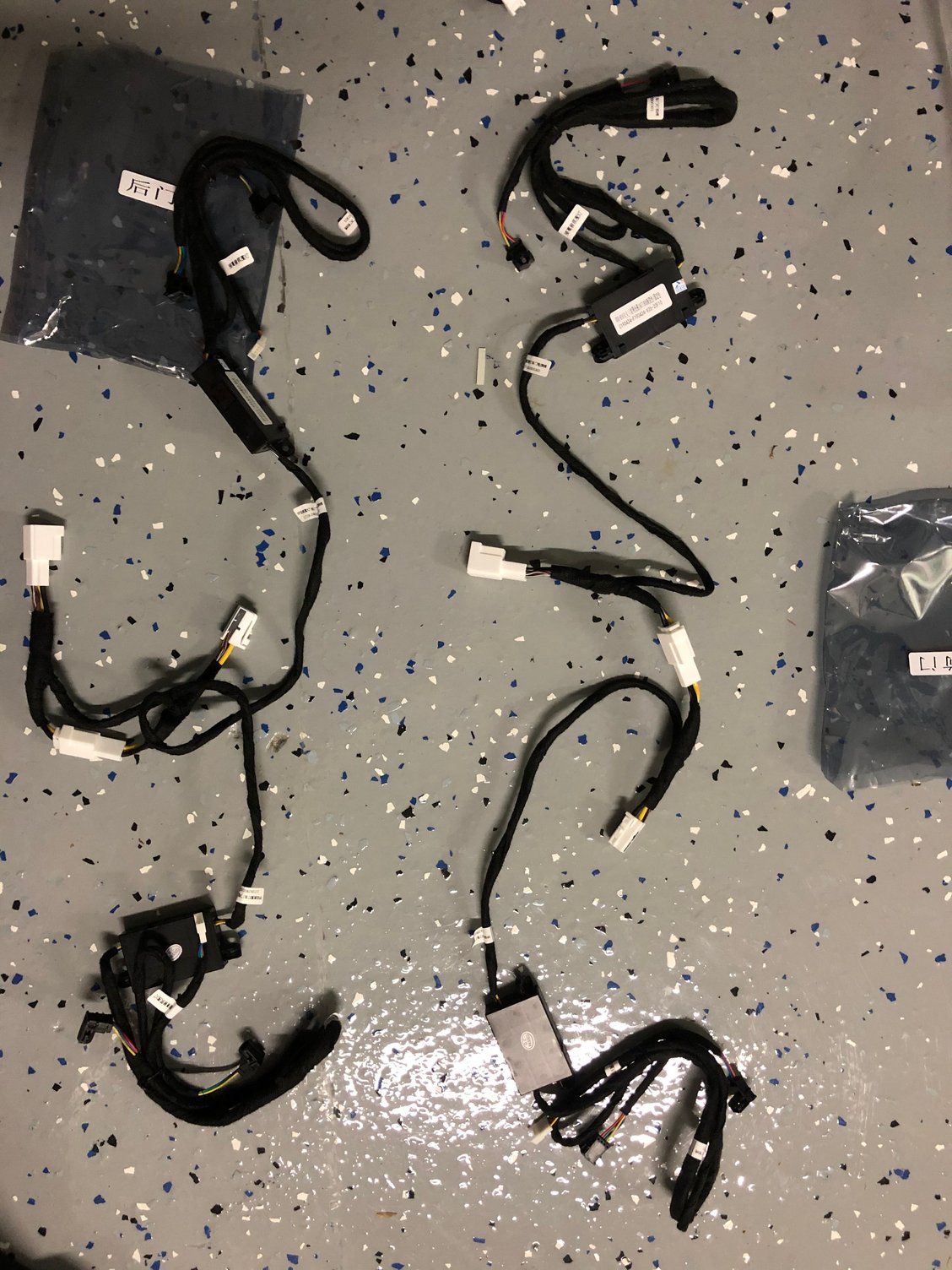

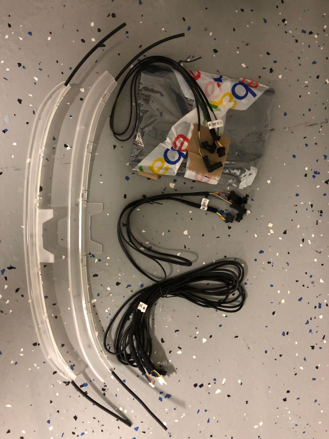

Thanks. I did find this video since my post but my kit is different, It does not install directly to ODB but to power and has an ODB dongle. Also came with 4 doors, middle console, and footwell, and than this set shown below, which I have no idea where it might go to.Another footwell type strip?
Also, I got two door cables with connectors for all 4 doors ...which maybe front and rear connected for packing only?

Well, I figured out a little bit. The extra plastic light rails and tubes are rear, under seat lights. I also figured out it connects to can bus...now I need to figure out where as this kit has multiple. Also, seems I have more light connectors than light tubes on each harness...I assume they replace the OEM light plugs...not sure. Just a whole lot of connectors. But I don't need to go under carpet, door jams, or door harnesses...just need to figure out where all those "plug and play" connectors go...and there are a lot.

Update to my own thread - was lucky and finally got in touch with seller and I think I am good to go to give it a try to install. Seller was very helpful after all. Looks the install of my set, which seems to be a newer version does not require permanent connection to ODB but power/ground and can bus with a ODB programmer only. Than the 'pins' are gone to make a connection through door - I am happy about that, seemed to be a pain in earlier versions. The additional lightbars are indeed for rear underseat but supposedly dont fit the performance seats. So, will see how it goes, Carplay goes in at the same time. Thanks for helping out.

By the way the the tube is for back of the seats, not under.
yes unfortunately performance seat will not fit.
