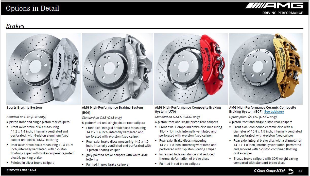

If I need the front rotor to be replaced will these FCP Black Series rotor Brembo have a different look/appearance than my rear OEM rotors?
Yes, but the S rotors already do. The rear rotors on the C63S are the same as on the C63. They are one piece rotors. The S has composite two piece front rotors that look different than the rear rotors. So replacing them with the Brembos isn't gonna make it any different. I personally think the Brembos look more the business.
FWIW, here's a comparison. The rear rotors are a smaller version of the C63 front rotors for reference.
An the Brembo I posted already in the other thread. Like the CCBs, they are full-floating, so you have the array of springs around the hat.
