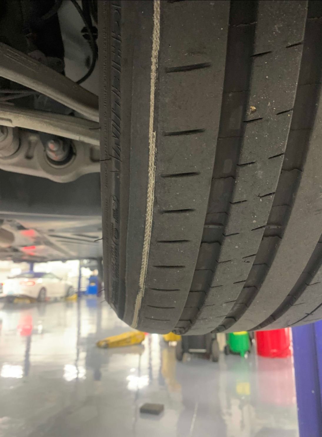

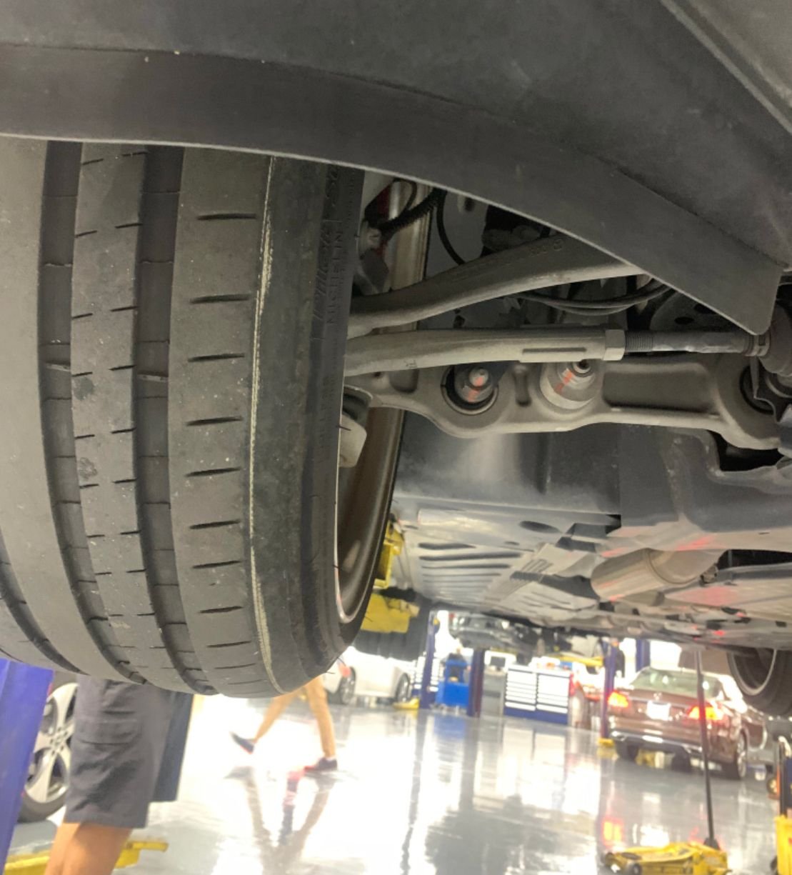

Front tires 8 months old and 7k miles after lowering...not easily visible when inspecting w/o taking on lift. Just got new P4S today and K-Mac front camber and caster kit next.
I also found that my KW HAS kit settled quite a bit since install 8 months ago. Looks great and drives great but a bit too low now that I may rub when cornering or under load.
Sooo, I was wrong...did not see that excessive edge wear until now. Rears are like new.

Yeah, I was kind of lucky - found it during 5k oil service at dealer and a few other maintenance work. While the car was there (3 weeks to wait for parts) I took the loaner on a 800mile trip, which I otherwise would have taken my car...glad I did not.
Yes, was "aligned" after I lowered it 8 months ago but can't align it properly w/o the camber kit.

About what? That the tires wear so heavy on edge is my doing...lowering the car and having no camber adjustment are not a good mix. Even the stock setup already eats tires more than you normal family cruiser.

You can check the inside of the tires by fully turning the wheels to one direction. Also a way I prolong my tires is buy getting directional tires and when you start to see inside wear, just remount and balance the front tires on the opposite wheels on same axle so the outer shoulder becomes the inner shoulder. My poor mans hack to "double" tire life.

I did just that but still did not see it...I guess I was not looking hard enough as it's just the very outer edge.

Our cars don't come with camber adjustment...just toe. Therefore the need to install an aftermarket kit to allow that.

13k is pretty typical for our cars on stock suspension. They already have some negative camber from factory for handling. Just when lowered it gets a bit too much, apparently. You can see my tires riding just on the inner edge and barely used any of the rest. So not much contact with street anymore.
