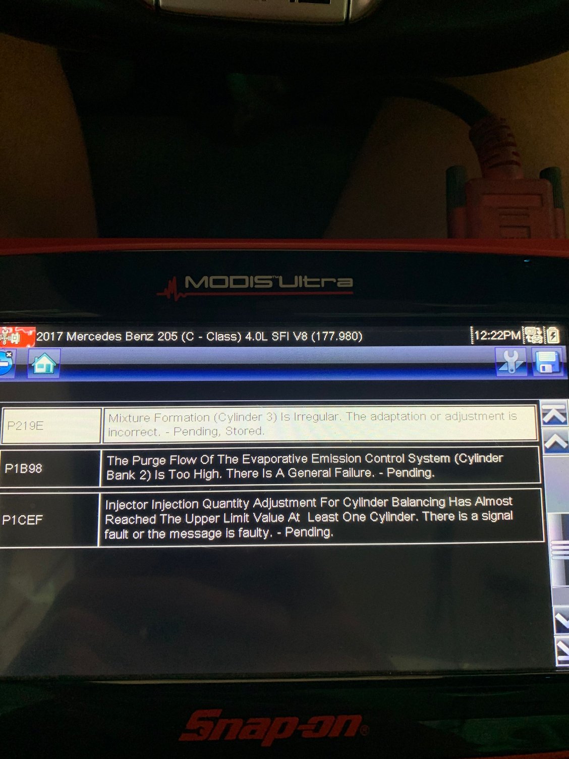

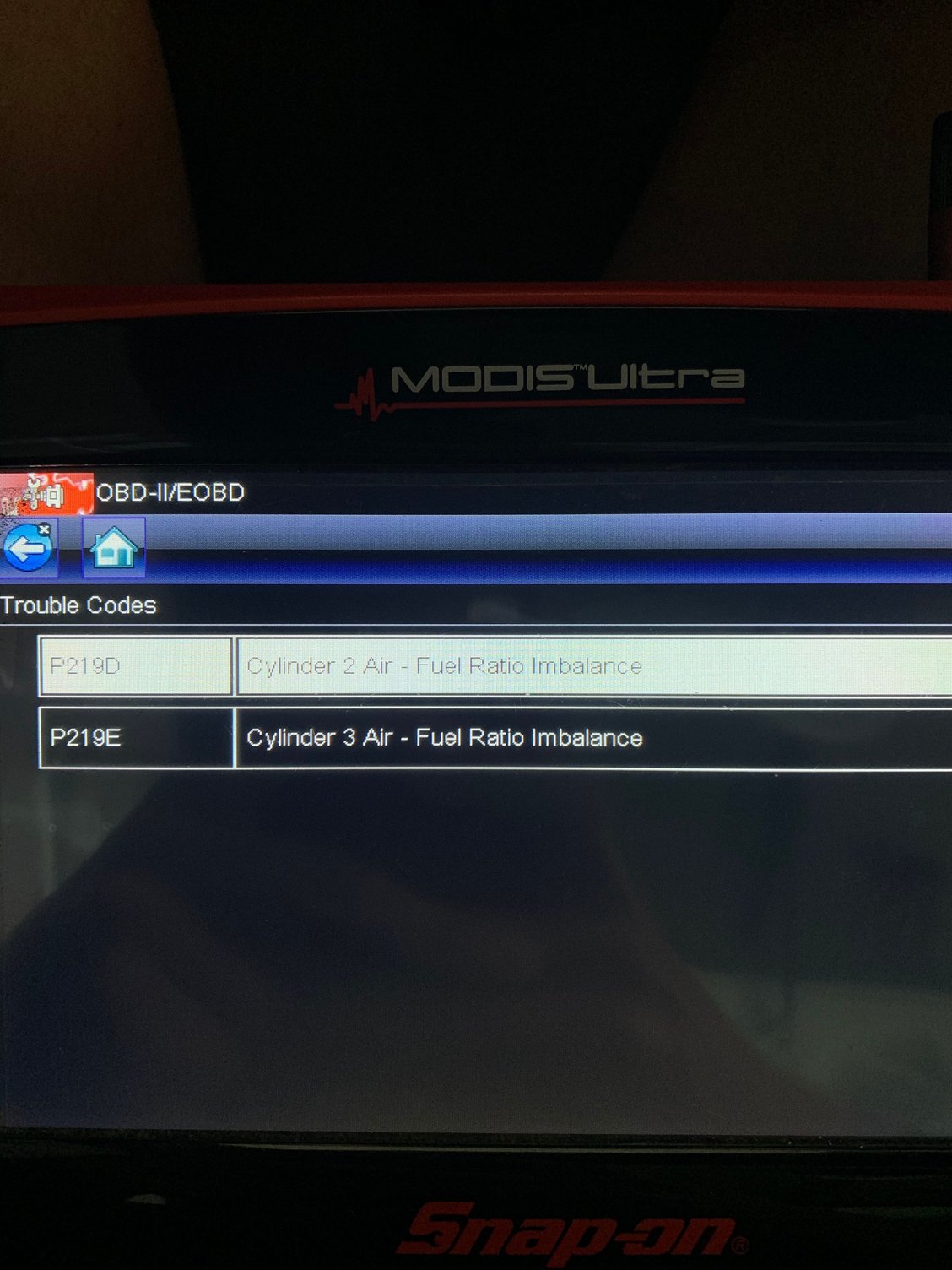

HELP!! Has anyone ever received these codes or have any idea what would cause them ?
Well after noticing a slight vibration on acceleration a few times I finally received a check engine light. Here’s what the scanner picked up. I’m totally lost lol anyone ever get these ?
Mercedes OBD read
Generic obd read

It sounds like it may be related to overfilling. Did you possibly over fill the gas tank before you got this message? If you clear them do the codes stay gone?

No it was at a half tank. I thought I possibly had a misfire and was expecting a misfire code. These have me babbled.

Your air/fuel ratio is off, so either the engine isn't getting enough air or not enough fuel, or too much fuel, or a sensor is reading incorrectly. Googling some common causes brought up the following. I suppose I would add faulty injectors to that list.
  • Inadequate engine compression
  • Defective oxygen sensor/s
  • Faulty CKP or CMP sensor
  • Burnt, chafed, broken, or disconnected wiring and/or connectors
  • A faulty mass air flow or manifold air pressure sensor
  • Bad fuel pump or clogged fuel filter

appreciate it. Looks like I’m going to have bite the bullet and take it to a specialist.
