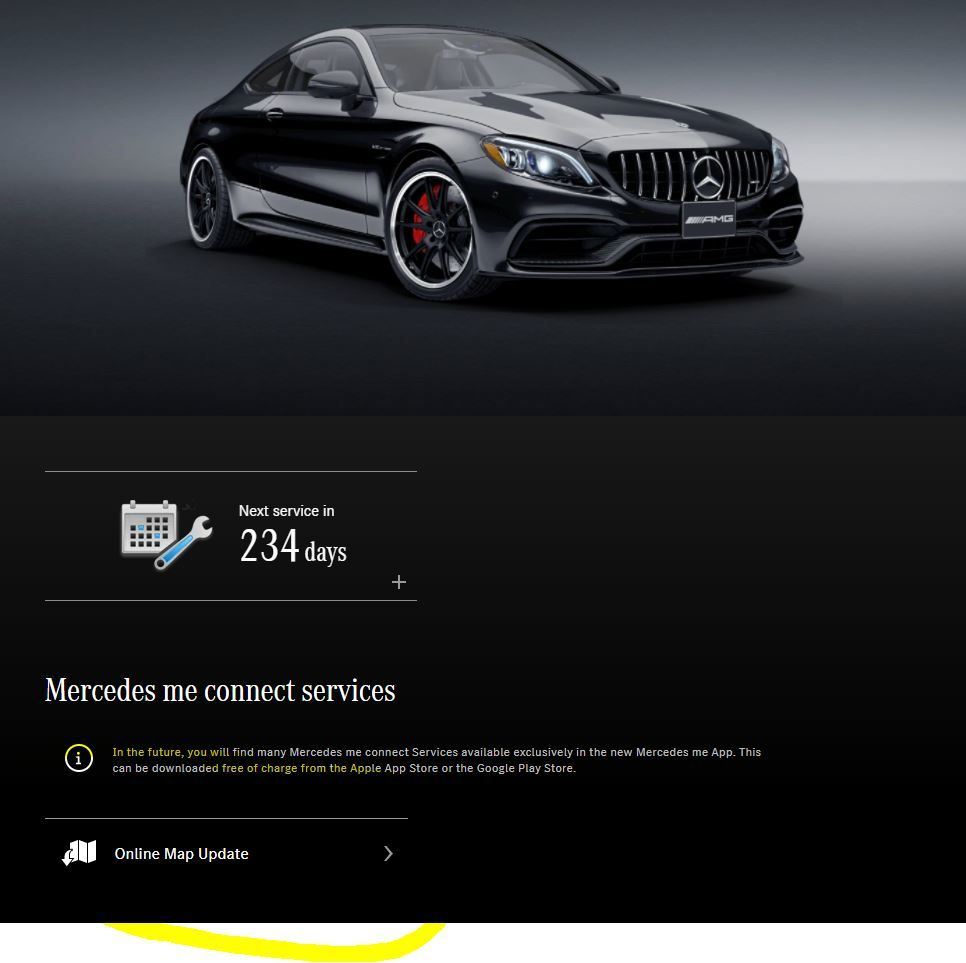

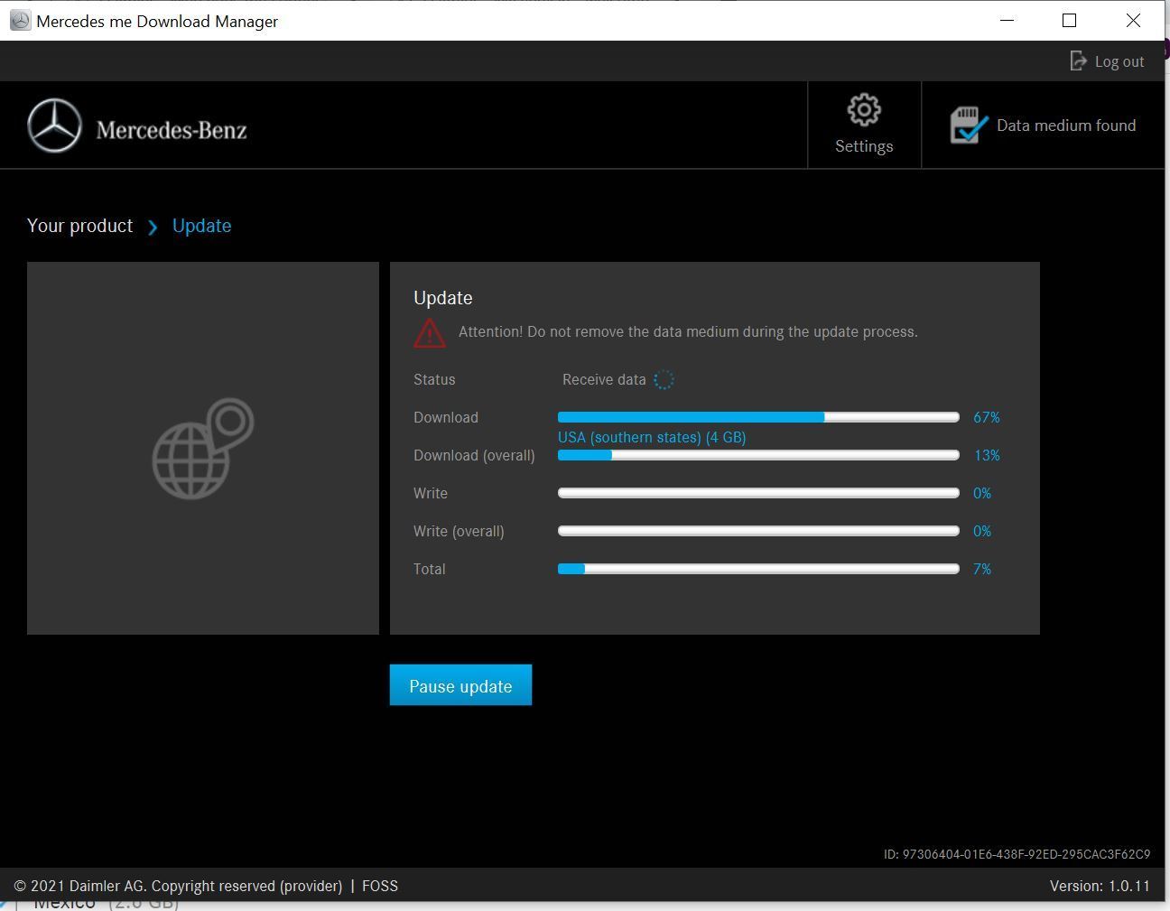

I just learned something -- when you view your vehicle in the Mercedes Me Connect portal / map updates -- you can clearly see that the vehicle only performs an over the air map update of ONE region only. To update all of the regions you have to do a manual update (SD card map data download from the Mercedes download manager then transfer the SD card to you car). I'm in the process of doing this now - all of my map versions have updates available Hope it goes smoothly!
Here are some screen shots and below these I've attached the Mercedes map update user guide .pdf

My next question is -- can I use the same map update SD card in both vehicles or is it somehow tied to the VIN and I need to do a separate download for the C43? hmmmm
No time to try the C43 with the same update card, however the complete version 21 update on the C63 went perfectly - no issues.

I'm actually in the process of downloading to the 43 as I type this response
and done!

Just go to http://me.mercedes-benz.com, then Manage Services and then Online Map Update. The site looks different now. It was redesigned since this thread started. If there's an available map update for your car it'll give you an option to only update your home region or do a full map update. Click on which one you want and follow the instructions. If you don't have the download manager installed already, it'll give you an option to install it. You need to insert a compatible storage medium such as an SD card or USB stick, otherwise the download manager won't start downloading it. A common issue is if the medium was partitioned using the GPT scheme (GUID Partition Table), which increasingly new SD cards etc. are. You'll have to make sure it's partitioned using the MBR scheme (Master Boot Record).
