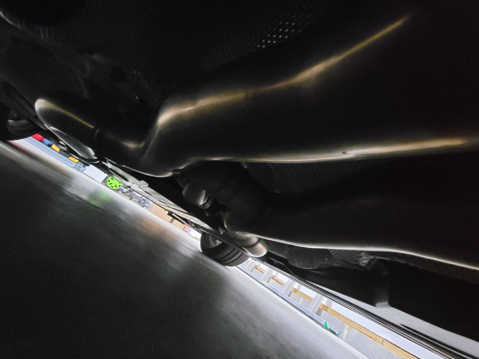

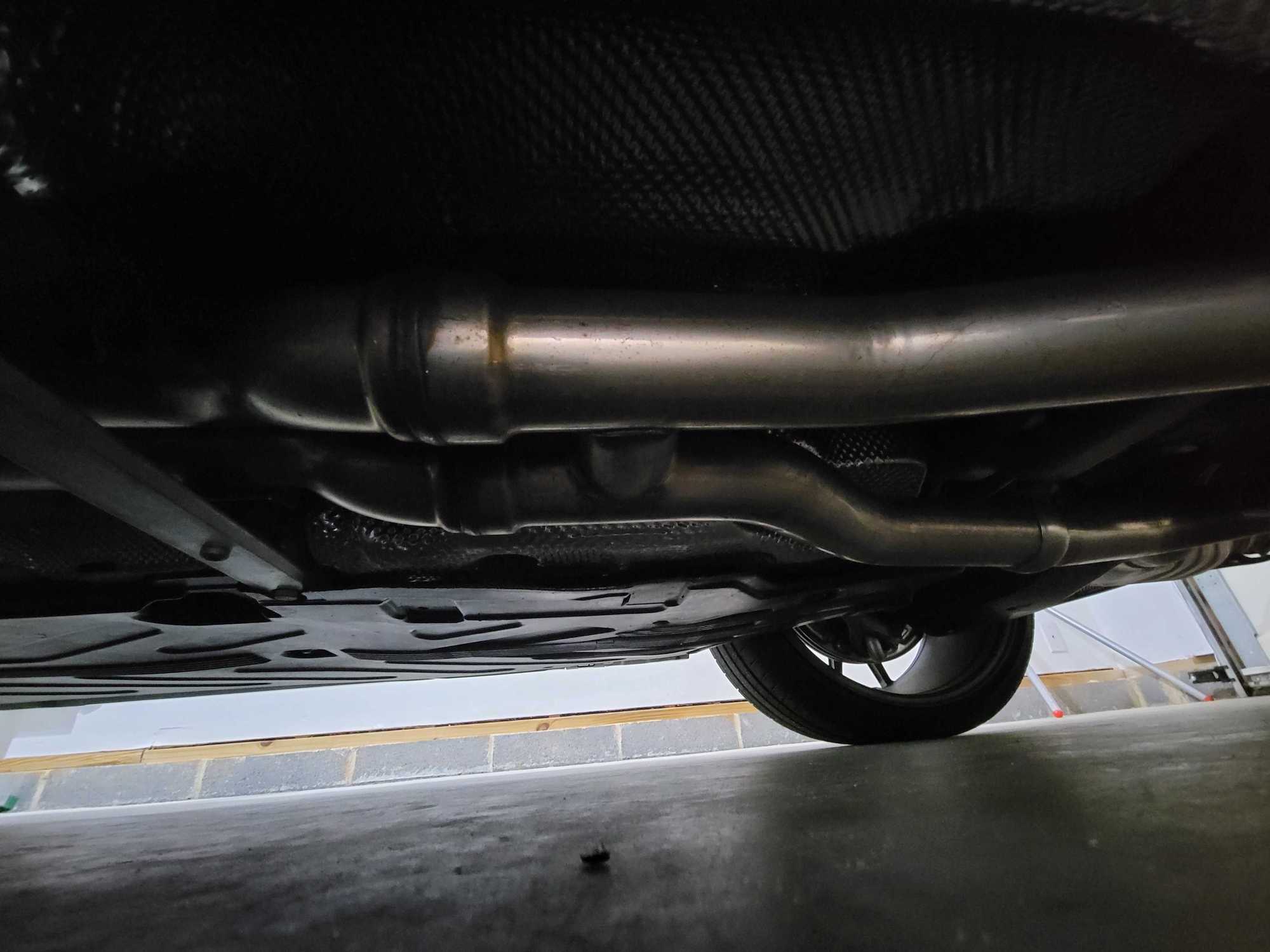

I don't have a lift and I don't quite fit under there - but here are some reach under shots of my 2021 C63S, hopefully they help (AMG performance exhaust)

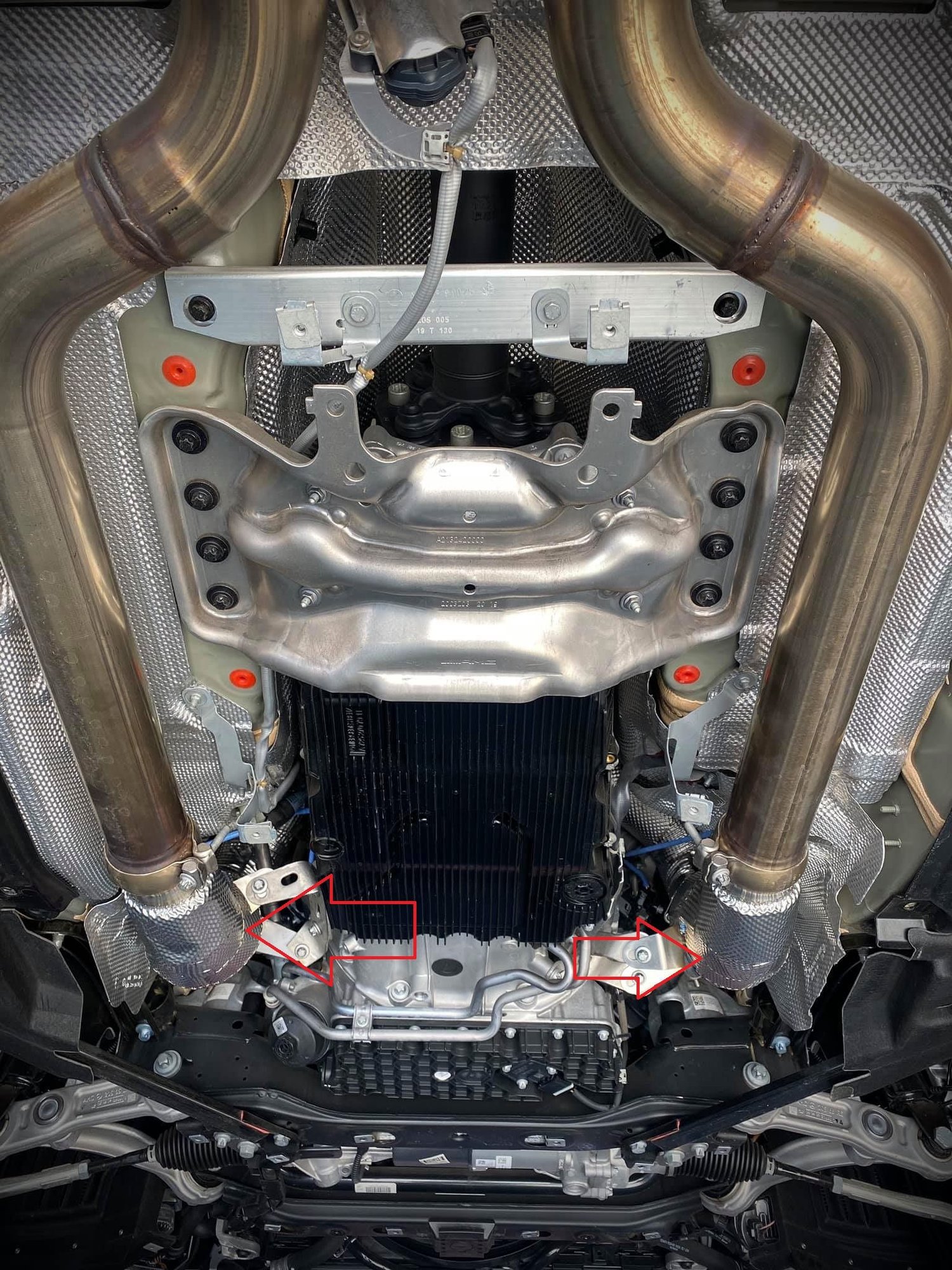

This is my car with aftermarket downpipe.
The place with brackets where you start notice pipe going up is where factory secondary cats are located.

Well then my pics are worthless!

Wow, thanks guys mine look exactly like this and I was thinking the previous owner removed them. So the 2020's or the W205's everything is pushed more towards the front it seems. I will take some pics of mine today...

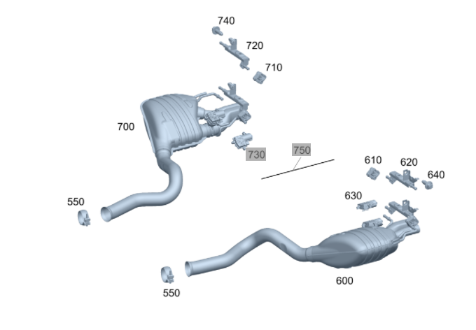

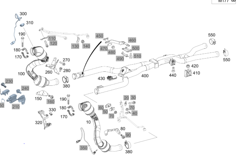

I called the dealer and for my VIN they sent me the schematic

The schematic is correct, the primary and secondary catalytic converters are both attached to the downpipe, which is one long piece. There is a lot of plastic covering this area so it's not very easy to spot.
