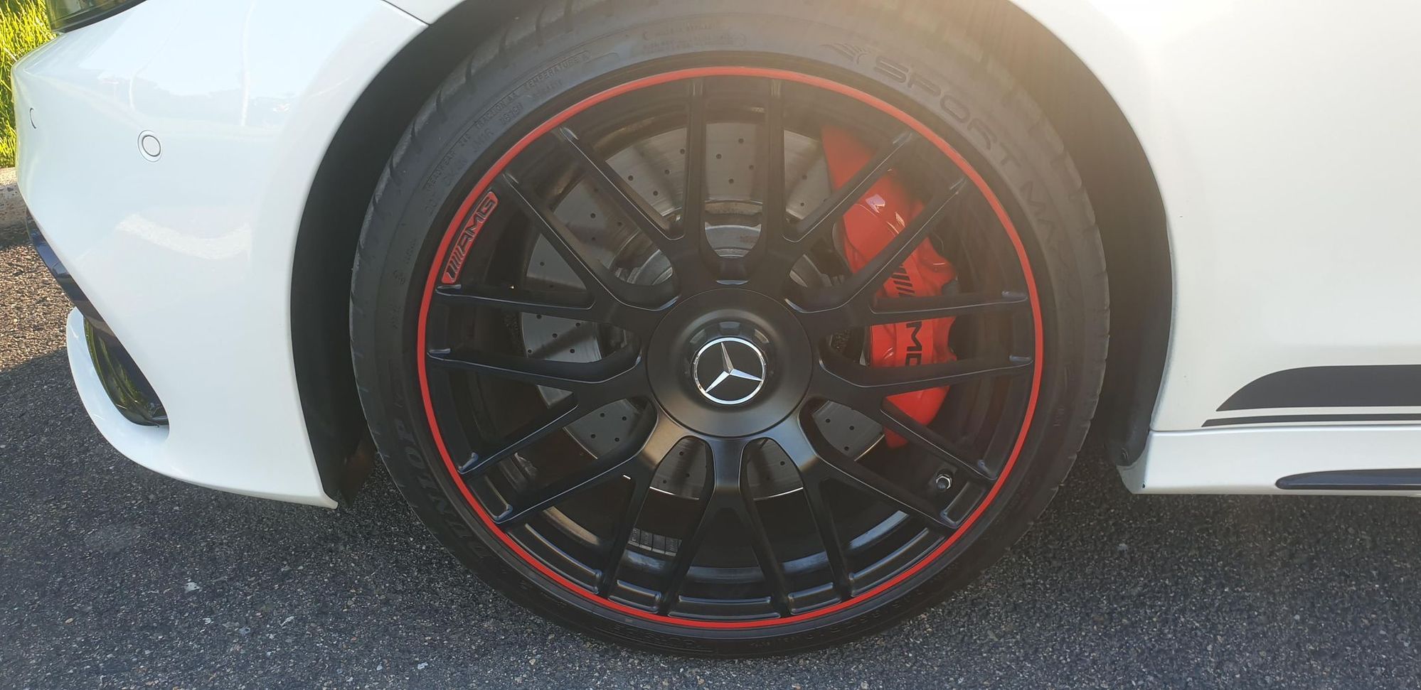

I'm looking to reduce some unsprung weight and my OE rotors are looking a little worn (at least that's what I tell my wife). I wanted to go with the 2PC Brembos, but I'm having trouble finding the matching rears. Anyone know if they are available anywhere? Can't get a clear answer from FCP Euro
Brembo
If the Brembo's are not available for the rears, any similar options that won't break the bank?
