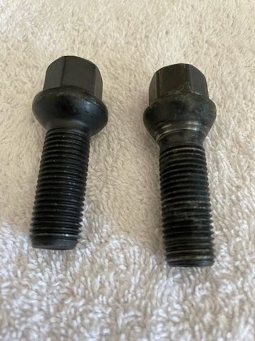

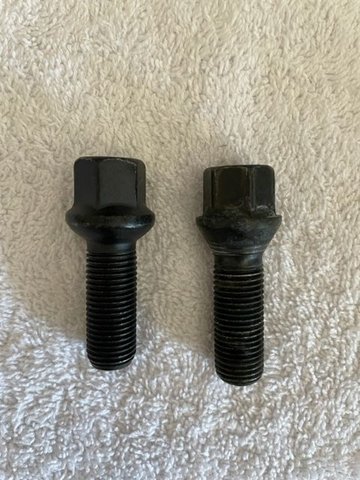

Long story short I'm swapping spacers on my rear wheels (going from 15mm to 5mm), and as such bought corresponding length wheel bolts to put on. According to ECS and another source, we needed a round type bolt (left in both pics). However, when I took off an existing bolt, it looks like whoever had put on the previous spacers used a tapered bolt.
Can someone confirm which is the right one? I'm also slightly troubled that these 2 are the same length, so whoever put the spacers on didn't bother to put extended ones on. Obviously this car has been driven quite a bit on the existing setup but now I'm wondering if I need to swap the front bolts also (12mm up front I believe).

The ball seat lug bolts on the left are the correct type. I’m glad nothing catastrophic occurred while you were driving on both an incorrect bolt seat and length.

I am on OEM 10 spoke forged wheels. Does anyone know what the length is on OEM bolts?

with that said, can anyone help me confirm if their OEM bolts (from the factory) are the same shank length front and back? and what that length is? i have read in a couple w204 posts they're 27mm, don't know if that's the same for the newer gen.
i don't have the benefit of checking myself, as some asshat before me put tapered bolts, of the same length, on all 4 corners.
thanks in advance.

Ball seat bolts are required for OEM wheels. OEM bolts have a 27 mm shank which is the distance between the end of the seat and end of the bolt (you're basically excluding the head of the bolt). M14x1.5 bolts require 7.5 turns for proper engagement.

Thanks for confirming what I had heard. Based on that and my math, I think I should be ok running 35mm in the rear where I have a 5mm spacer, and then 40mm up front where I have a 12mm spacer.

Just of note as I don't think I've seen anyone mention it (although it might be included on the info in some of the links others have posted) is that the shape of the ball seat is also important. I'm pretty confident our cars use R14 ball seats on the OEM wheels. Some aftermarket bolts I've seen (especially the cheaper ones) use R12 seats with an M14 shank, which can lead to only a small portion of the ball seat actually making a contact with the wheel. Putting the same amount of stress on a much smaller area creates more potential for failure. Good visualization here. So just keep an eye out while you're shopping around for bolts. https://otisincla.com/ has a good selection of high quality bolts.

Great info. I'm replacing mine w/H&R bolts, some of which have "Merc R14" in its description but others without, which is kinda weird.

If they are merc specific h&rs with M14x1.5 shanks you should be good, I'm pretty sure all OEM wheels for cars with a 14mm shank diameter are R14 ball seats. Things get funky when you want to mix and match, I only know about all this crap because I put SL AMG wheels on my mom's 209 CLK cab...haha.
