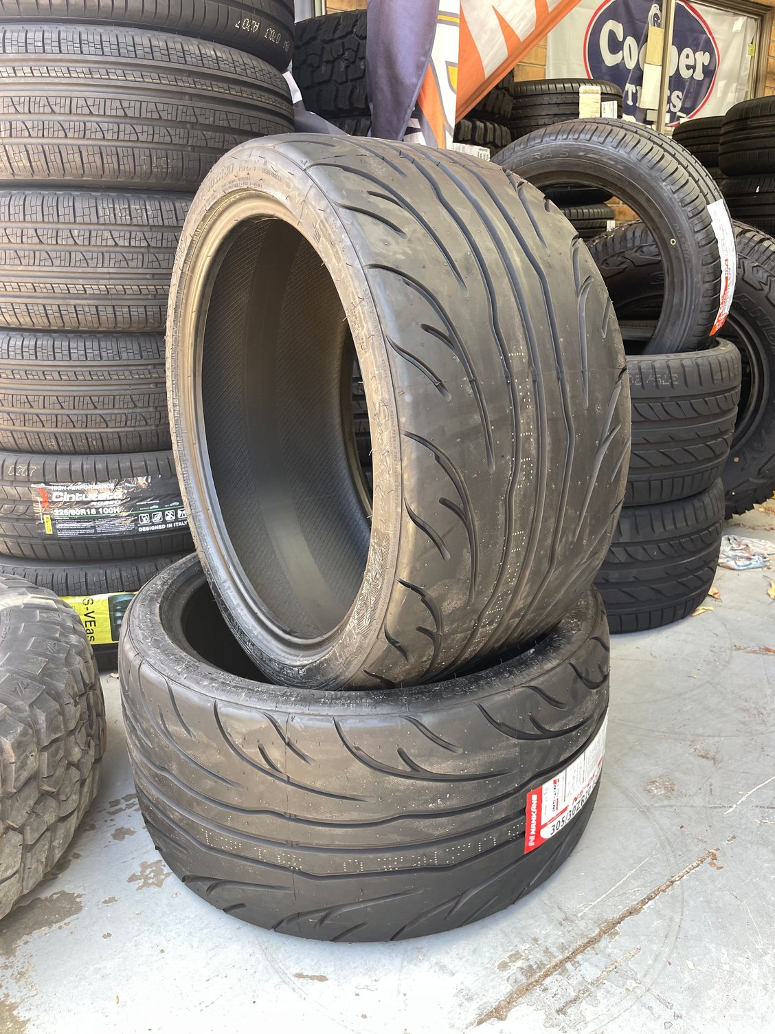

Originally Posted by deanoo
Nankang make a CR-S semi slick which i am thinking of maybe trying just cant get my hands on any stock at the moment
I tried the Toyo R888R in 285/30/20 which is the stock size for a coupe, they grip when warm but they are noisy sounds like a whining diff
Are you running spacers on your car with the 305 size tyre? i was thinking of going with a 295 or 305 depending how close it will get to my guards since im running spacers
I’m not running spacers. The Nankang NS-2R were very noisy as well. Like the bearings were badly worn. It was unbearable to be honest.
for reference, the Michelins were slightly closer to the guards at 305/30R20 than the Continental and the Nankang. I feel I could go to 315 with the Continental, 325 with a 19 inch rim even. So could get possibly get away with a 10mm spacer at 305. But possibly not with the Michelin tyre. So just check the actual tire width and height specifications for the one you want to buy. They do vary slightly between manufacturers even though they state the same ratios.
I wanted to by the AR-1 or CRS, but the Nankang rep told me the NS-2R is better than those for straight line grip, and the other two are better in track. I figured he wouldn’t be fooling me because the AR-1 and CRS tyres were more expensive. The only issue was that they were never hot enough when I needed them, and normal road driving just couldn’t get the require heat into them to make them grip.
Thats pretty much how the R888R's sound
When i spoke to the Nankang rep he told me the CRS semi slicks are better, might be personal choice i guess unless you try then yourself
I might need to work out the size of the tyres with the spacers included, i currently have michelin cup 2 on the rear and they are useless
