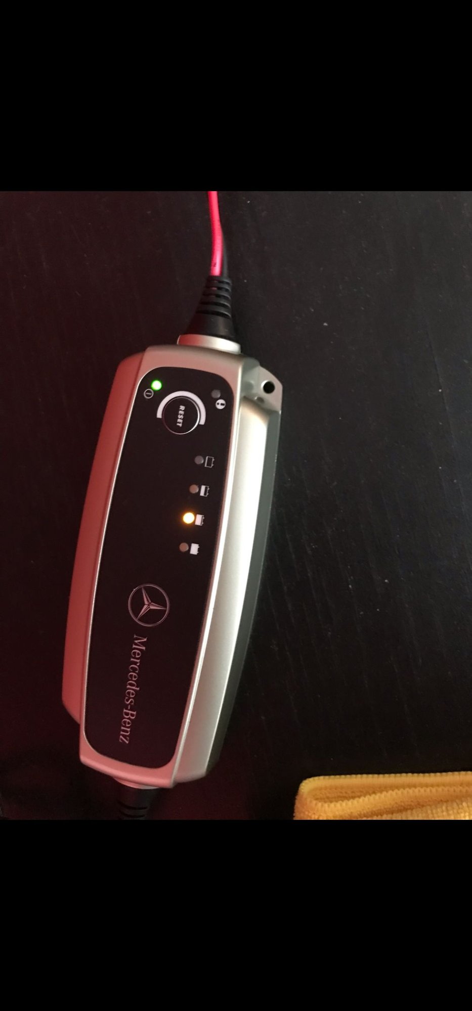

@superswiss
I put the c63 on the MB trickle charger around 7pm last night. I know for a fact the battery had to be low, as we had the car doors/trunk open and we were going in and out all afternoon on Saturday and had it in accessory a fair amount of time. I didn't drive it long enough to warrant a recharge. When I plugged it in last night it was at the lowest level, and 15 minutes ago on my app it is still showing partially charged (pic below).
​​​​​​My wife checked on the charger itself a few minutes ago and it was showing fully charged. She adjusted the clamps and as soon as she did, it went down to this level:
1. Is this normal to drop to that level by just removing and re-adjusting the clamps?
2. Why would my app still say "partially charged"? Could there be a delay in the app??
Thanks

@superswiss
Thanks
From my experience, the app doesn't update the battery level in real time. It updates it when you close the hood or open/close a door. I've noticed this, too, when I hook mine up to a trickle charger periodically. The charger would say full, but the app still says partially charged. Then I disconnect the clamps and shut the hood which wakes up the car and it reports the current status and then the app shows charged. For your charger to show low level after removing the clamps, though, that's somewhat unusual. I would think it might start charging again briefly, but should quickly detect that the battery is full. There have been cases of faulty batteries even on newish cars, so you might wanna do a battery diagnostics to make sure your battery is good.

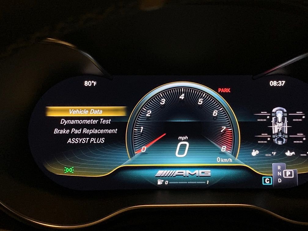

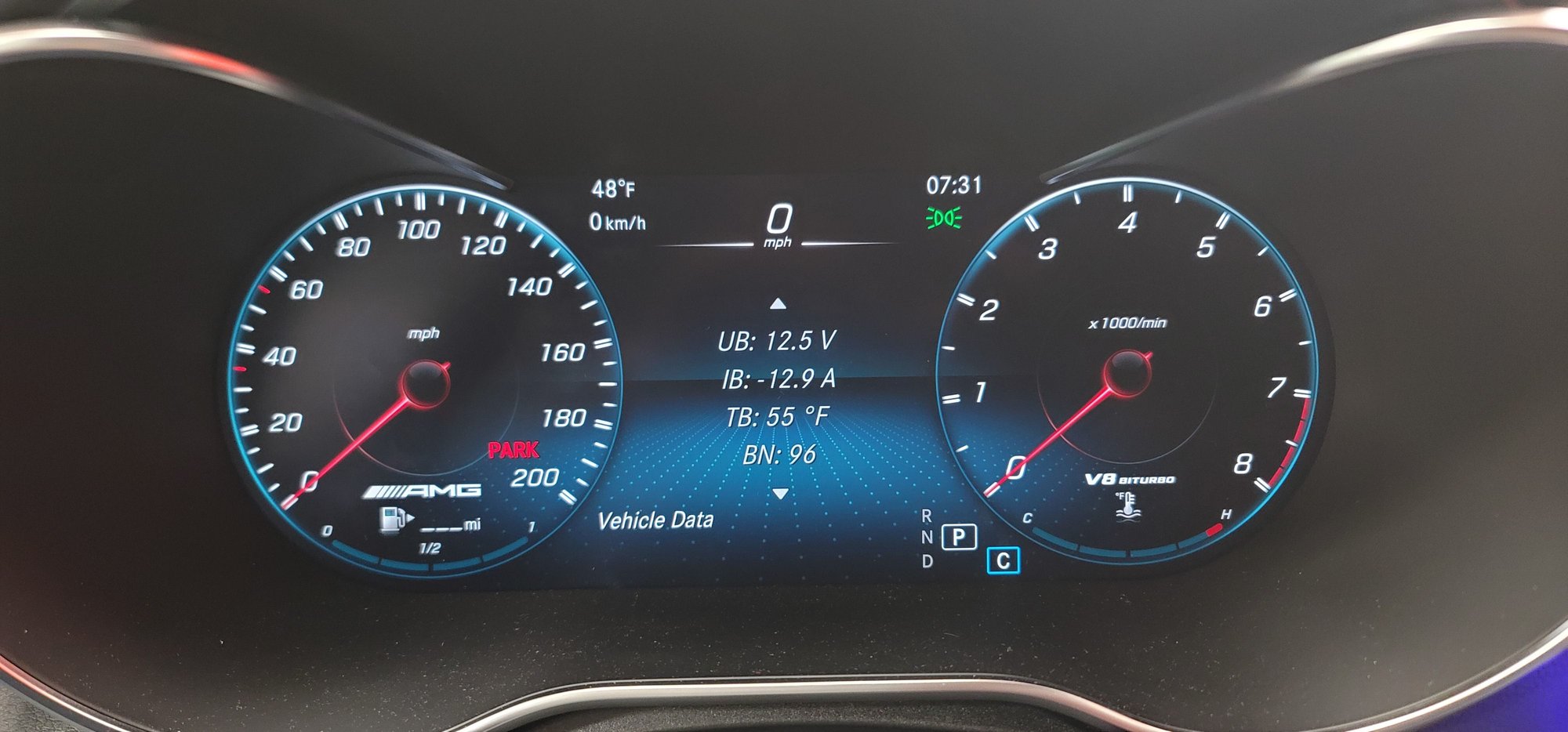

@superswiss
I checked on the charger when I got home and it was 100% charged. I opened my door, closed it. Refreshed the app and bam! Fully charged!
Also, I turned on accessory and my dash cams turned on! You were right, it sounds like MB cuts off certain things when the battery is too low. Like I said earlier, my dad and I had the doors open and trunk/hood open for 4-5 hours on Saturday and never drove it enough to charge it up.
I also went into the workshop mode. My battery is drawing 13 when in accessory mode. That is normal right,?

Originally Posted by cjqamg
@superswiss
You are a great resource for this forum and a wealth of knowledge. Thanks a lot for helping me out!
Chris
Excellent! Glad you got it sorted out. I'm going out on a limb and say the battery draw is normal. Mine is a little higher as shown, and the actual difference is likely due to different equipment and perhaps updated hardware.
