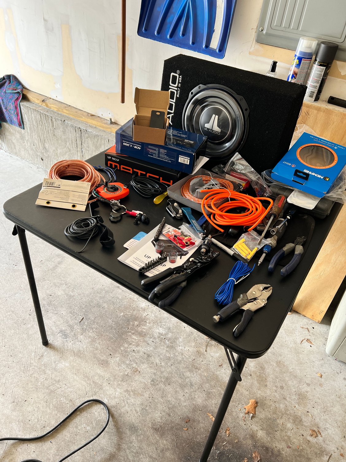

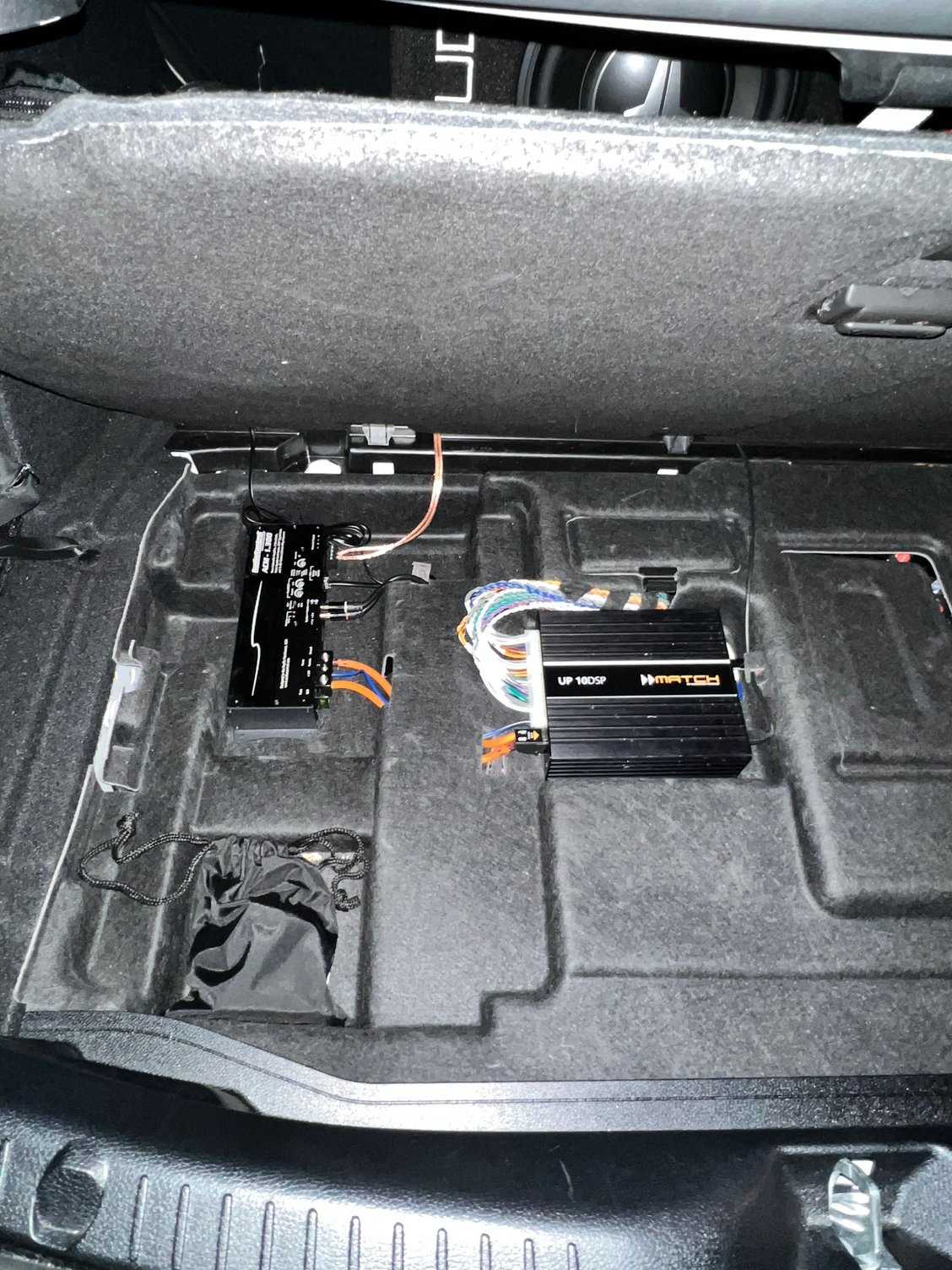

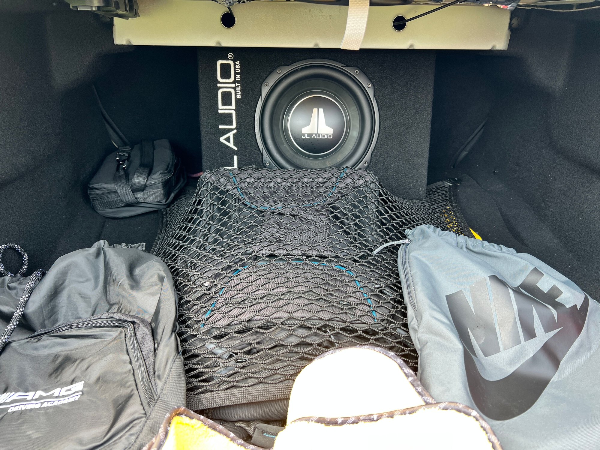

I did an upgrade over the winter including plug & play Focal center, front component and front subs powered by an Audiotec Fischer Match UP 10 DSP/Amp. I had a 10 inch JL Audio TW3 PowerWedge from a previous vehicle and installed in the center against the rear seats powered by an Audio Control ACM 1.300 amp. The sub box adds that low end that I couldn’t get from the OEM or even the upgraded Focal plug & play subs…as was stated above, the footwell location just isn’t conducive to good, low frequencies, but does add a nice overall punch if used as a mid-base.
I’ve attached a few pics and happy to help if you’d like more info!!!
