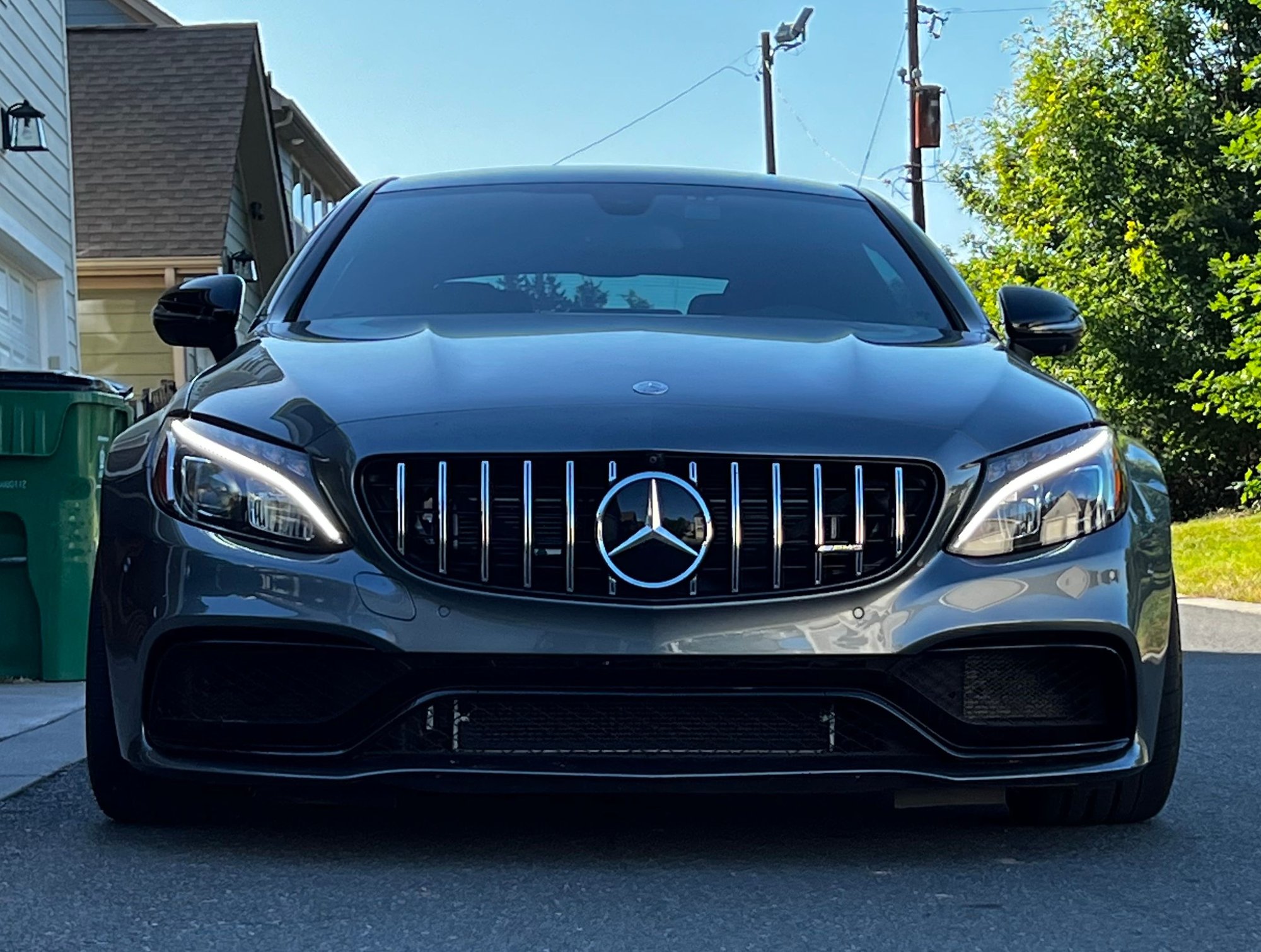

Nice review! I was debating on going with Modalworks after a recent puncture to my passenger side OEM radiator from a rock on the highway but ended up with CSF's 3 piece kit. I'm now interested in adding MW's new divorced transmission cooler!
I did CSF via FCPEuro for 3 main reasons:
1. They have removable rock guards for all 3 coolers (I have a ton of construction around me, so a puncture could happen at any second)
2. FCP euro has liftetime warranty, so if I have another puncture scenario, I can get a free replacement.
3. CSF has been around for a long time and while they don't have great data backing the w205 C63 specific application, they've had great reviews & results on many other platforms for years.
Looking at the stock radiators compared to CSF (and I'm sure Modalworks too), they are TINY and extremely thin. I would think any upgrade (maybe other than Chinese garbage) would be beneficial.
@Jimmy_c63s - what are the ambient air temps during the time you captured your oil & trans temps? Was it warm outside?
@Bosnianc63 - how are you enjoying the Modalworks intakes on the PTG1000s? I am running a very similar set-up to you but on stock intakes. Do they MW intakes providing any additional cooling benefits?
I would definitely upgrade intakes ive done 60-130 runs and with the modal works my times have been 0.3 0.4 sec faster compared with the oem air boxes

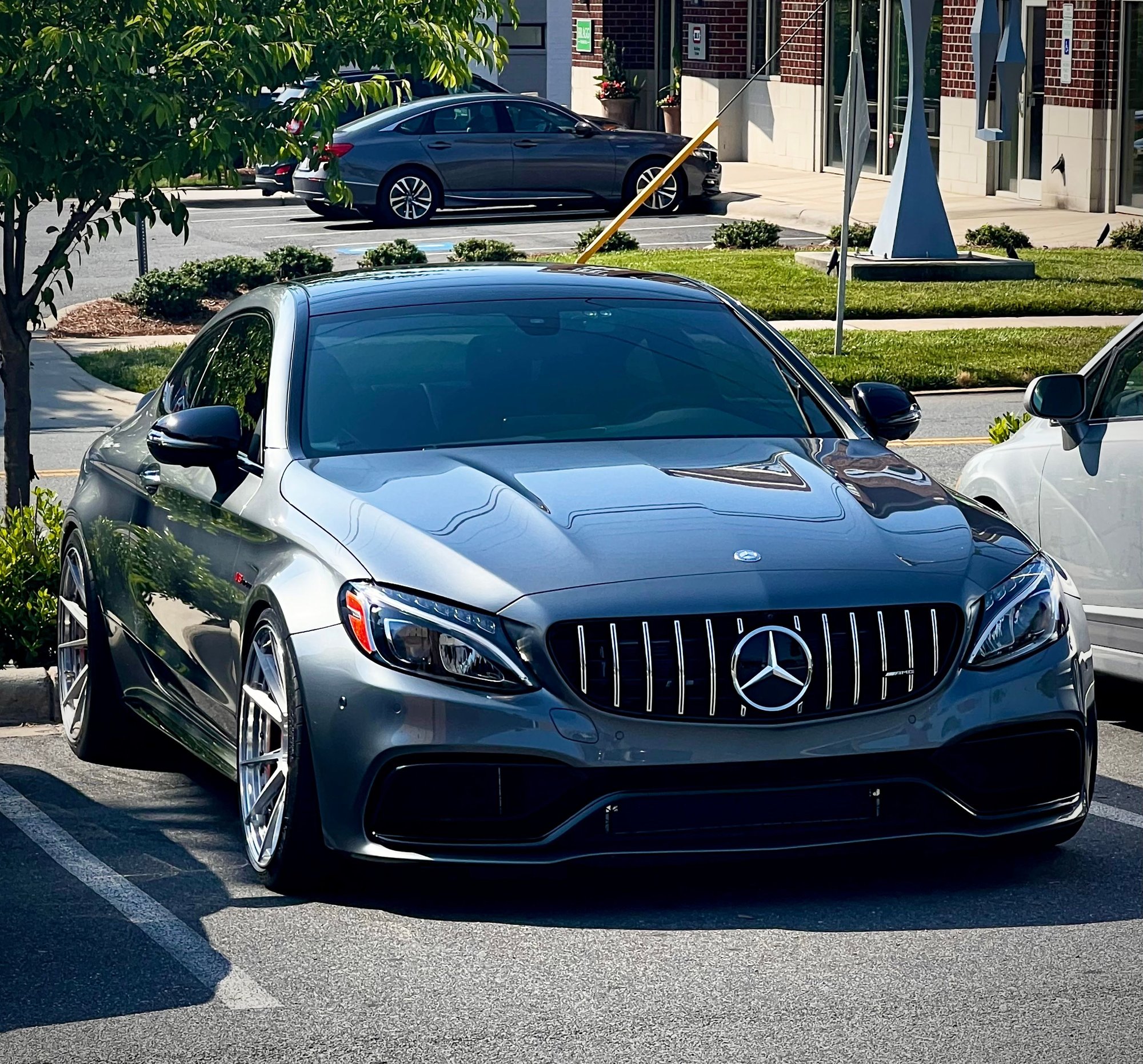

Getting the thread back on topic...... saw this photo on social media which shows them fitted to a pfl wow

Additional photos
Originally Posted by Spazdoc
Can you provide some more pics from the front? I am not sold on the look. Yet.
Originally Posted by ModalWorks
Thanks for the detailed write-up. We love to see customers back up our testing!
Here's some pics I took this afternoon for you towards the sunlight.

*****Unless someone is getting run over by your car, or is looking very carefully, the modification looks pretty discrete. Some of the intercooler/radiator upgrade options on other platforms are *very* noticeable even from far away. Car looks really nice!
Old Jun 1, 2022 | 02:21 PM
George_1992's Avatar
Joined: Jan 2020
Posts: 542
Likes: 228
From: Sydney
C63 S Coupe
You're not wrong there bud they don't stick out in those pics...... so especially for facelifts with all the extra grille bits the radiator logos are discreet

Saw this post on account IG..... looks boss
View this post on Instagram
