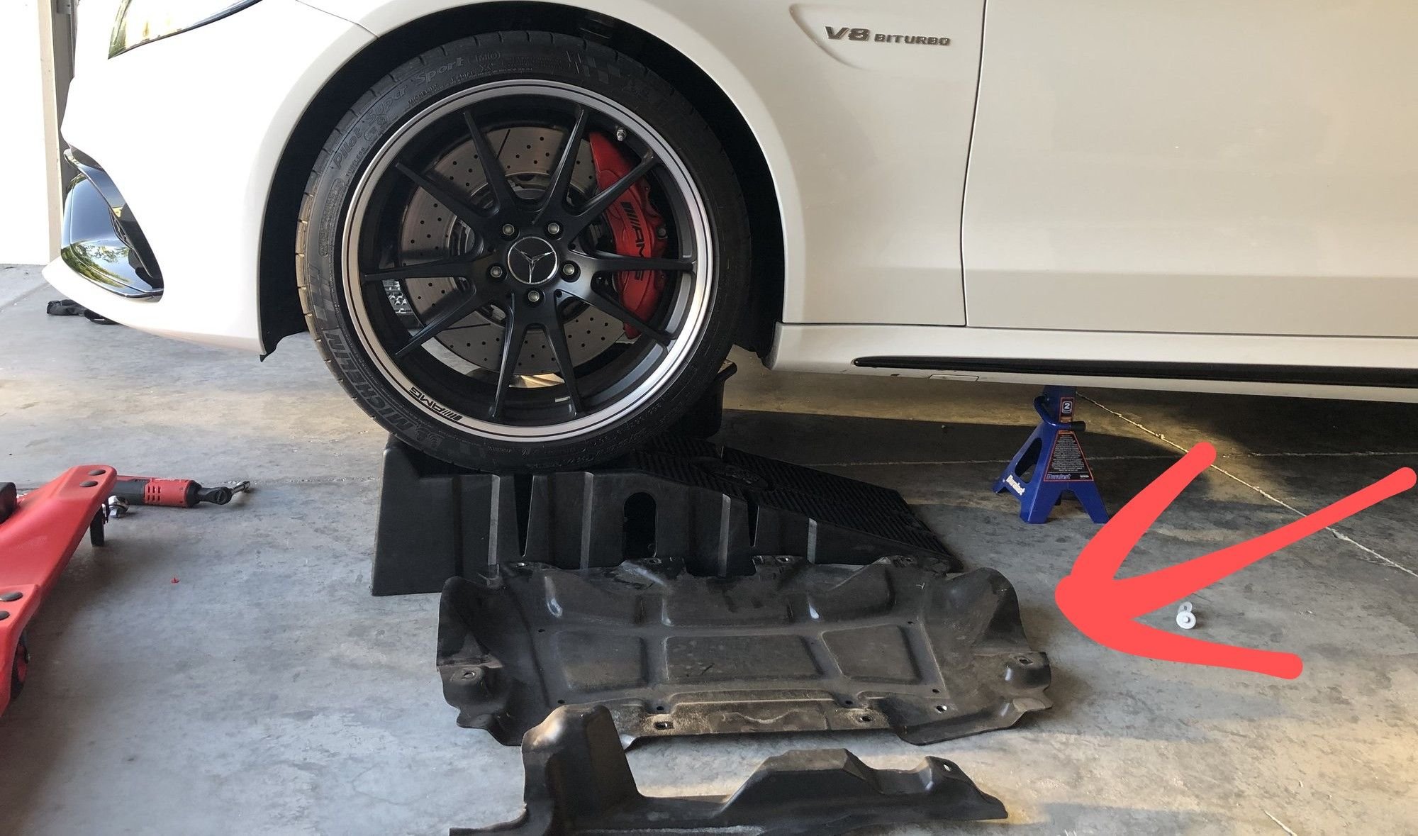

Got a dumb question cuz I have this too.. are you able to access the belts from under the car with the tray off?

Yes just jack the front up and remove the front plastic undertray.You then also remove the flat metal undertray too and it's all there.
