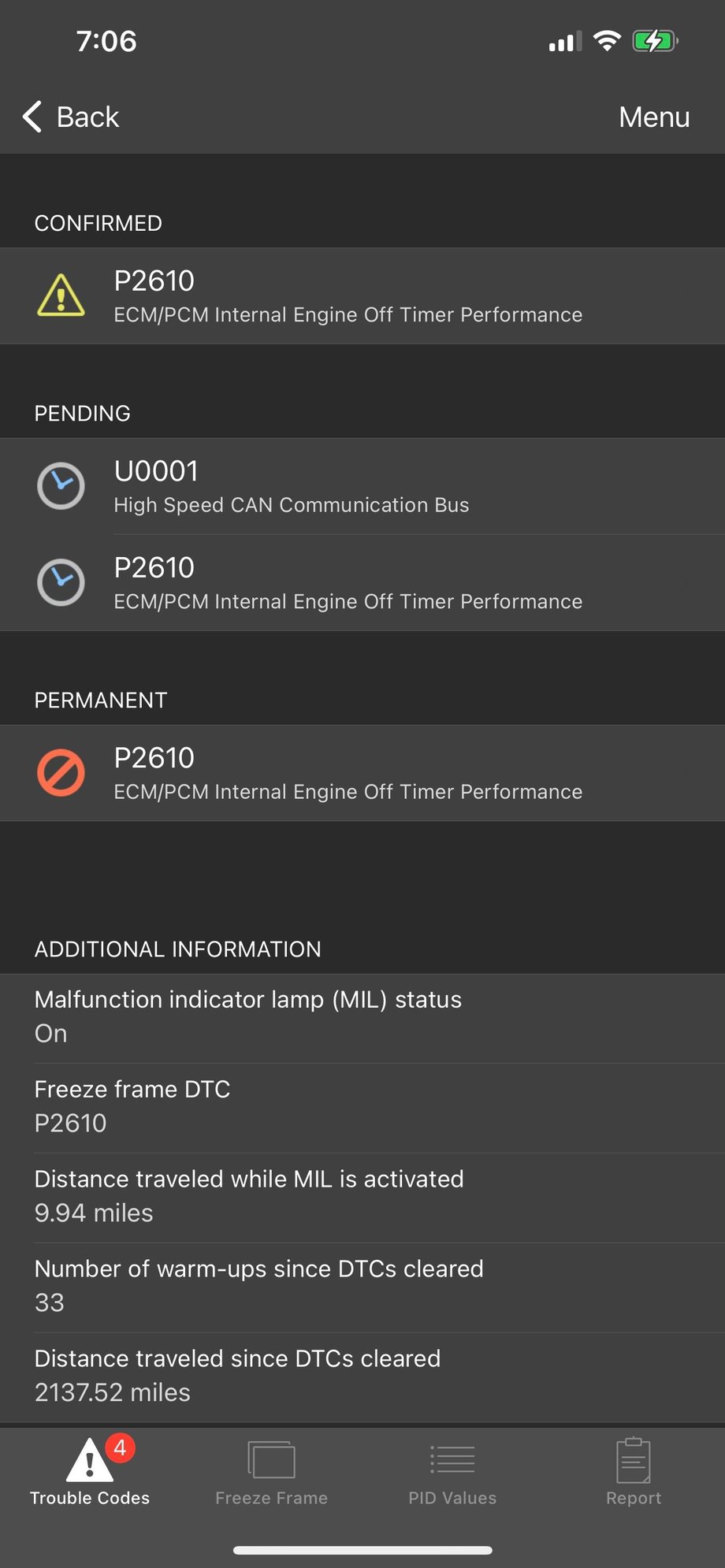

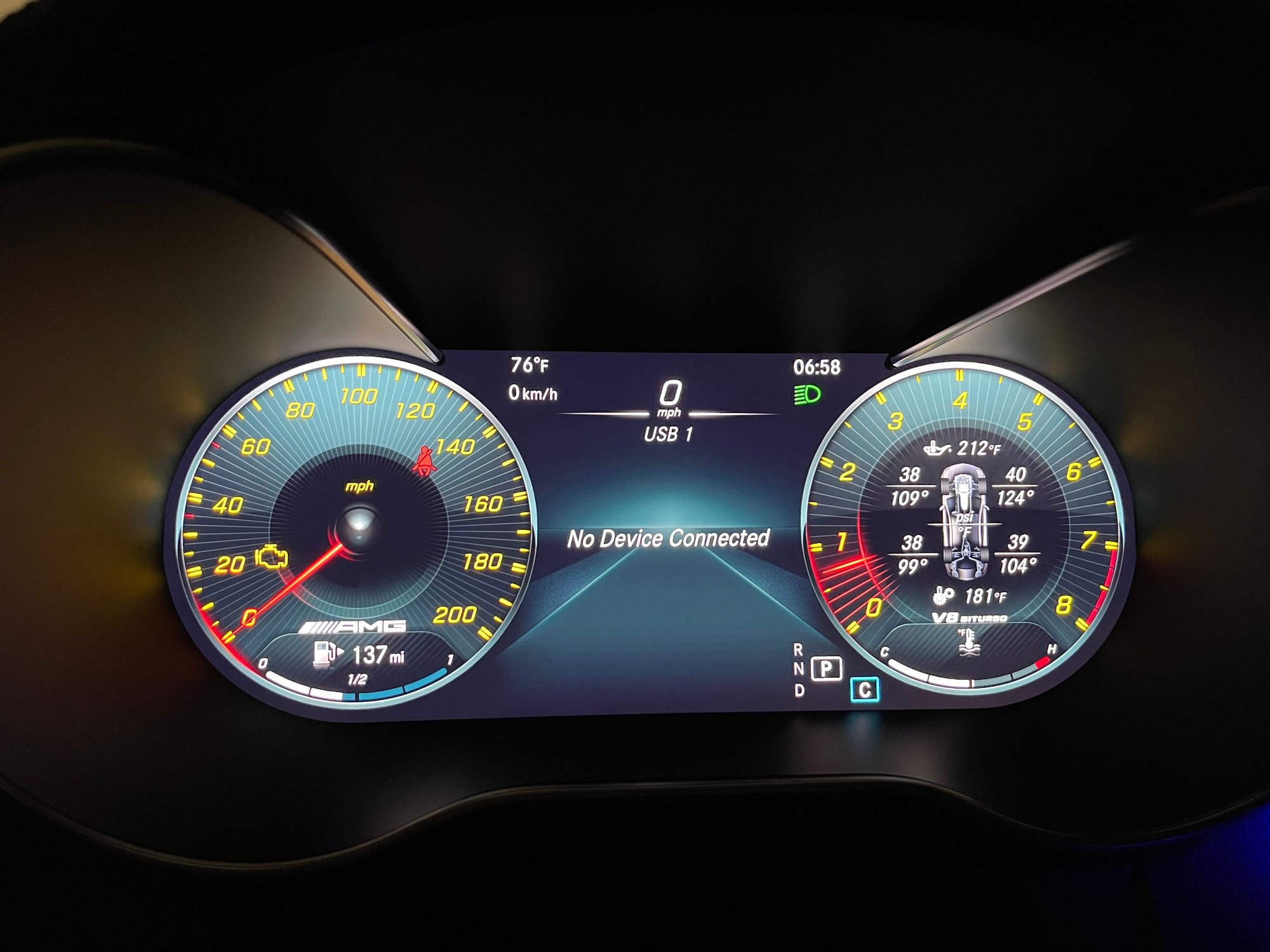

3/18/22- Sunday - Afternoon drive less than 15 miles
[Sport mode]
1. Engine was in 5th gear then it showed D on the heads up display before making a hard thump into 6th gear.
2. Seconds later “checking Engine light “
Limp mode
ERROR CODE - P2610 / U0001
Zero performance - 50 mph
3. Came home
Ran test with scanner ODB1

P2610 is usually related to auxiliary battery. When's the last time you drove your car?

Yeah, you have some electrical problem probably. That code means your system can no longer tell how long your engine was off and it turns off a bunch of internal tests and would also fail emissions in this state. Could be a faulty module or simply low voltage from lack of being driven as mentioned above. The link below lists a number of potential causes for it. Probably should drive it more often, or hook it up to a trickle charger. You can also use the standby mode as documented in the owners manual to preserve the battery, otherwise the online services keep draining the battery while the car is parked. It takes quite a bit of driving to recharge the battery. I also drive a lot less these days, mostly on weekends as well and my battery says mostly partially charged these days in the app, and even after a weekend of driving it still says partially charged. Waiting for my new front tires before going out on another 200+ mile canyon run now that the rainy season is mostly over. Those runs will recharge the batteries fully and give the car a good workout.
