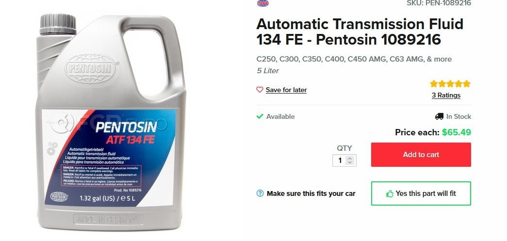

*****I've never heard of green transmission fluid. What year is the car? I used blue fluid in my 2018 C63s. Pic below of the type I used. Did you follow proper procedure in changing out the fluid and refilling it using a pump from the bottom, with the motor running? Did you install the overflow plug properly? Did you use the correct filter and not the old style filter which could cause cavitation from not sitting in the pan at the same height as the correct filter? If not, the level will be way off and cause flaring and slippage. Fluid needs to be at like 113 degrees Fahrenheit with the car running before putting the drain plug back in..
If the car doesn't drive or shift properly after the trans fluid change, you have a problem that *needs* to be fixed so you don't damage the system.
Take a pic of the old fluid if you still have some. The old fluid on my car came out... blue, just like what I put back in it.
Good luck and hope it works out.
